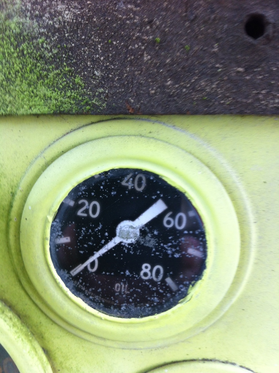

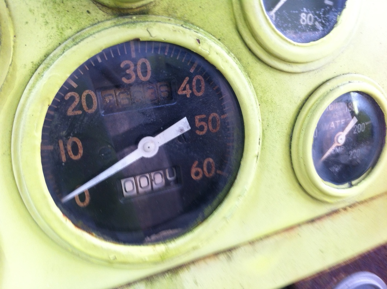

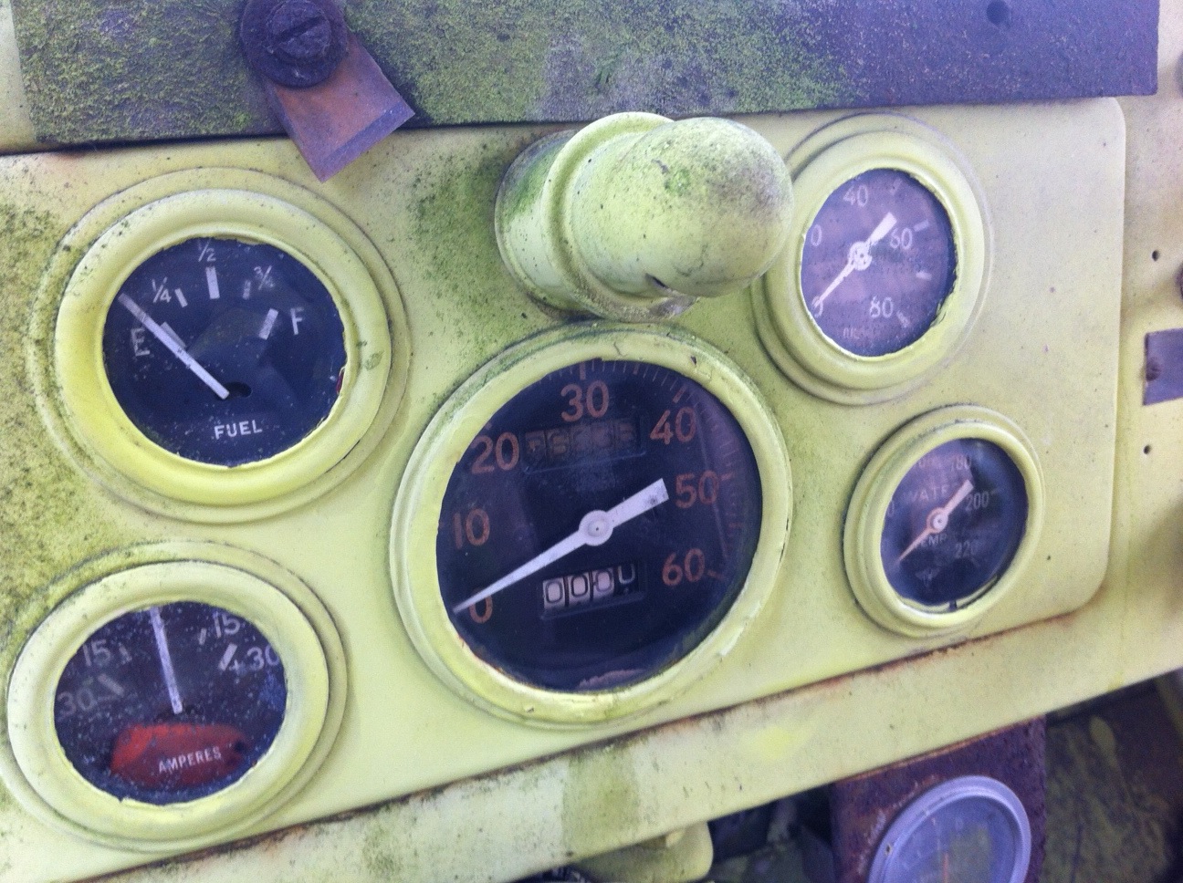

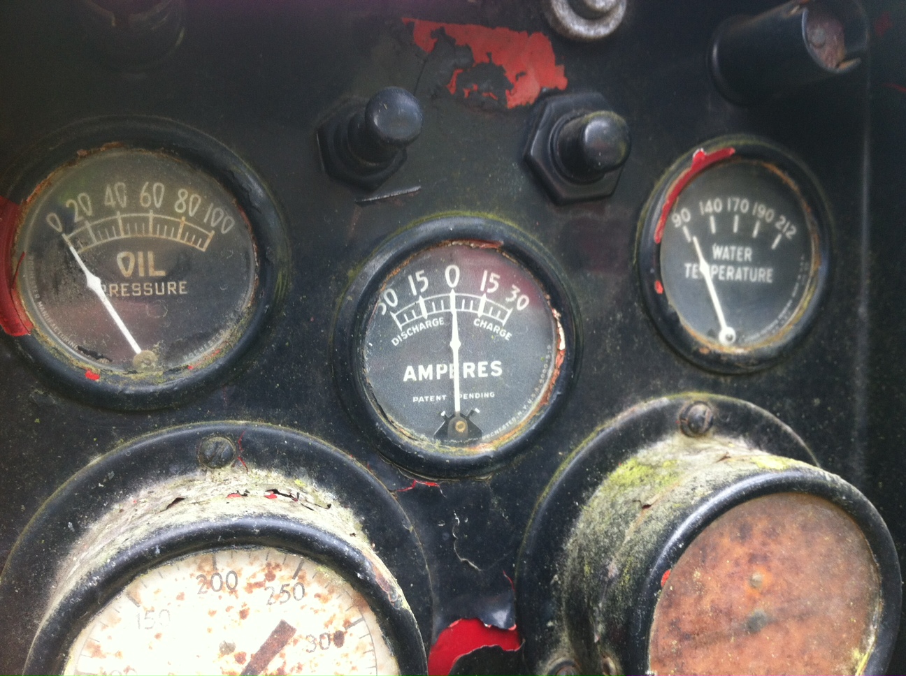

  8. So I've been poking around for gauges the past week and found these on an old firetruck in a field. Sorry the photos are bad, my feet where SOAKED after getting in there.
    The yellow panel has mostly old SW pieces as they have the Stewart Warner name and part numbers screened on the face under the bezel, the only one I could not see any marking on was the speedometer but it was quite dirty.
    I did see the TEMP gauge is a "wings" unit and has a curved lens with a different bezel than the non wings pieces.
    Can anyone provide insight on these instruments as far as age and if I should make a deal on them?
  9. I like the Rochester Manufacturing Instruments on the water pump engine also.
  10. falcongeorge
    Joined: Aug 26, 2010
    Posts: 18,339
    falcongeorge
    from BC
    I kinda like those too. Wonder what other gauges they made? smooth bezels and distinctive lettering, those are cool. Wonder if the bezels are chrome or brass under the paint?

    Rochester Mfg. Co. moved from New York to Dallas in the late 50's, so look for the NY address on the gauge face. Tons of Rochester gauges were used on tractors & industrial applications. Allis tractors used them beginning in at least 1948.
    OP, those are early GPW "paint can" gauges, possibly made by SW, King Seeley, or Waltham used on military Jeeps til March of '42. Speedo is referred to as a "long needle", used until early 1943. The wings temp gauge is later, but still, I'd jump all over those!

    I assume that the SW wing temp gauge is mechanical? Is the capillary tube all there or did someone cut it?
    If it's been cut it would have to be replaced and it's expensive!

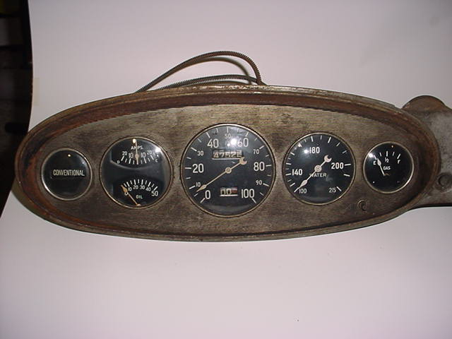

    this is they type of stuff you want to find

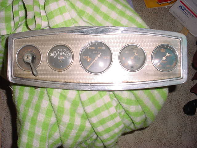

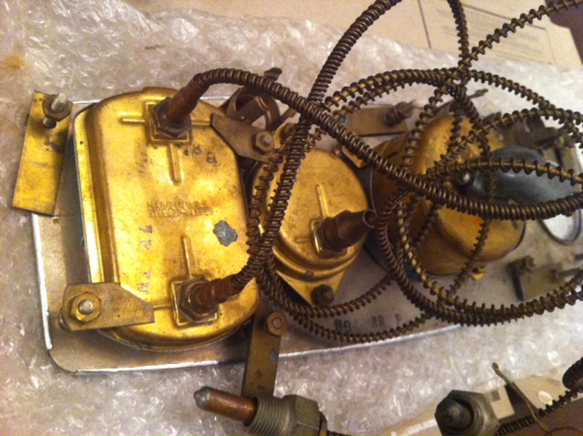

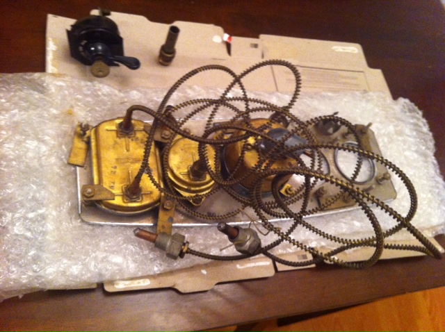

  23. So I picked up what I'd call by my standard a very nice dash for my A bone, it is reputed to be N.O.S and shows no signs otherwise. I picked it up this weekend and when I removed it from the box I was immediately in awe as I hoped I would be.
    Now I have several questions.
    How sensitive are the capillary tubes to handling, I am concerned to handle this piece to much?
    Is it acceptable to test the temp gauges by immersing the sensor bud and heating it in hot water?
    I really want to use a fuel gauge and accept they are rare and coveted. Can the correct fuel gauge be used utilized with 12V and a modern type sending unit? I do have what I would believe to be a "standard" fuel sending opening in my modified "TANKS fuel tank
    Would you use the Clum switch? I really like it and it would solve adding an ignition and headlight switches to the dash.
    Thank You...

    I was told by Pat Swanson to handle them as little as possible. I don't move mine very often, find a shelf and stick it there till you're ready to install it.
    Perfectly acceptable to dip the capillary tube in hot water. I'd be more concerned if you were to use a lighter or small butane torch. That method if your not careful can melt the solder of the end of the sensor.
    Gas gauges can be found, if you were willing to step up to this nice of a dash panel you probably can afford a gas gauge. I found a nice one in the hamb classifieds for $150 about eight months ago. As far as a 12V system goes, you can always use a voltage drop and there are multiple threads on the hamb on how to hook a vintage SW gas gauge.
    The key switch screams vintage chris craft boat but thats just me. Then again its entirely possible that an ambitious hot rodder could get his hands on a boat dash in the era. If you were to run it you could skip buying a gas gauge and just find an amp gauge.
    I hope you're running a flathead, that dual temp gauge would be perfect to run for each head. That was a hot set up back in the day to monitor both right and left heads. Anyway, hope that helps. Its one of my favorite dash set ups second only to an auburn panel. JohnnyA
