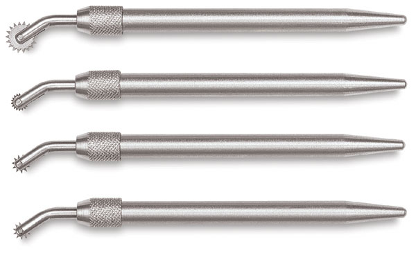

  16. If you don't know what a pounce pattern is, find out on the web, and you can a have pattern that will be exactly the same on each side.
    That is the way old time pros laid out their work. Michaelangelo used them on the Sistine Chapel.
    Below are different size pounce wheels used to make the paper patterns.

    2x on that! This pokes little holes in paper, then take a sock and fill it with chalk dust and tie it off. lay your paper down and pounce the chalk bag over the design then pull it away and you have a feint design to follow. Like hotrod1940 said, they bin do'in it for centuries!

    Pounced patterns are a lot of fun.Draw a pattern,lay it on a piece of corrugated carboard and pounce it,then turn your pattern over and lightly sand it with 300+ grit sanpaper.
    Flip it object side down and dust it.
