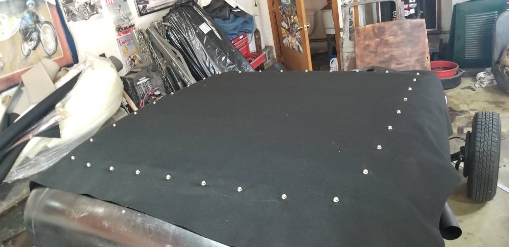

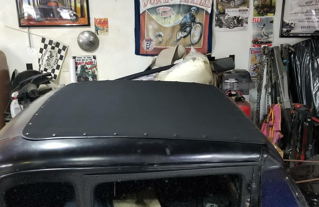

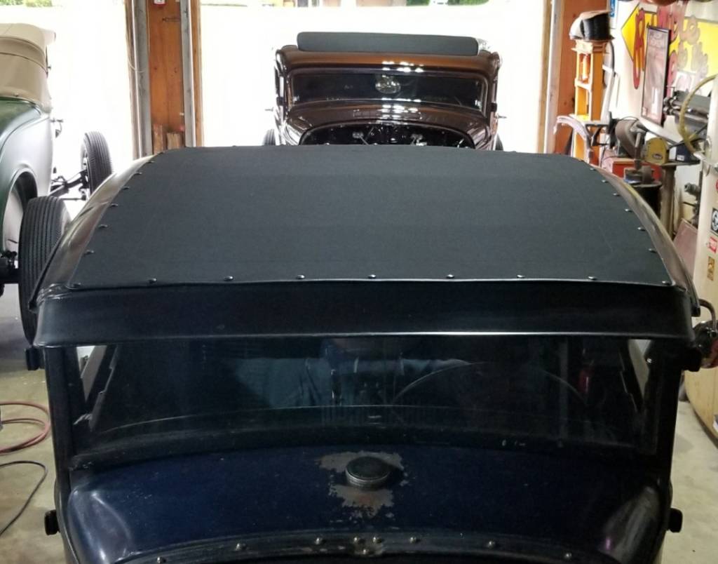

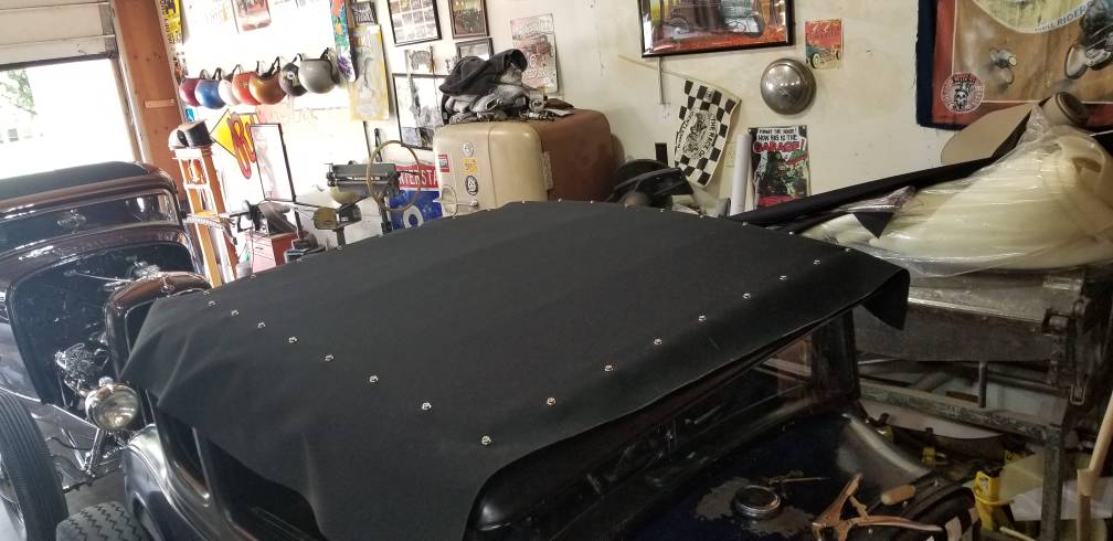

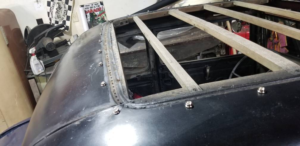

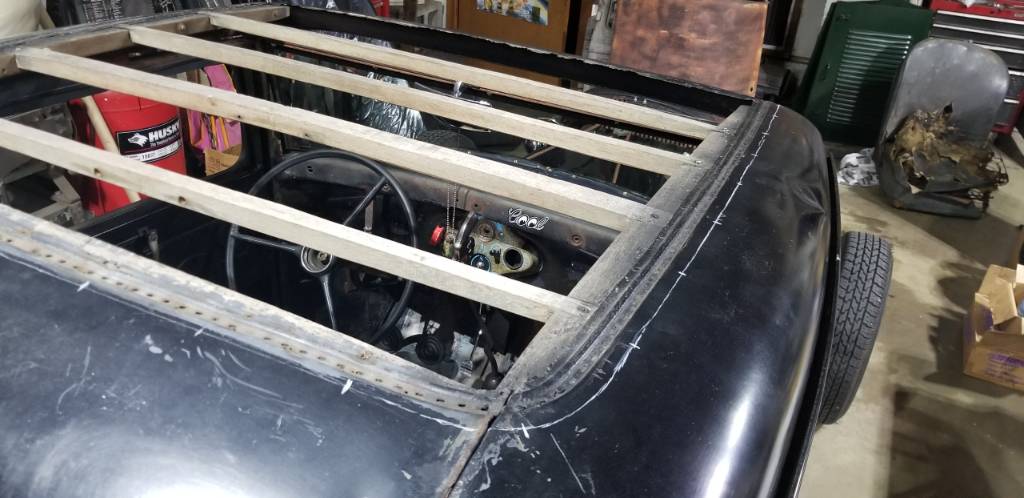

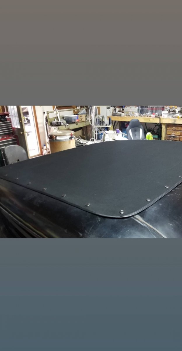

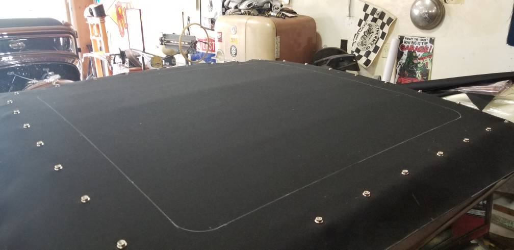

    That came out GREAT! Can I ask how you did this?
    It looks like you laid out the snap pattern and installed it, then stretched the material and held it in place with the make snaps to pattern the holes for the female snaps correctly. I've gotta make one for my AA pickup.

    *VERY* nice roadster top!

    Exactly... Then you pull the skin off and actually sew a back layer underneath all the way around the perimeter where the snaps go. In the one picture you can see the white chalk line where I sew the back layer on underneath. After that back layer is sewn on, the excess material is trimmed off and then the edge binding is sewn on. Lastly the snaps are fastened to the cover

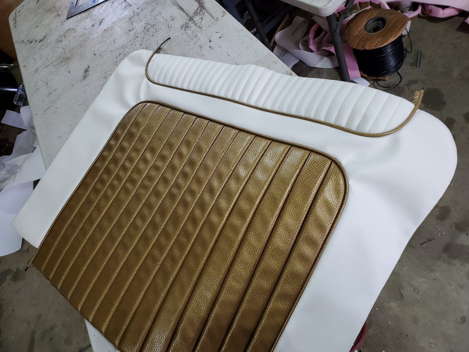

    In progress seat for my buddy Dave
    20221010_154823.jpg 20221011_133726.jpg 20221010_184633.jpg 20221011_133747.jpg 20221011_174954.jpg 20221012_135705.jpg 20221012_144305.jpg 20221012_150154.jpg 20221012_165824.jpg 20221012_170116.jpg 20221014_124515.jpg 20221014_153751.jpg 20221014_160419.jpg
