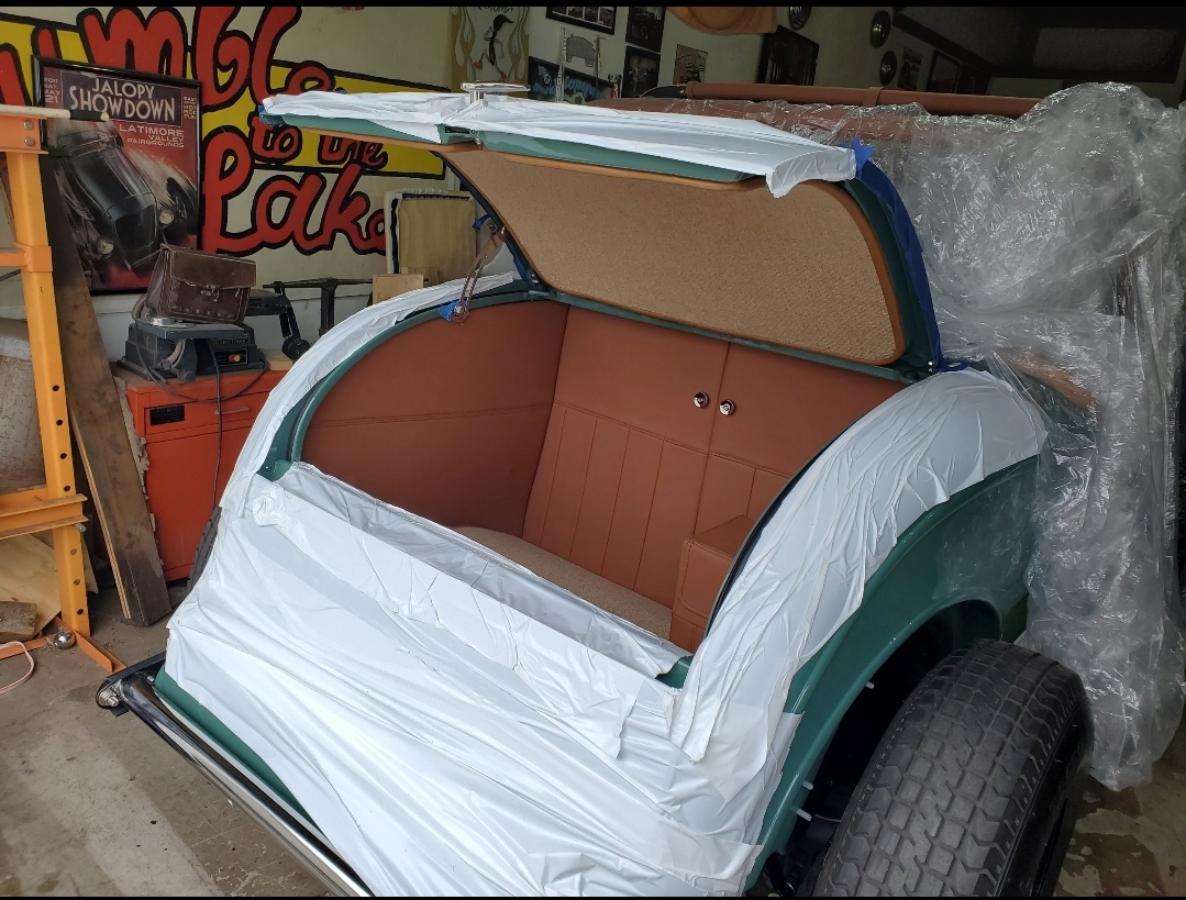

    Working on a friend's 32 Sport coupe. Carpet, decklid panel and top. Just about done the top. Hidem goes on next and back window

    @HomemadeHardtop57 man another great looking job ! Could you tell me where you sourced those little metal endcap/edgebanding clip deals on the sport coupe ? I have one missing from our 29 Special coupe and need a replacement just like those, with the small screw hole.

    Posts: 2,457
    Happydaze
    Very nice. May I enquire as to the nature of the protective tape/film around the trunk opening as I have need of something when carrying out a similar job. Product names and sources? Also, how sticky is it as I've always been told to not be testing the paint adhesion excessively, just in case!

    Online, they call them hidem trim clips. I bought a bunch of them on eBay and believe that there's currently no one making them. You can find them online from time to time. Message me your address and I'll send you one

    Hi Chris
    It's called JK paint protection tape. It comes in various widths on a roll and is easy to apply, and removes just as easily as making tape, and leaves no residue. I use it on everything with nice paint. It's not cheap... but certainly less expensive than repainting something

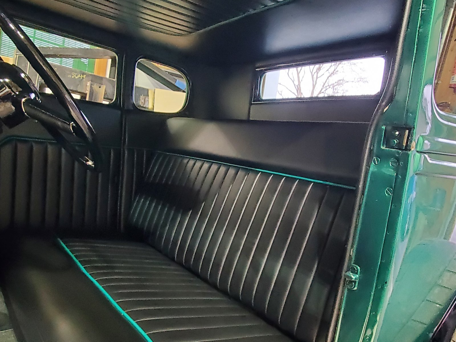

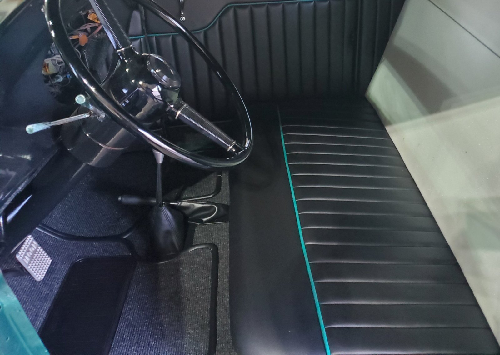

    Model a coupe seat and 69 Ford pickup seats finished recently 20230720_134855.jpg 20230622_170000.jpg
