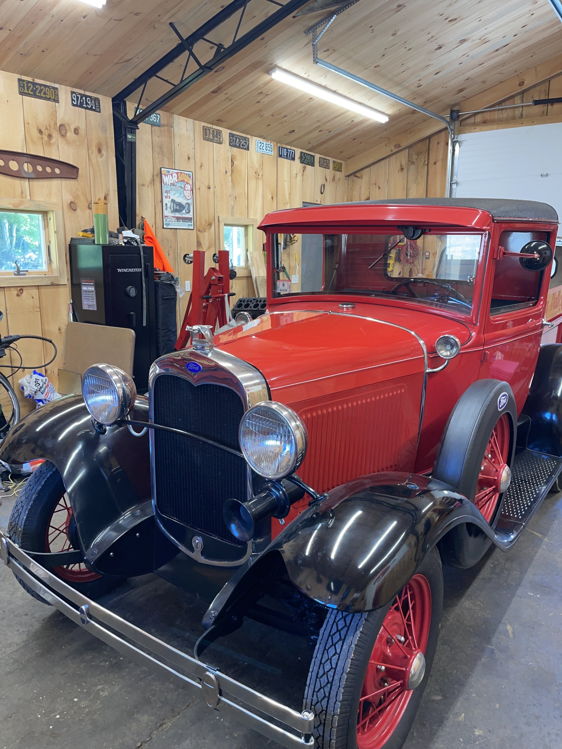

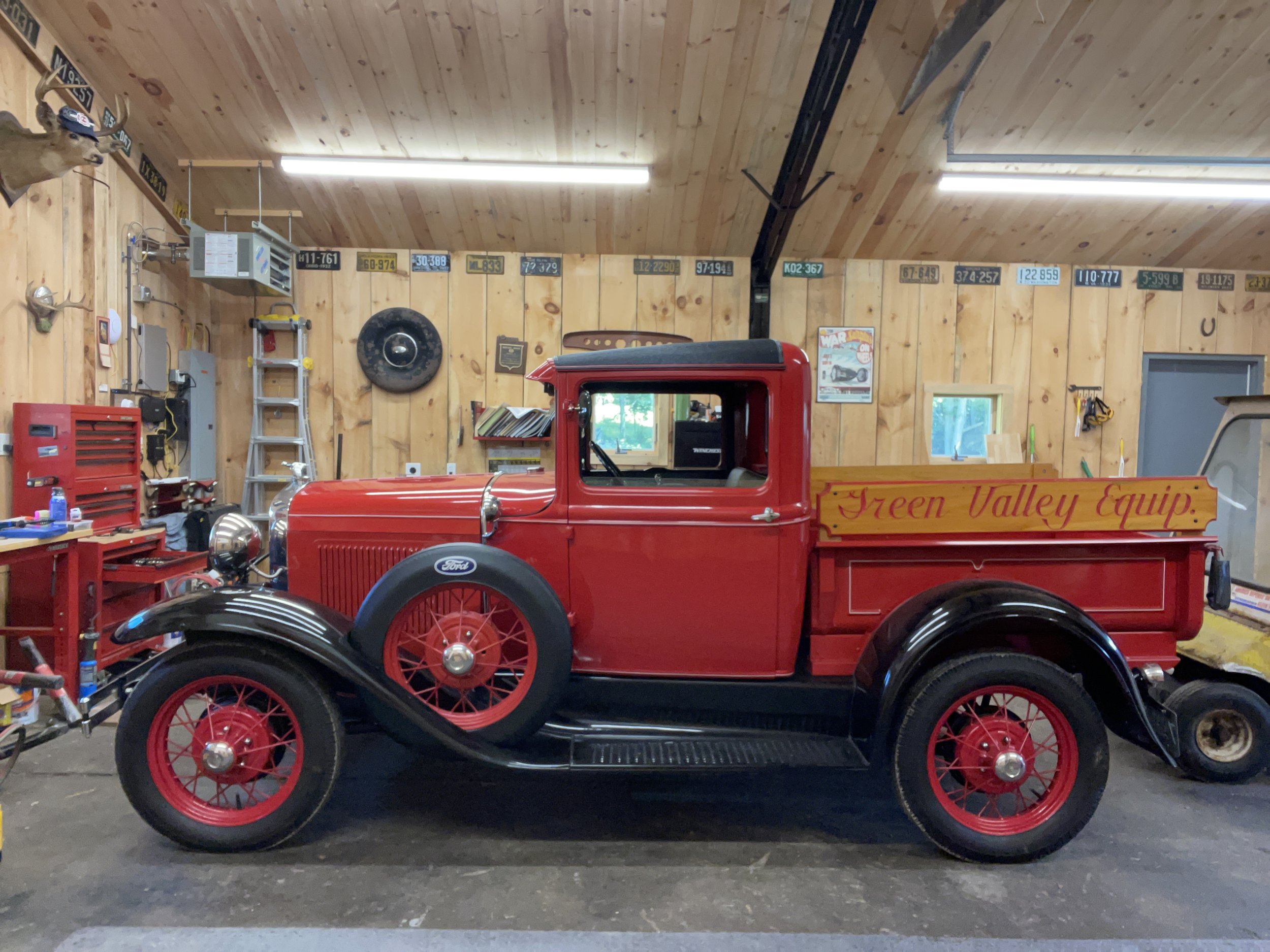

    Ok, this is a dilemma I have. My Dad and my neighbor were partners in a farm equipment dealership. The neighbor was an old cars guy as well. He got me interested in old stuff but I tend towards period hotrods rather than restorations. He build a 31 pickup shop truck out of basically a basket case in the 70's. He was trying to get me to buy it but I already had a 32 5 window banger (recently sold) and an un modified A was not in my plans. He p***ed recently and his wife and daughter shocked me by giving me the pickup for all I did for Don. So I want to honor his legacy, but I need to make it more like something I want to drive. Easy part is 16" wires and big and littles, reverse the front spring eyes. I can beef up the motor or swap a B that I have and need synchronized gears.
    I do not want to touch the body. What can I do with the spare tire section on the front fender? I am not sure I want to widen the well for a bigger tire. Maybe swap it for a plain fender?

    A non welled 30/31 Model A fender will take care of the spare tire.

    when you find that other fender,make a custom well wide enough for your wheel(s)

    A buddy of mine solved that problem by picking up an old used 15" motorcycle tire/wheel for the spare tire well and covered it with a vinyl spare tire cover. The diameter matched the 15" wheels he had on his hot rod and the motorcycle wheel/tire was narrow enough to fit in the fender slot.

    Easy fix. I run 16" wheels and use a stock 40 ford steel wheel as a spare. Tyre is a modern space saver. No body or fender mods whatsoever.
