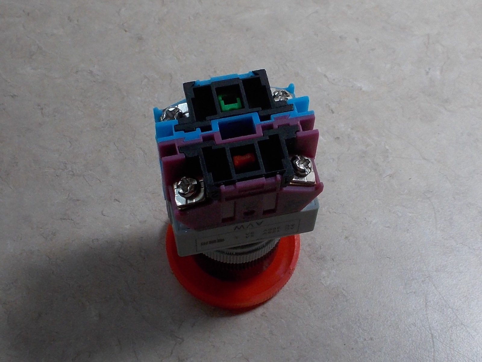

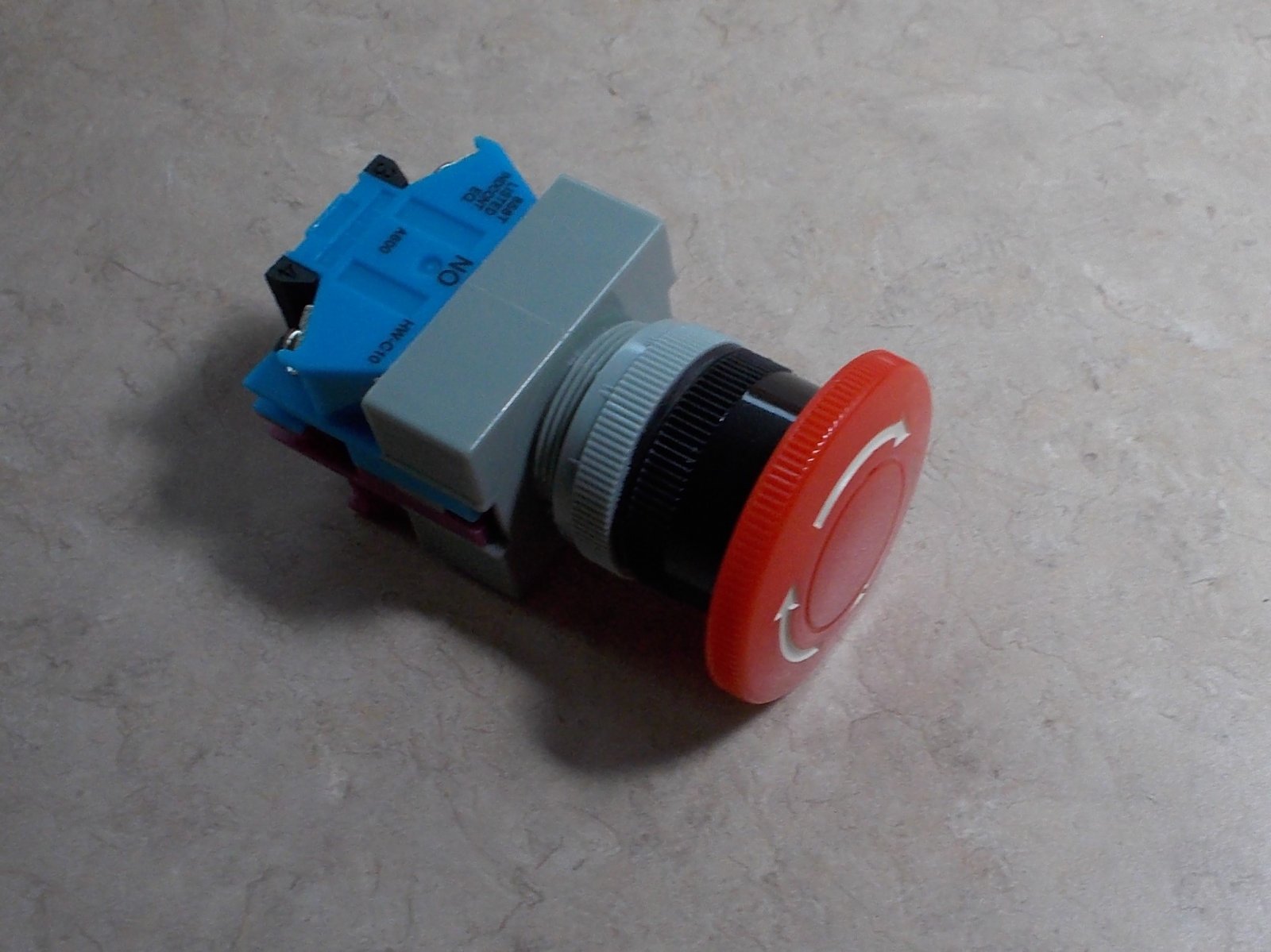

    Another suggestion: Rules call for a master cutoff switch outside of the car, accessible by track personell. Two of my race cars have an additional master cutoff switch inside the car for the driver. I used mine once in an on-track mishap [I won't bore you with the details] that would have resulted in me striking many bystanders without it.
    I am not sure one would have done any good whatsoever on a blower car. But the next morning I ordered two more for my other race cars.
    rod1, mad mikey and chryslerfan55 like this.
  8. Those switches look like the cheap fie units. I have had the ****on fall out of mine a few times on p***es. I use the higher quality one now. It's from good vibrations. Of course it's more money for the better part.

    Inside ****pit,(T/Fc , A/Fc , N/Fc) there is master shut offs for the ignition, and also fuel shut off's,
    In my opinion, the picture shown of your power shut offs are on the cheap side, I would up grade .

    Truth be told, I am using a premium GE #CR104PXF12 switch module and a couple #CR104P contact modules - one NO and one NC - on my three fastest cars. They retail for around ninety bucks a pop so the one I showed was a less expensive one I plan to use on my slowest (11 second) car and it should be adequate for the average HAMB racer with few accessories to control.
