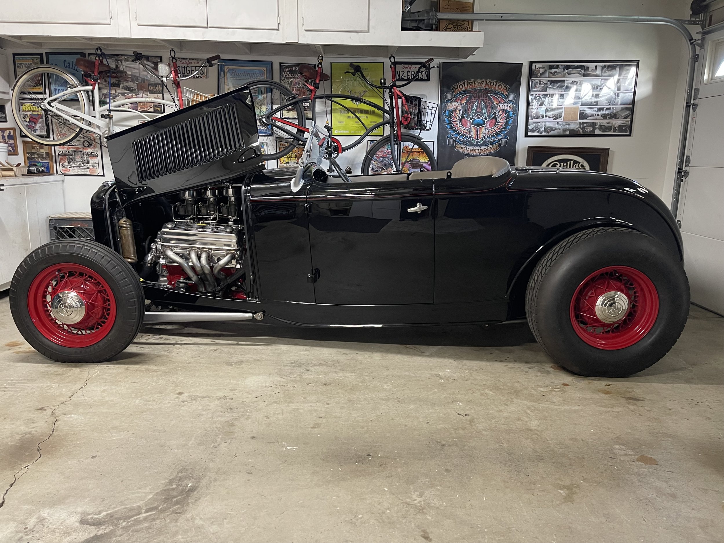

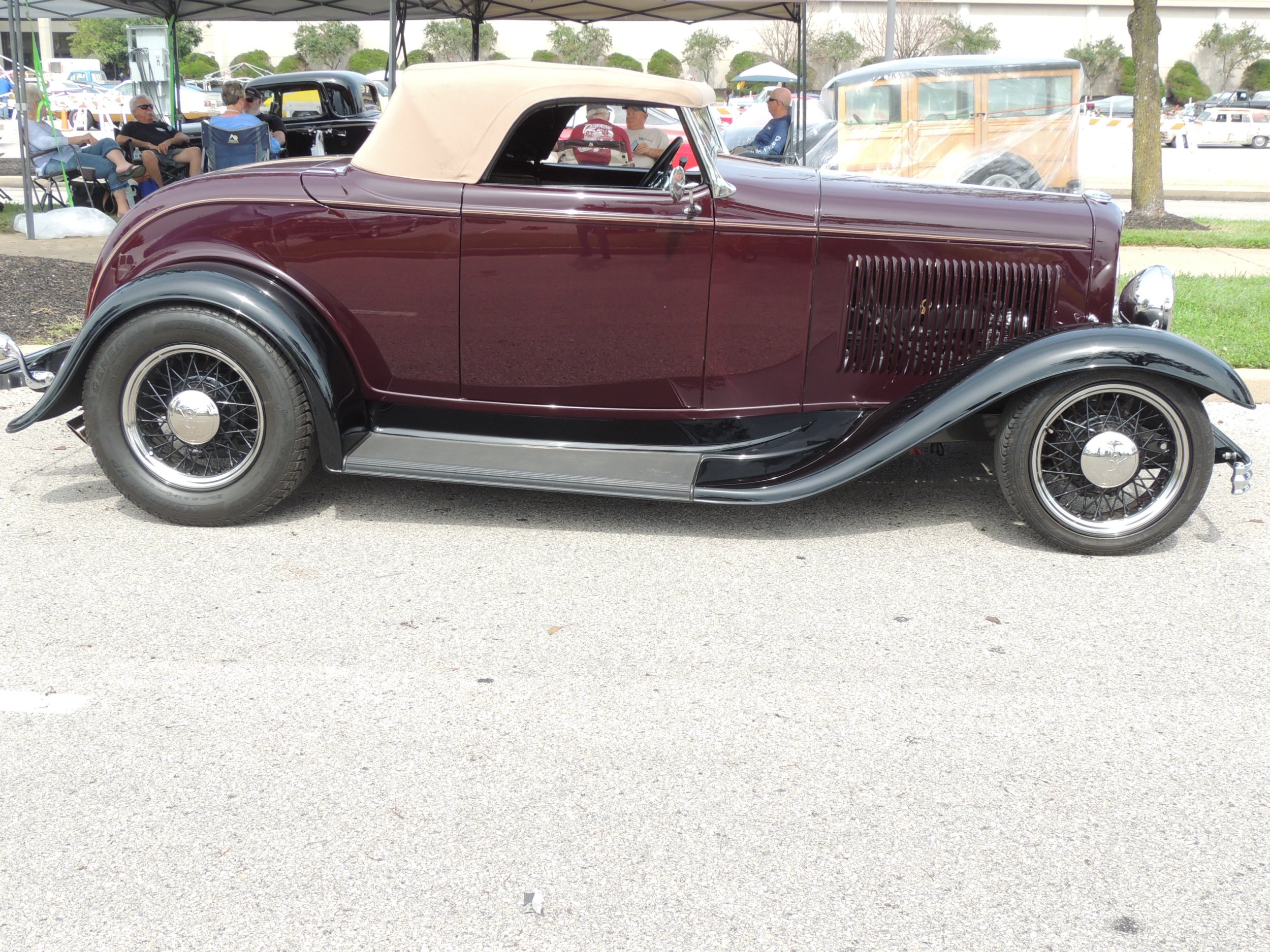

    Here is one that supposedly was extended 4". I think he added length in the cowl to gain some footroom. I don't plan on a hood or side panels. Both of these cars have 25 louvers in the side panels.

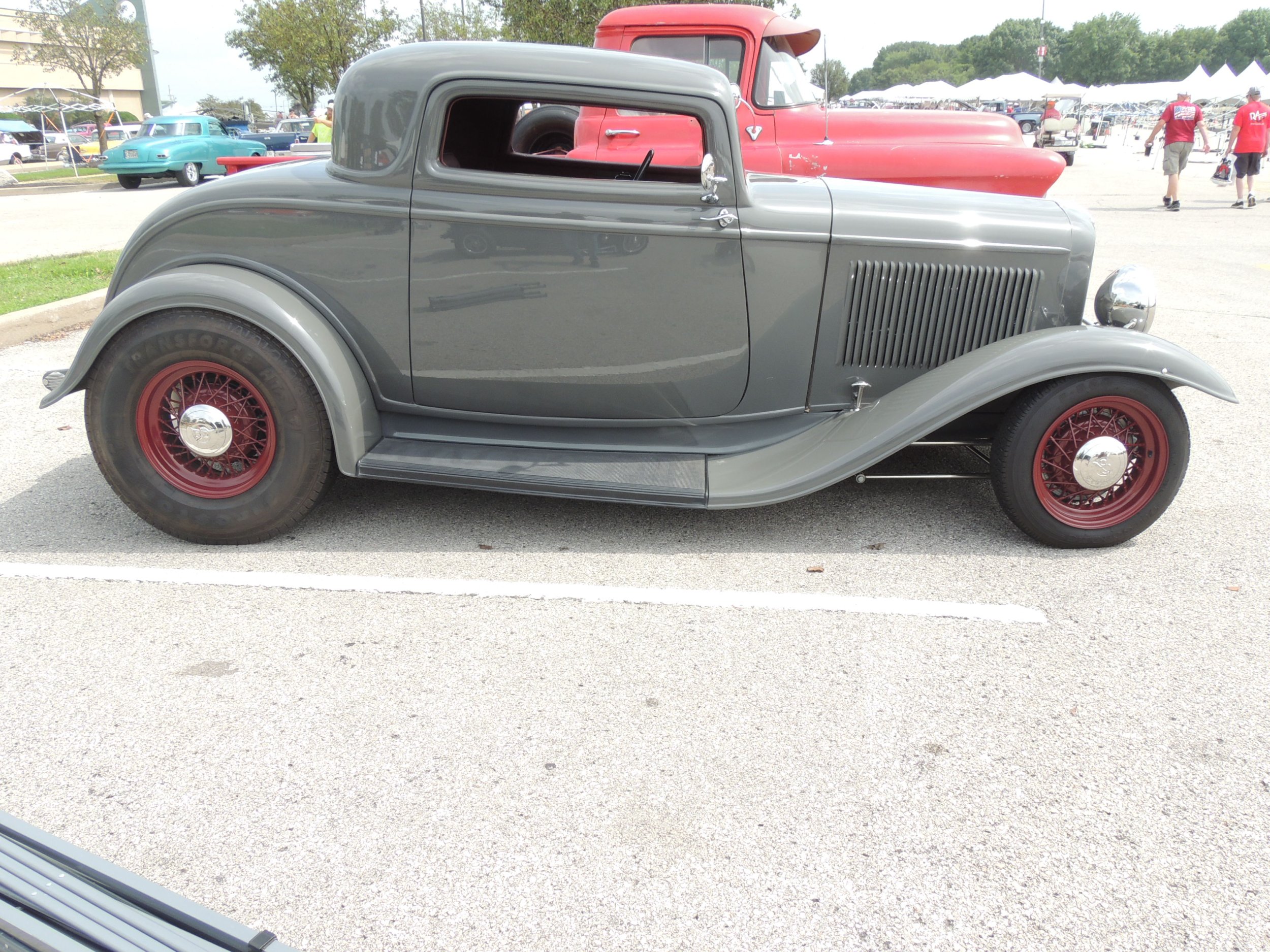

    Here is a stock side view.

    Not to be critical but that "32 Ford" roadster is a Dearborn Deuce, the ad copy says it was lengthened three inches.
    https://spudsgarage.com/vehicles/32FordDearPismo/index.htm
    lothiandon1940 and ekimneirbo like this.

    I'm aware that the doors were made 3" longer, but don't know if they actually lengthened the body to accommodate it. I talked to the owner, but only for a moment and he said it had been lengthened.
    I think he said in order to fit the engine, but maybe I just read something into what he said. It was a year ago when I talked to him, so don't remember the exact reply.
    Here is Page 2 0f the Dearborn Deuce option list, and they show a lengthened hood being available. I didn't see anything mentioning longer running boards to accommodate extending the body. So, right now I'm not sure. I did take some measurements of his hood but haven't found where I put them . I did see on page 1 that it says "Cabin area has been enlarged 2 1/2" (more leg room) AND Hidden hinges attached to a modern stamped door with 3" of stretch (from original 32) for easier entry.
    And one more thing....Says body reverse engineered to work with stock 1932 ch***is and fenders. That would seem to indicate that the normal Dearborn Deuce wasn't lengthened but simply altered within the same parameters. So, at this point I'm not positive but this one looks longer to me. But I been wrong once before.:D

    To my eyes, the roadster and the coupe are entirely different.
    The doors on the coupe are much longer the the doors on the roadster, but the panel behind the door on the coupe is much shorter then the same area on the roadster. The curved front edge of the coupe doors are completely different then the straight cut roadster doors. Those two cars are very poor choices to determine what the car originally looked like.
    I believe if I was going to add 4" of length to the 32 ch***is, I would add a splice in to the rails under the cowl, and I sure wouldn't be cutting up complete side rails for 4" of frame. That extra spliced in piece is going to have to be a couple straight sections in the shaped rails to maintain the correct width at the front crossmember. I would be adding in a piece of tubing, or have someone bend a short piece of sheet steel to splice in. After you have done that, if you choose to bob the ends of the frame rails, do that after the frame has been extended.

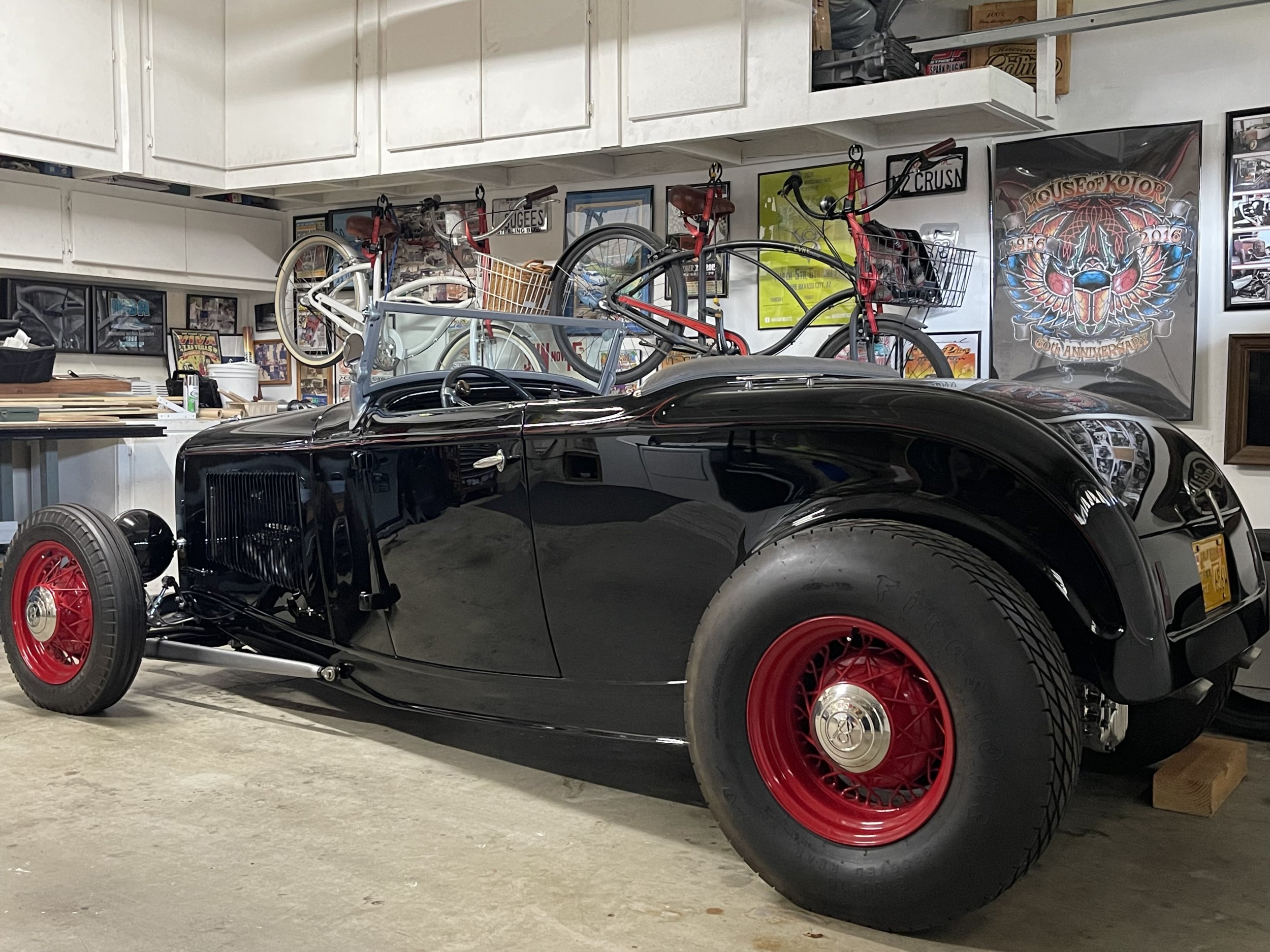

    This one runs a blown BBC. Hard to tell if it has been lengthened. (Sorry about the wheels.)
    A big block chevy is the same length engine as the Cadillac 500...... 30.5".
    They have been put into '32 Fords quite often.
    Anyone seen a '32 with a Nailhead??? They come in at 33.5" long!!!

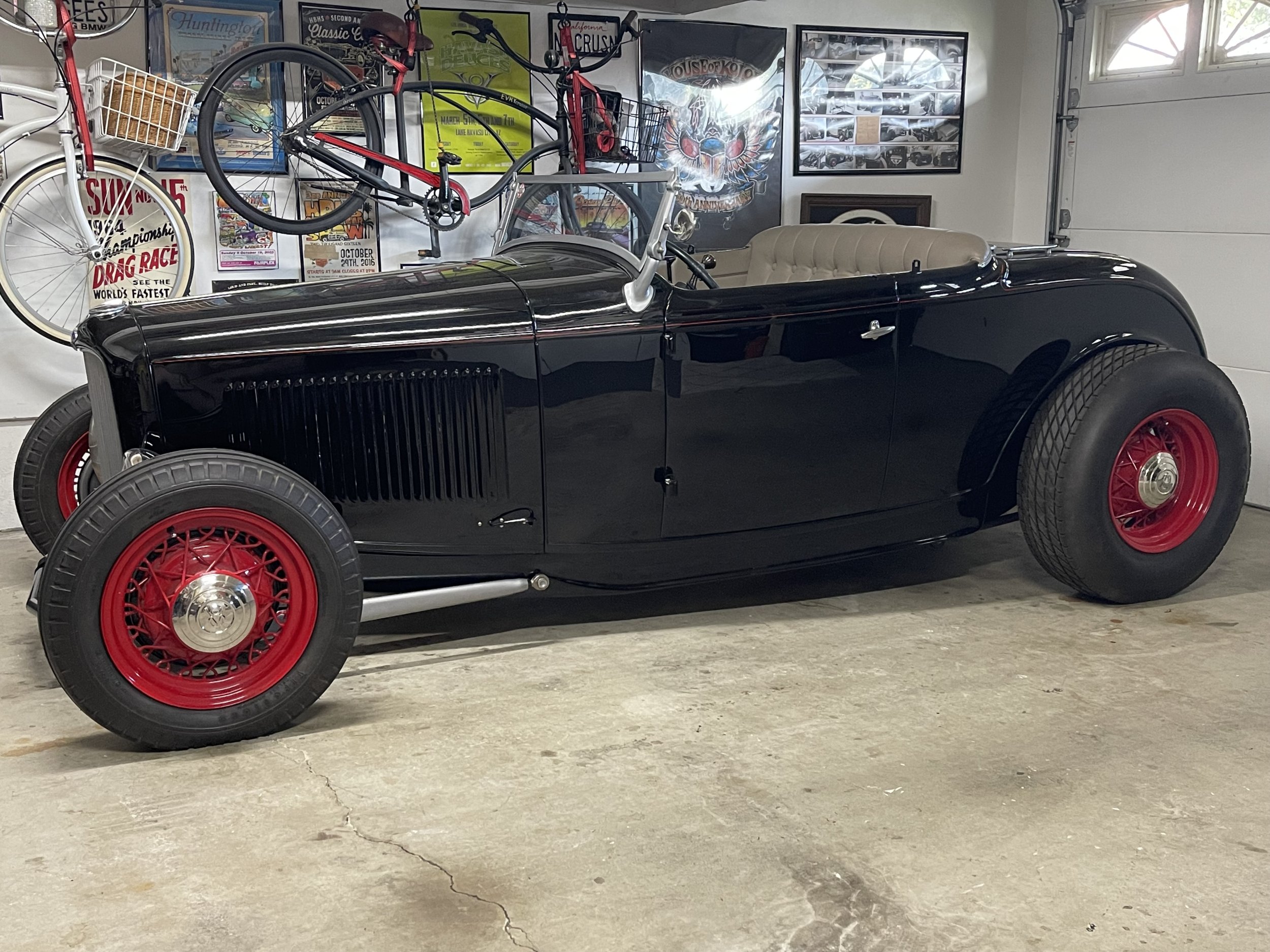

    Iversen Originals built this 3 inch lengthened roadster, I bought it because I wanted to put in a Y block. They’re about 3 inches longer than the Chevy small black that was in there. It’s all on the nose with the length and frame and reworked front rails to bring the nose down raked grill makes it a pie shape 3 inches on top and it’s reduces as it goes down. It’s in December 2002 Street Rodder magazine revolutionary deuce frame article. Good luck anything I can help you with let me know.
  23. pprather

  24. DDDenny
    Posts: 22,440
    That upswept rail looks like how Randy Clark in Escondito was doing them.
    ekimneirbo likes this.

    Yes, I agree that they are very different, but I was simply trying to show that apparent difference in overall length since both the roadster and the coupe use the same frame rails when stock. The coupe picture seemed to be the best example that I had to show a little stubbiness vs the longer look of the roadster when directly compared.
