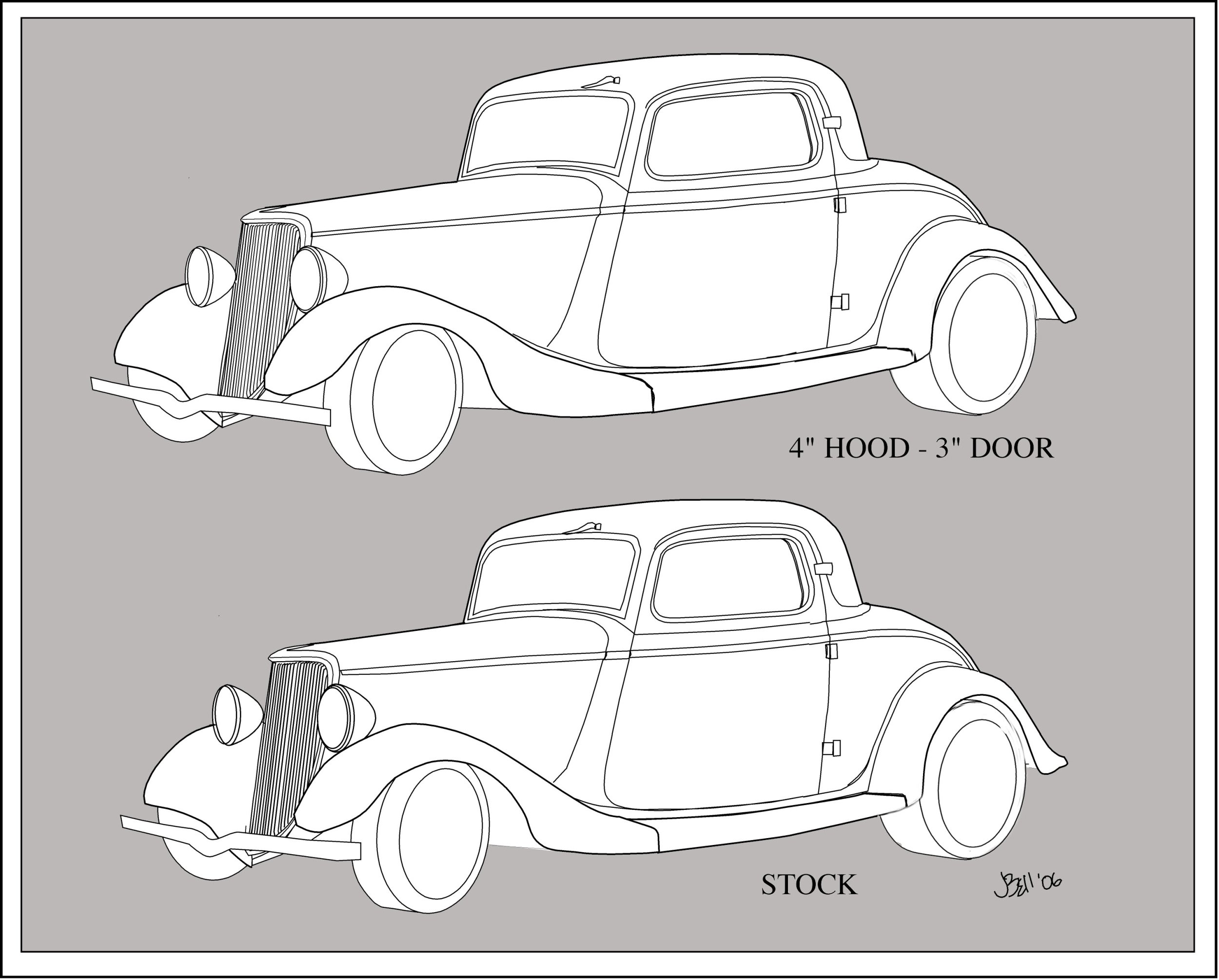

    For a project where the customer was a tall guy and he wanted to us a V-10 I did some drawings of different changes to the hood and doors. The front fender mods are harder on a '34 than a '32. Putting more in the hood than the door helps retain the proportions.
    A few years later while strolling around a show and shine I ran across the metal guy and the owner. I was really surprised how well the car turned out and actually looked quite natural, which is the result to strive for.

    Exactly my thought as well. I think most people don't really notice minor lengthening and I think its done more often than some people realize. An inch or two would be really hard to pick up on if the wheel and grille get moved to keep that visual relationship in tact. Nice drawings. I bet lengthening the door and keeping the lines in tact was a tad more work than just extending the hood and repositioning the wheels and grille during a build.:)

    The metal guy shared how difficult it was. I believe he made new door skins and quite a bit of the front fenders, he is excellent. A lot easier to do on paper and see options of how it looks before costly mistakes.
