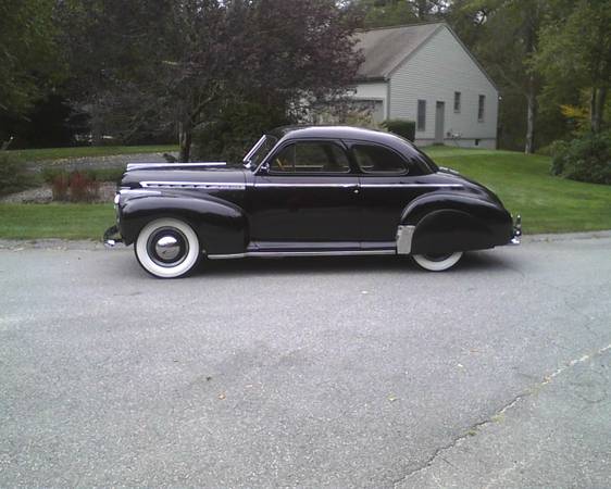

  10. NashRodMan
    Joined: Jul 8, 2004
    Posts: 1,989
    NashRodMan
    I have Lesters on my chevy (avatar) and they ride and look great.
      36.8 KB
      154
