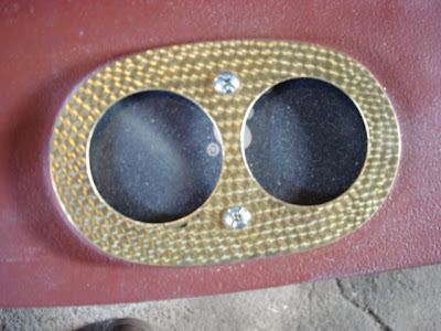

    Here's a little somthin FPM metals did for me, firewall to match. They even cut out the holes with a laser. What ****s is I had the job done before they joined the alliance......[​IMG]

    fpm did this insert for my merc.
      62.5 KB
      167
