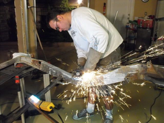

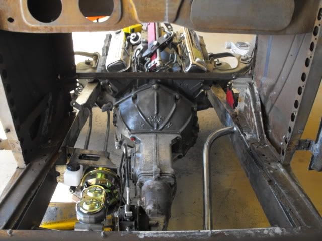

    So I left off mocking things up bit and figured it was high time to move forward. I knew that the frame and some of the fabrication would need to be gone through and cleaned up to not only look better but also to ensure that things would be safe. Fortunately for me, I am good pals with Justin B who agreed to hang back the week after Round Up and help me get a few things done. The plan was that I would take a week of vacation after Roundup and we would work on the truck to fix and clean up the frame, mount the engine, transmission, c- notch the rear, and install the new MII control arms then whatever else we could get done.
    Justin came out for Round Up and as an added bonus (and some good ol’ comic relief), brought Magoozi with him from So Cal. After a Roundup weekend that couldn’t be beat, we started mucking with the truck Monday morning after coffee. As you could tell Justin and Miguel are ready for action….
    We then got the motor and transmission in place and started to take some measurements…
    The serendipitous score of the Round Up swap meet was the toe board that I picked up from Austin’s very own Hot Rod Bill. Justin was insistent that we start by truing up the floor and stretching the cab so that our placements would be spot on.
    The one real cool thing that I started to learn was that you didn’t need a lot of fancy tools to tackle this job. Justin made a makeshift portapower with the jack out of the Tahoe and we soon had the cab resembling its original form.
    Once we had the cab kind of where we wanted it, we set out to getting the motor mounts roughed in.

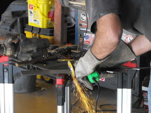

    Once the motor mounts were kind of figured, Justin went to work carving up some flanges for the removable transmission cross member…
    …then on to final fitting the motor mounts.

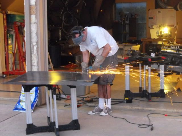

    Right about now, Justin decided we needed a floor, as quick as a whistle he started to slice some sheet metal…

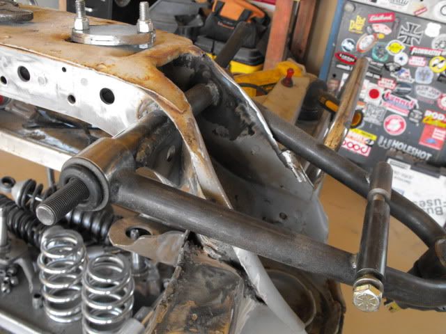

    While he exercised his mad skills, I went to work getting the new control arms installed….
    When I came up for beer, err I mean air..., Low and behold what a site to see, the floor was really taking shape….

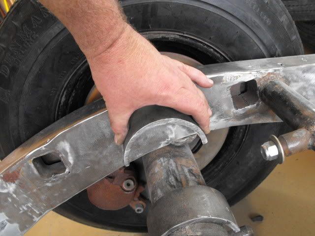

    As Justin finished the floor, I worked on making some patches for the frame and some “c” notches (though we they are probably over kill)

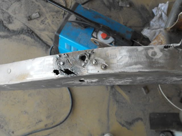

    Right up to now things are going alright, and then we decided to strip everything down and flip the frame. That’s when we started running into some rot, crazy torch work, and had to get serious about making things a little bit more structurally sound…
    Justin went to town stitching it all back together…

    …then it was time to weld in the gussets and finalize the new “A” arms…
    …and finish up the transmission cross member.

  27. While looking at the floor picture I couldn't help but wonder if you made a flip up panel or something to access that brake m/c?
    Just a thought ;)

    Bill - Agreed, this was one of the best vacations ever, it totally kicked butt. Thanks again for the deal on toe board, it was the star of the show as we relied very heavily on it's placement for a baseline reference. You don't have a firewall laying around do you?
    Gary - We did as a matter of fact, I just didn't post a pic of it but will....
