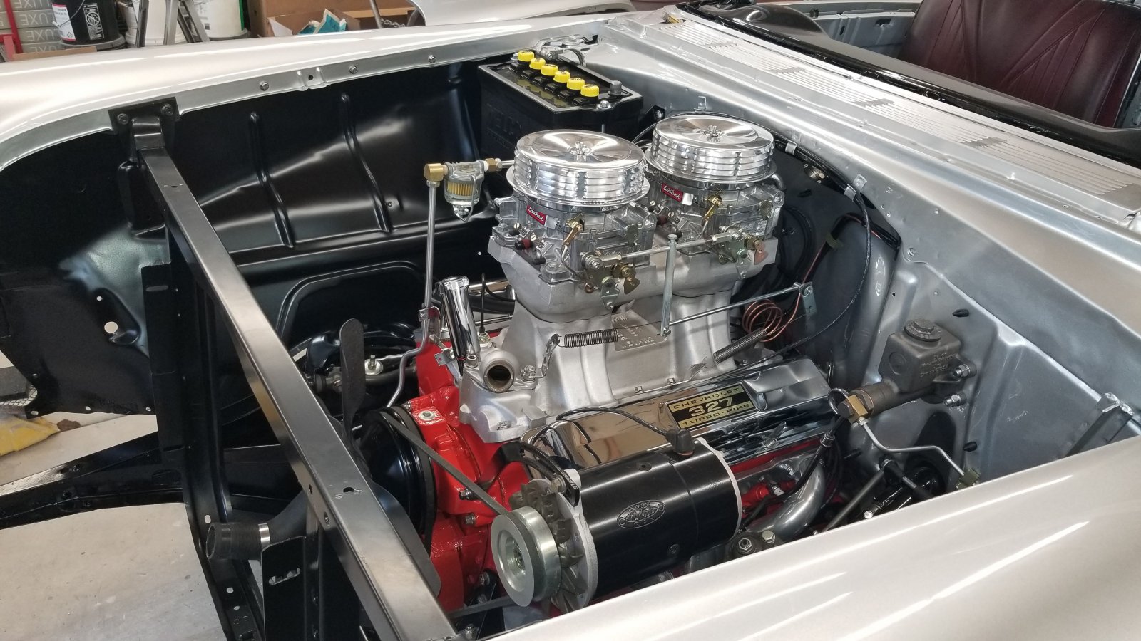

    Sound's like a good plan. Does that 386 block have a spot for the breather in the back or a boss to machine for the breather? If you get tired of the Corvette or the script valve cover's, there's always my favorite go to... 20211107_121222 (1).jpg

    That’s mean looking! Nice!

    Thanks Man!
