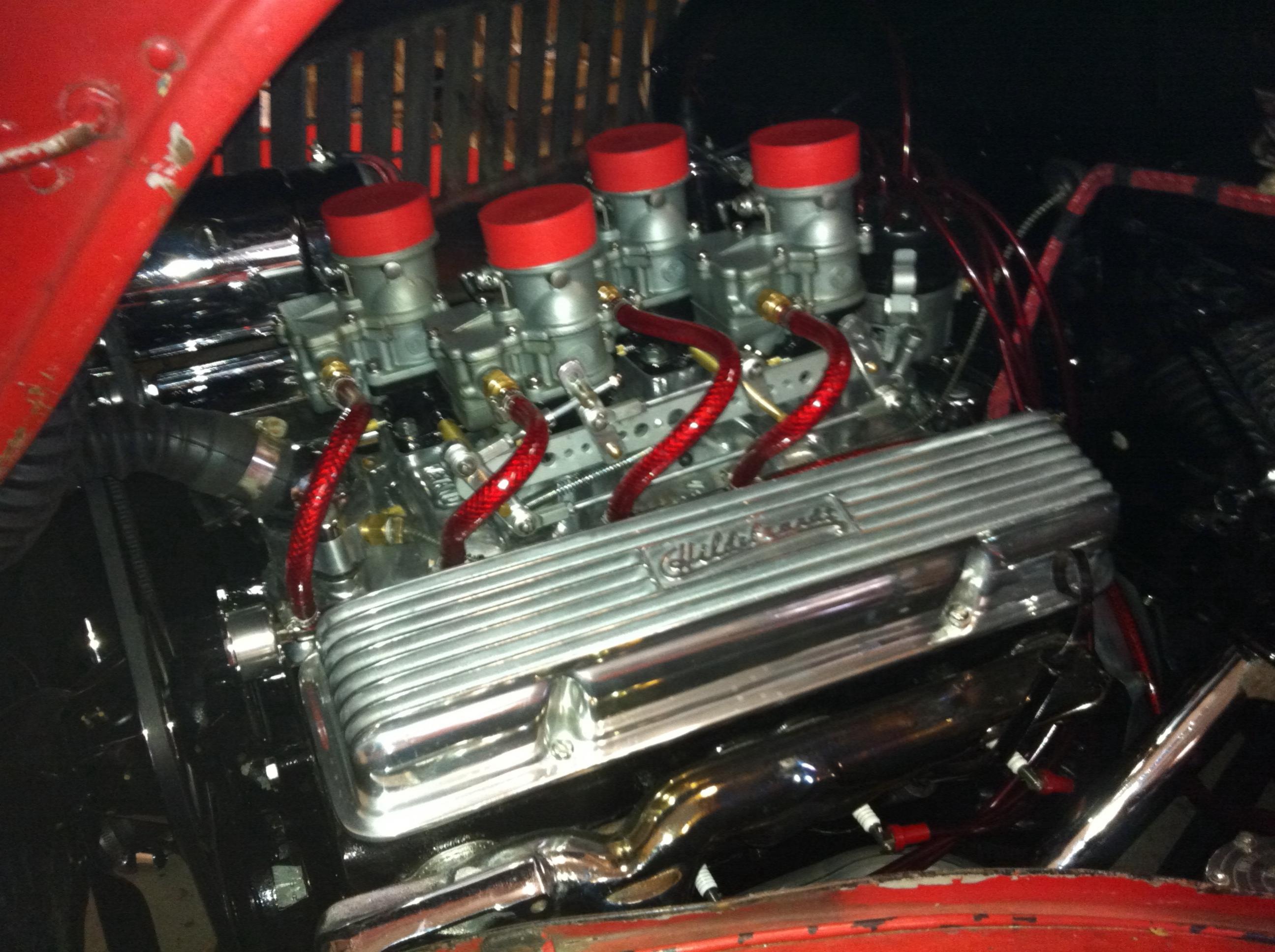

    Front left on the intake. Now, the 55 265 was at the left REAR, and those 4 barrel intakes are RARE; a one year only item. Butch/56sedandelivery.

    I already have 283 slugs in my 265 but thanks!!! Good thinking on keeping the 265 around, they're just plain cool engines!
    Damn it! Well I guess that's not going to help. I'm using a Weiand 4x2 intake and the bungs are up front on p***enger side. That temp sending unit will never reach that far so I think I am going to have to machine (and when I say me I mean my friend Jeremy since it's over my head) a spacer that sits below the water neck and thermostat so the sending unit can be plugged in on it's side up front. If it's not one thing it's another....

    Damn it! Well I guess that's not going to help. I'm using a Weiand 4x2 intake and the bungs are up front on p***enger side. That temp sending unit will never reach that far so I think I am going to have to machine (and when I say me I mean my friend Jeremy since it's over my head) a spacer that sits below the water neck and thermostat so the sending unit can be plugged in on it's side up front. If it's not one thing it's another....[/QUOTE]
    The second pic show the boss where you can drill and tap for a rear to the left side sending unit to be placed. Just saying. Details Details

    Well that picture just did it for me. I got a 1956 sitting on the floor in my shop with a cast iron 'glide. Now I gotta a build this little F'er !!!. Thanks for doing all the hard work Jeffrey James. Now to find the right pieces....

    The rear cam bearing journal is the big deal if you upgrade cam you must grind a notch like the orignal and distributer or no oil the the upper end.

    I did grind a notch on my Duntov 097 cam but I didn't have to when using the Mallory Dual Point that I did. It seems to have a notch in it all the way around which allows for the oil to be sent up to the rockers.

    Thanks Jeff! Uncle Max did my carbs, ****ster did the linkage and I had a crack head do the chrome!!! I think I may have leaned the engine out because the back of the chrome exhaust manifold turned almost black. That could be the chromer or my fault. It also may have been that I set my gaps on my spark plug at 20 instead of 35. Not sure but I need to figure that out because it looks like ****! Bluing is ok but turd brow is kinda gross. :D

    I put a 55 265 in my ole truck, don't know much about it. I bought it rebuilt. I do know it sat for a few years on the oil pan and apparently they don't have much clearance so when I started it up it had a knocking sound that drove me crazy trying to find. The pan looked fine but pushed in enough to get in the way.

    That sound comes from 1.75" pipes ran straight out the back. Wanted Porters but just couldn't swing them this year. Maybe next if I get sick of hearing the Turbofire through straight duals.

    you said two different things in this reply, the cam needs to be notched like you did in order to get oil to the lifters, or not notched and a modified rear oil gally hole and newer style cam bearing,basically the oil galleys arent "full pressure" just intermitten the distributor doesnt really have anything to do with the oiling, they just complete the oil galley the deal with the distributor is that you can just a newer style distp in any spot where as the original distributor has to be in the correct spot to complete the oil p***age, also you not supose to use the original distributor if you update to the new cam/oil galley mod/newer cam bearing because the full pressure will fill the oild style distributor full of oil.(under the cap!)
    just to clarify.
    and your motor looks awsome, glad your posting some pics again.

    Sorry I modified the cam with a notch like the original is. However I did not notch the distributer because the vintage Mallory Dual point does not need it like you said when I PM'd you. It looks like the Mallory distributer has a notch all the way around it which allows it to act like the original Distributer.
    I didn't not update the block like B*** did on his 265 just kept it basic and simple and followed the original idea. Does that make sense? I may have did it wrong haha!!! The oil does in fact reach the rockers so I think I'm good. Everything looked good when I rechecked my lifter lash to 14 and 20. Oil was getting there well.

    There were actually TWO sets of dual quad set-ups for 1956. Those numbers are for the LATE 56, and are BETTER than the EARLY set-up. The EARLY set-up used the #5306 heads (also used on ALL 4 barrel engines in 56), and a #3728725 intake; both the heads and intake have extremely small ports, but also have the smallest Power Pack chambers at 56cc. This is the set-up I have, only "someone" port matched the intake to fit larger port heads (ruining the value). Also, as I understand it, the 56 dual quad engines used a 2 bolt flange on the rams horn exhaust manifolds, and are impossible to find. I too was building a 265, but most of my plan has fallen apart. I was going to use a Canadian, 4-bolt, 305 block, and bore it .014 over to standard 265 specs. The block wound up missing the main caps, was thoroughly rusted, and had a deep ridge in the tops of the cylinders; it was supposed to be a "perfect" block. The crank I have is a 68-69 #1178 302 crank (3.00" stroke). The pistons I bought, and planned to use, turned out to be Thompson, forged, SEMI-FINISHED, domed pistons. I found a place to do the finish grinding.....for $400.00; so I sent the pistons back for a refund. I have'nt given up completely yet, I still have the EARLY dual quad intake, and a just finished pair of #5306 heads. I had all new valves, springs, retainers, and keepers installed, along with 1.84 intake valves and screw in studs (not the shouldered type). So, unless a complete 265 short block, or a 305 roller short block "falls' into my lap, my 265 dream will remain just that, a dream. Butch/56sedandelivery.

    You did it all correctly, i was just explaining the mods and whats done for what reason.
    the distributor just conpletes the oil p***age, if you have the original distributor you just have to have it in the correct spot. thats all i was getting at. theres no mods needed to the distributor.
