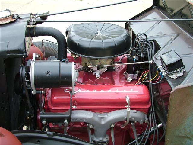

    When I built my '34 coupe , I was trying to do it in a way that would reflect how I might have built it in 1957. Just as if I had been 18 in 57! Since my Pops was a Chevrolet mechanic, getting a "new" Chevy V8 would have been a must...so I tried to make my 265 look like it had just been pulled out of '56 Chevy. The only year they were painted red.
    So here's my "original 265. '57 block, .040 over with a 300hp 327 hydraulic lifter cam. I thought in a smaller displacement engine this cam would sound a little hotter than it does, second time around I'd probably try the 350hp 327 or similar. Anyway, '58 Corvette intake and rebuilt WCFB, '56 Corvette heads and single point diz. Generator and gl*** sediment bulb fuel filter, '58 ram's horn exhaust and modified '56(?)air cleaner finish it off.
    This motor pulls the '34 nicely, revs quick and cruises easily at 70. I like it and I think you will like yours too!! Good Luck
