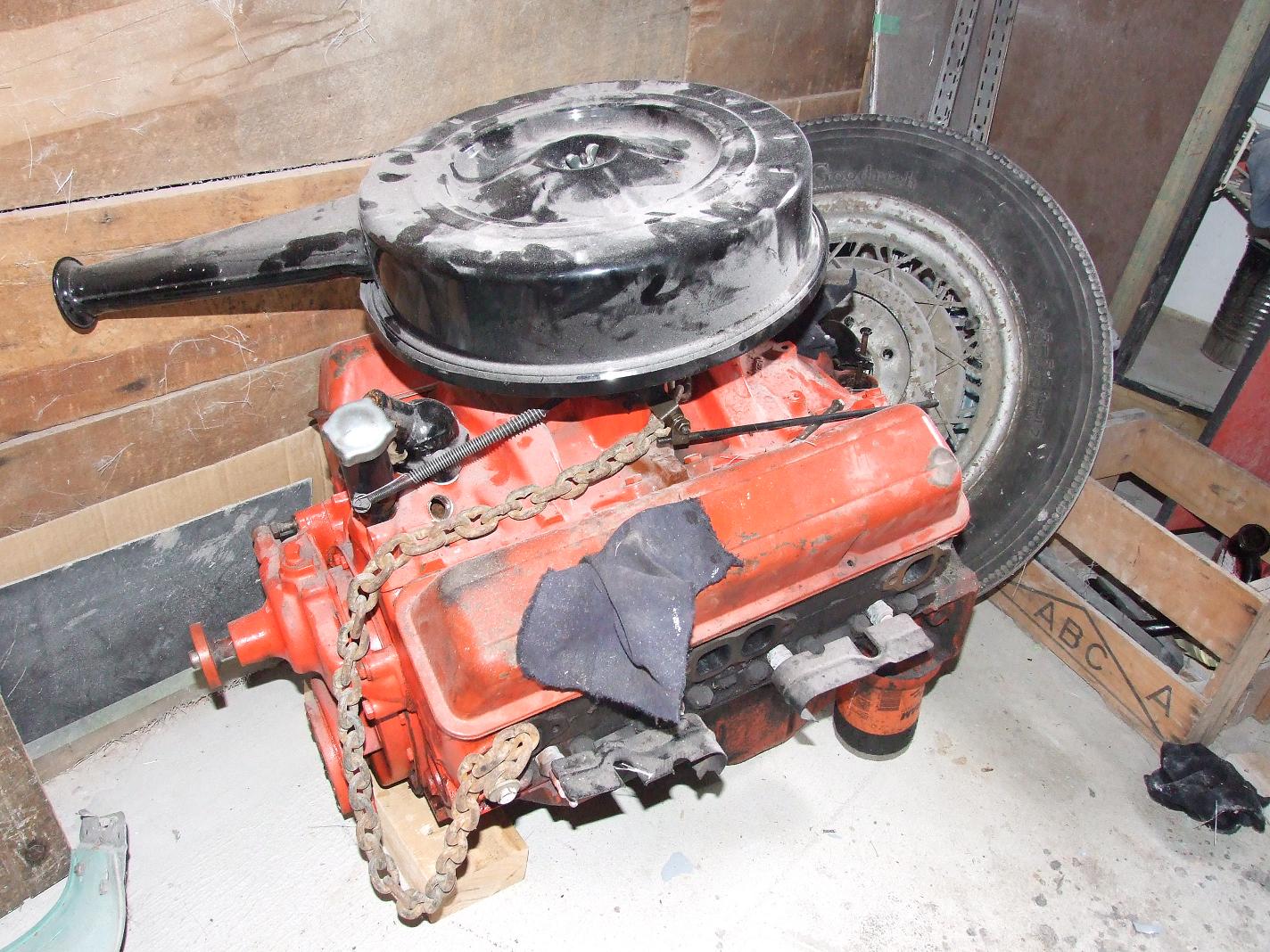

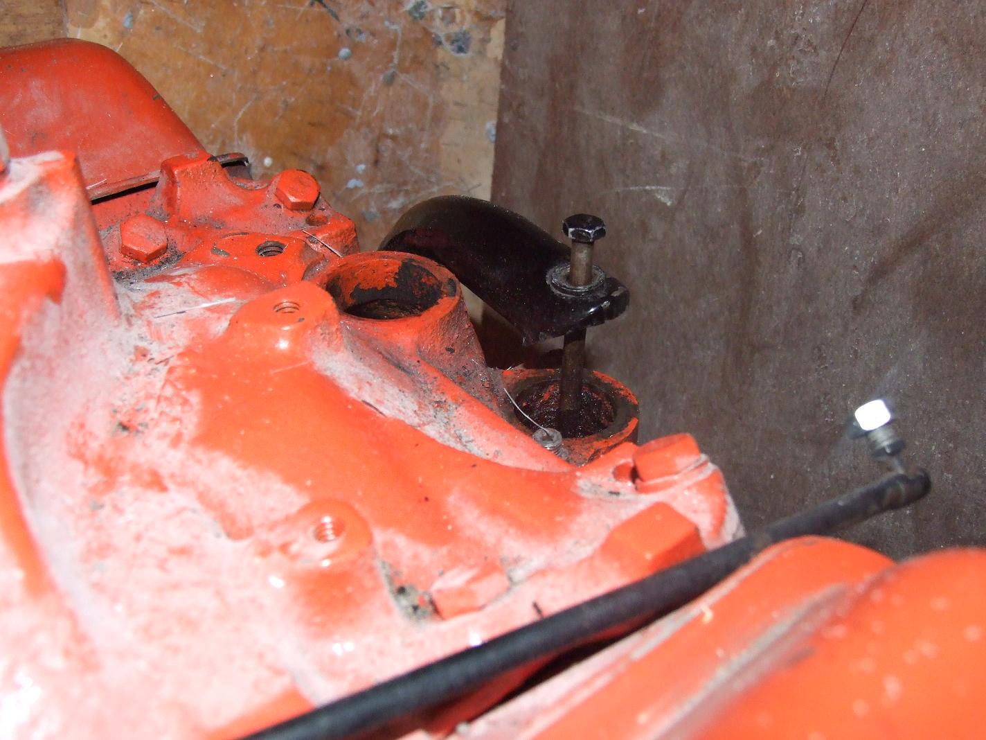

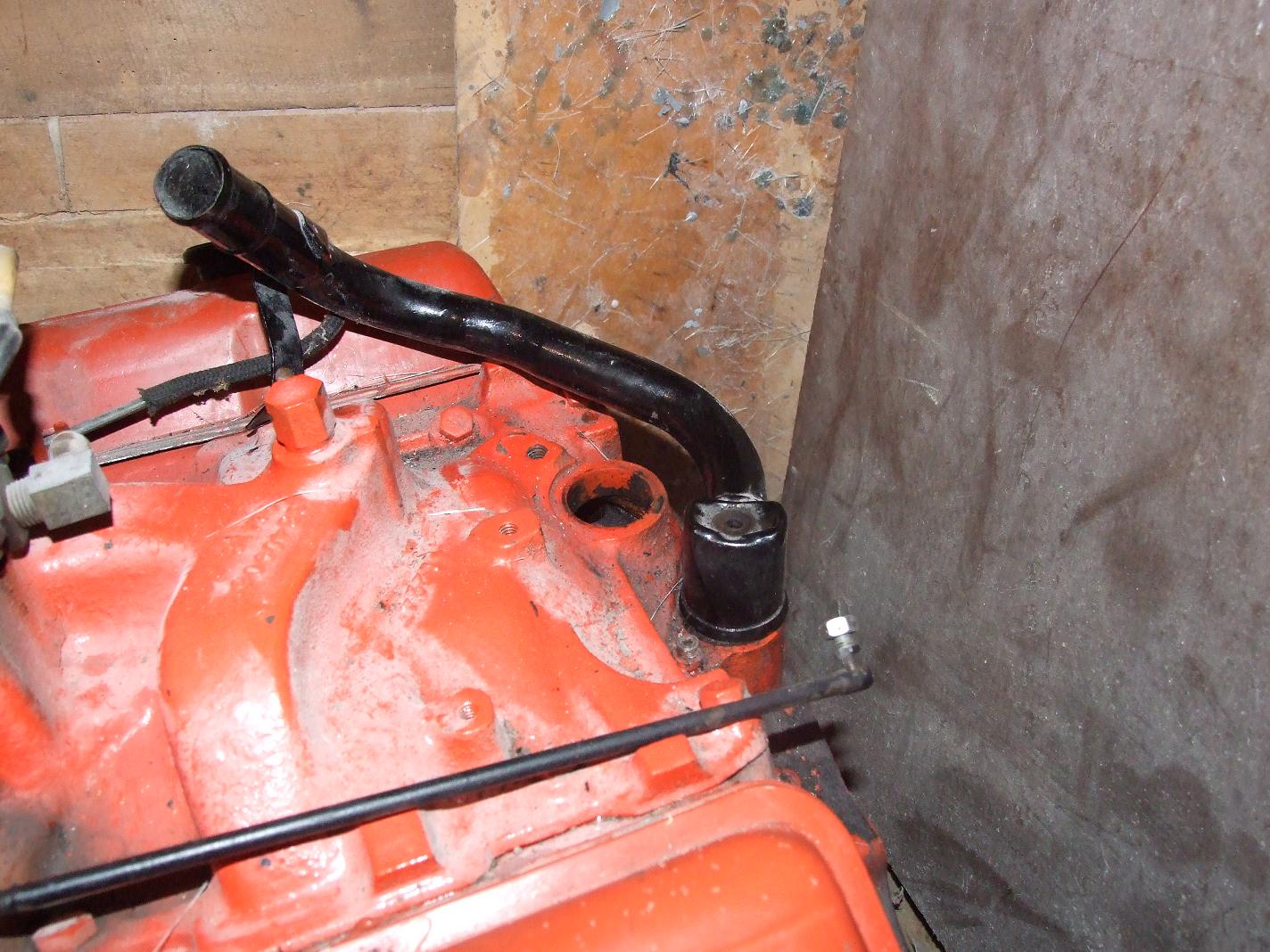

    Hi guys, I have a "59 283 thats a good runner (I know the car it came from). I'd like to run the original road draft tube but there seems to be a part missing (photo 1) could someone clarify this, or am I trying to mount it wrong. It also came with this one (photo 2) that goes under the air cleaner base. I've subscribed so when it comes time to tart up this old lump of iron I'll know what I'm looking for.

  13. Yep. You are missing part. There is another section that is mitered and brazed/welded to what you have. It has a lip that seats to the block. I'll try to find a pic.
  14. Here you go...
  15. n.z.rodder
    Joined: Nov 18, 2008
    Posts: 1,015
    n.z.rodder
    Thanks for that, now I know what I'm looking for.
