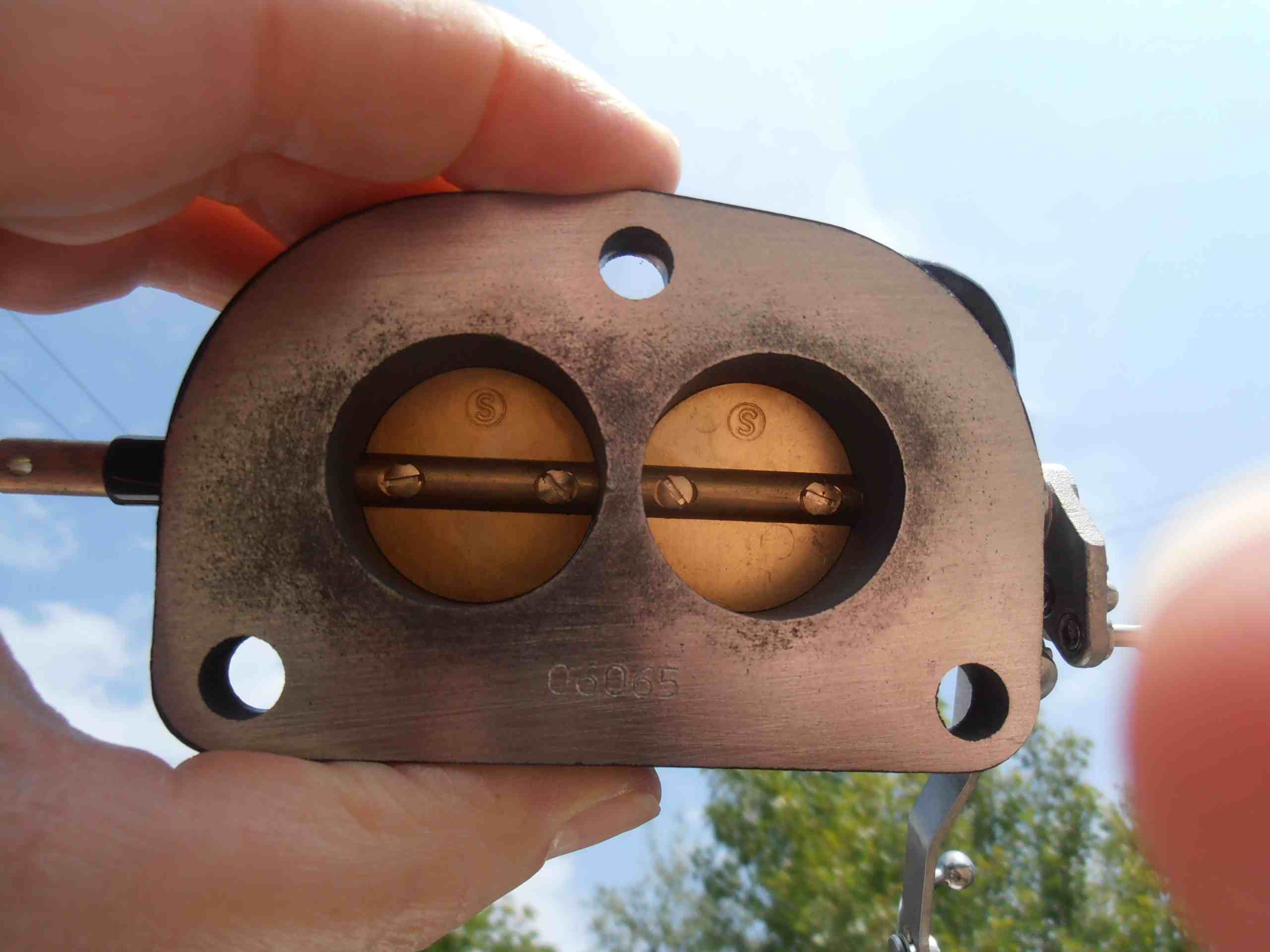

    The picture was of the plates closed all the way with the throttle stop screw out. I also was holding the throttle shaft closed tight. All three are this way. If I put the other two carbs on progressively won't this act as a vacuum leak?

    The throttle plates should shut pretty good. It's a production fit, so I'm not going to pretend that they are hand lapped like you might for a race car, but as I said, you'll probably run them a little open anyway. Here's the deal, for the engine to idle it needs to get some air and gas past the throttle plates. There are two sets of idle ports in a 97 base, lower and upper (transition), above and below the throttle plate. Technically this means you could get gas mixture through if the plate is closed, but usually that's not enough.
    A vacuum leak is when the air is coming from outside the carb (typically through worn out throttle shafts) so it is not collecting its metered share of gas along the way. If the plate is open a little, we're talking air being drawn through the carb by the engine, and collecting the right gas to make the correct air/fuel A/F mixture for your idle.
    Set all three carbs on the manifold with no linkage at idle. Get a vacuum gauge and balance all three carbs so each is set the same and contributing the same air/fuel mix to the overall engine. Aim for the maximum vacuum from all three carbs. You can adjust them using the throttle stop screws on the side of the carbs, and the idle mixture screws on the bases to keep it smooth and not lumpy. It's fiddly and you have to go around and around adjusting. There was a great post on the HAMB about carb balancing years ago if you can find it. But you should get a smooth idle at the rpm you want - using all three carbs.

    Hi everyone. Thought I might attach a couple of pictures of a random sample throttle body from today's 97 production to calm a few nerves. With nothing attached to the throttle shaft they close real tight. Thanks.
