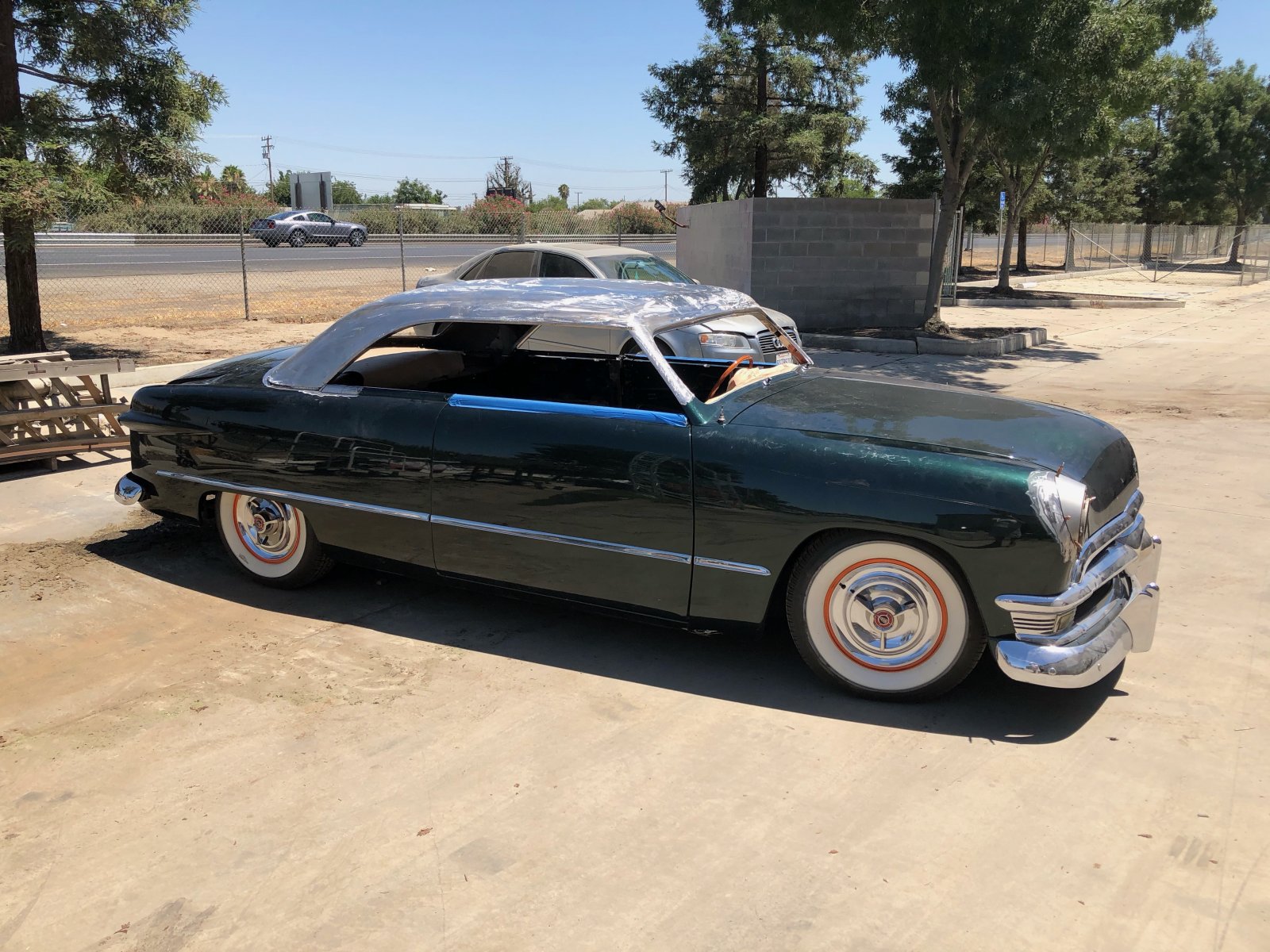

    Tony called a while back and said he wanted to build another car, a hot rod shoebox coupe. We spec’d the whole thing out, established a budget and he started looking for a car. He soon realized he didn’t want an additional car so, one would have to be sold. Not wanting to sell the 40 convertible or 50FRAUD. The plan changed to update 50FRAUD with some of the things that he wished he had done when it was first built as well as a few repairs that it needed.
    The biggest update was to chop the top about 2 ½ inches, much like this car he had seen years ago.
    Before cutting in to the car we enlisted the design ***istance of Rik Hoving who provided several quality Photoshop renderings. Tony selected one that was quite striking in that the quarter windows are actually longer front to back than they were stock. Normally, they would have become shorter when chopping a top and sliding it forward a few inches. This one change along with a few others that are more subtle make this more of a custom roof than merely a top chop.

    Speaking of rain gutters, the piece that went around the front of the roof has been removed. 51 Victorias have a lot of sheet metal above the windshield. Chopping the top somewhat upsets the balance between this sheet metal m*** and the gl***. So, to minimize the “giant forehead” look we opted to remove the rain gutter above the windshield and move top of the windshield up into the roof.

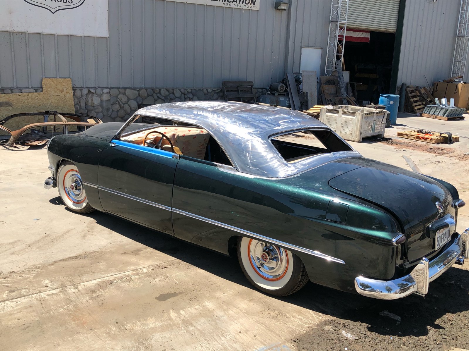

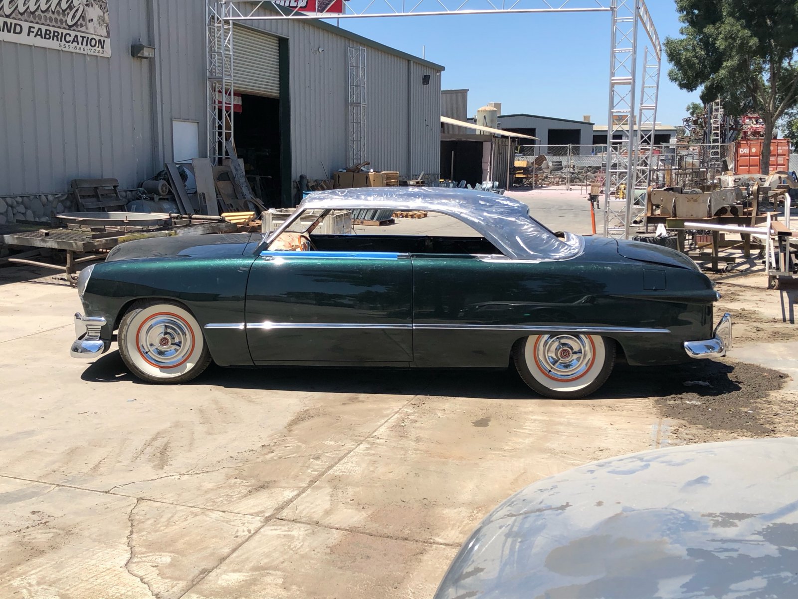

  15. The only pisser with chopping one of these is you always lose the signature wrap-around rear window. With that gone they look like a hardtopped coupe. Isn't there a suitable windshield that could be cut down to fit?
    Good call on the windshield opening.
  16. I actually think that wagon rear gl*** is genious compared to how most are handled. looks factory.

  18. I'll agree that rear gl*** looks better than most, but that wrap around is my favorite styling cue on these and is what sets them apart from the more mundane models.
  19. IMO, this is the only chopped 1952 ford Victoria that I have seen that looks good.

    I agree with Crazy Steve. When looking over the pictures I saw the beautiful rear window and trim. I saw him chop and was interested in seeing them handle it. Then saw it was all gone. Bummer.

    A windshield could possibly be used for a wrap around rear window but, it would take a lot of junk yard searching with templates to find one that would work. Gl*** doesn't bend so, it would have to be perfect.
    A more doable way to achieve that look would be to sink the bottom of the gl*** into the package tray. The rear gl*** is tempered and I've been told by several experienced gl*** guys that it cannot be cut.

    Absolutely outstanding work! That's the first '50 Ford I've seen that looks right with a chop. You guys nailed it!

    The Victoria that **** Page built for Tim Smith years ago (shown in Don's 2nd post in this thread) was clearly the influence that had me decide to cut up my car. **** also used a wagon liftgate window, and I really like its appearance, so I chose to copy it. I've had this Victoria for 30+ years, and realize that I'll be giving up some peripheral vision with the smaller window, but I really like the looks of the solid, windowless roof behind the quarter windows.
