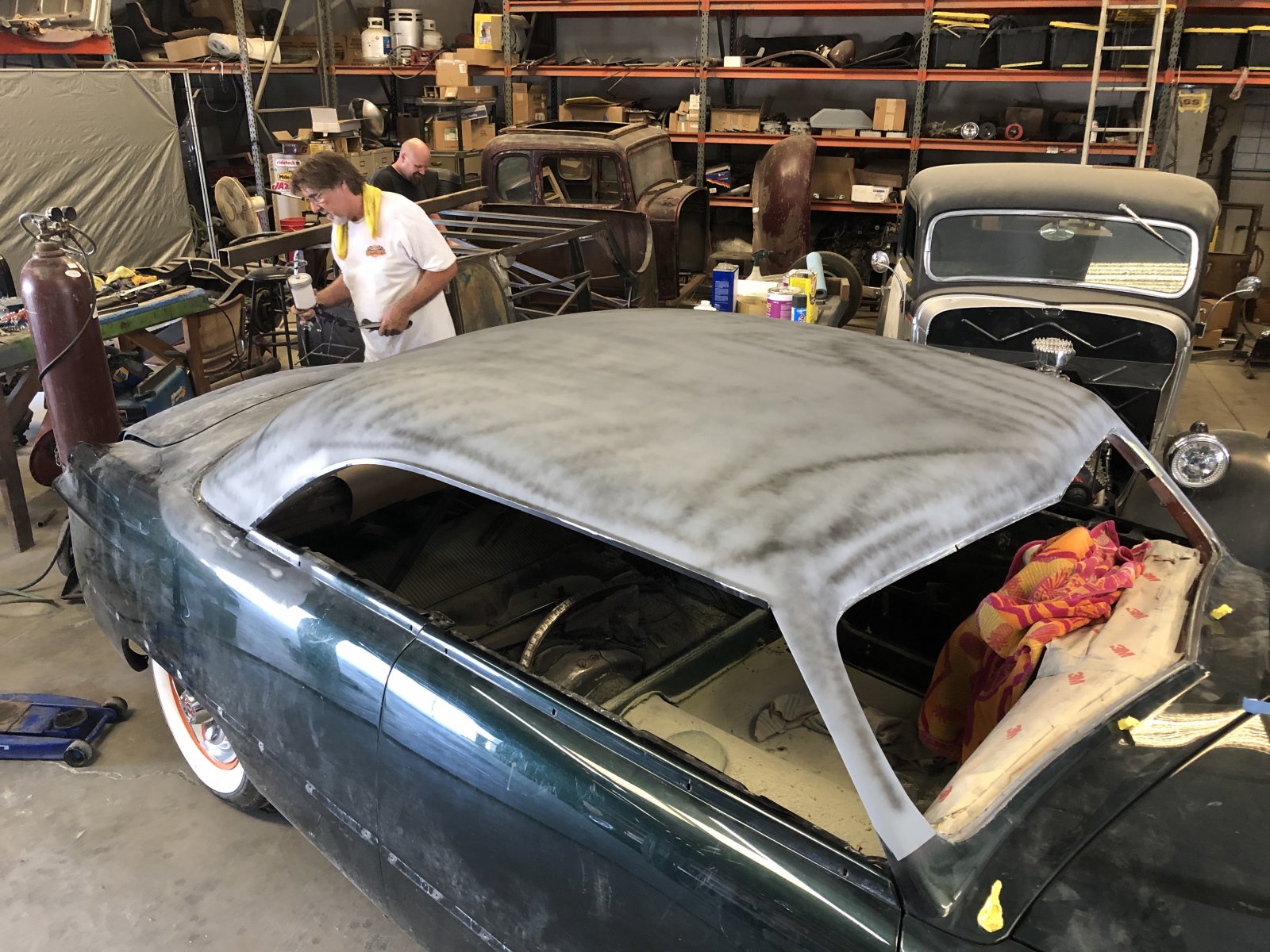

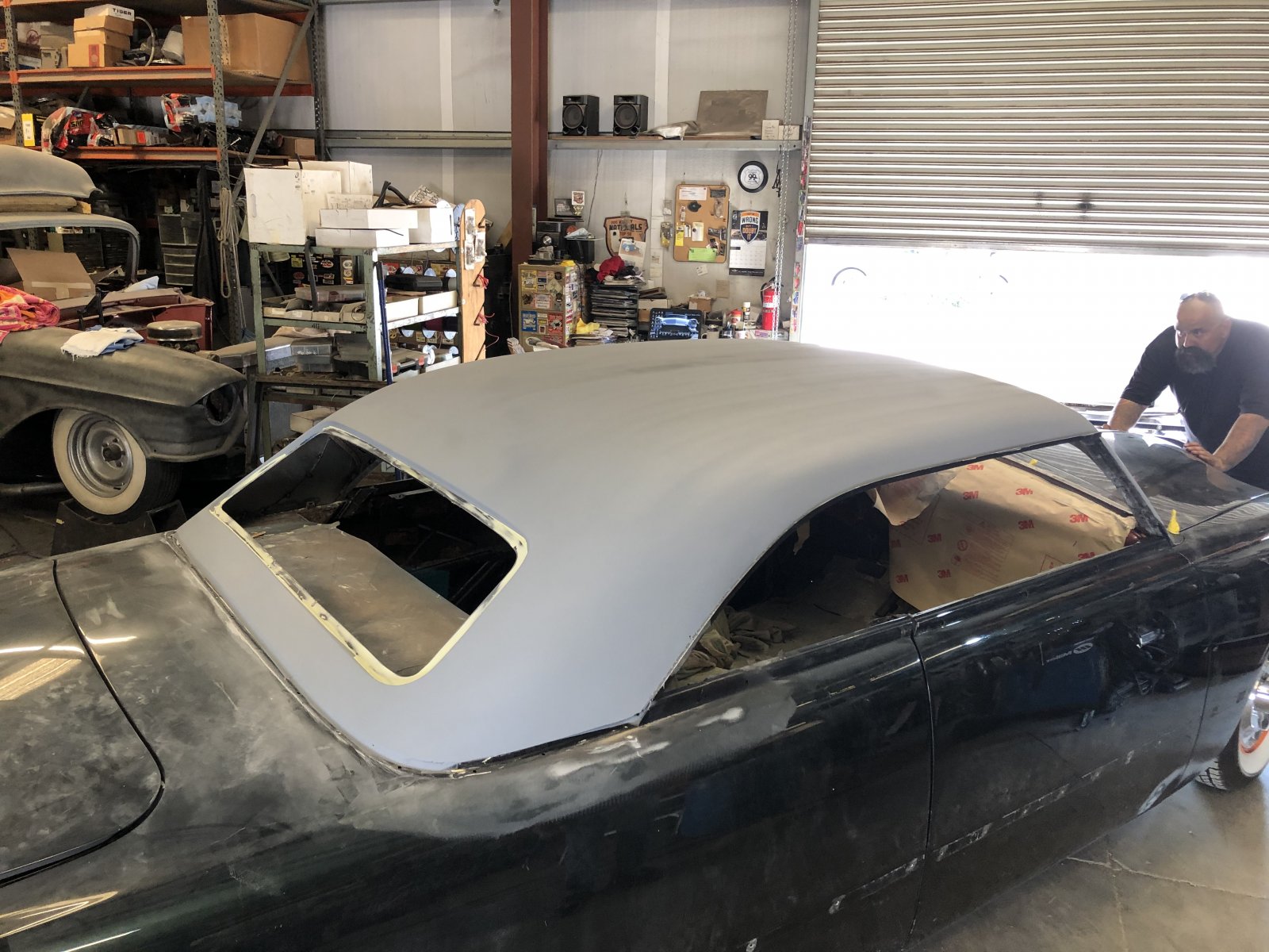

    0EE2D7FB-80A5-4921-8C90-3D90F3F5AD9E.jpeg F472633E-E940-47F2-8421-23544426D6EF.jpeg
    Good progress this week. The top has been skim coated with Rage Gold, sanded, shot with the first coat of Southern Polyurethane’s high build primer and guide coated with cheap flat black spray bombs. Now it’s ready for some block sanding.

    Great, thanks for the update. For some reason, my phone received four pictures with this post, but the computer only got two.
