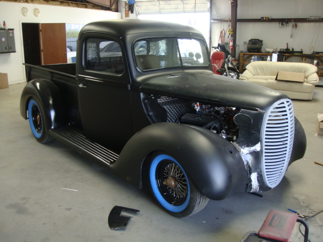

  7. whistlebritches
    Joined: Mar 8, 2010
    Posts: 90
    whistlebritches
    from texas
    man o man.....great work.....just about done with my 39....wish'd i'd seen this a year ago....and the rendering, dejavu ..... here's mine ready for paint on the front

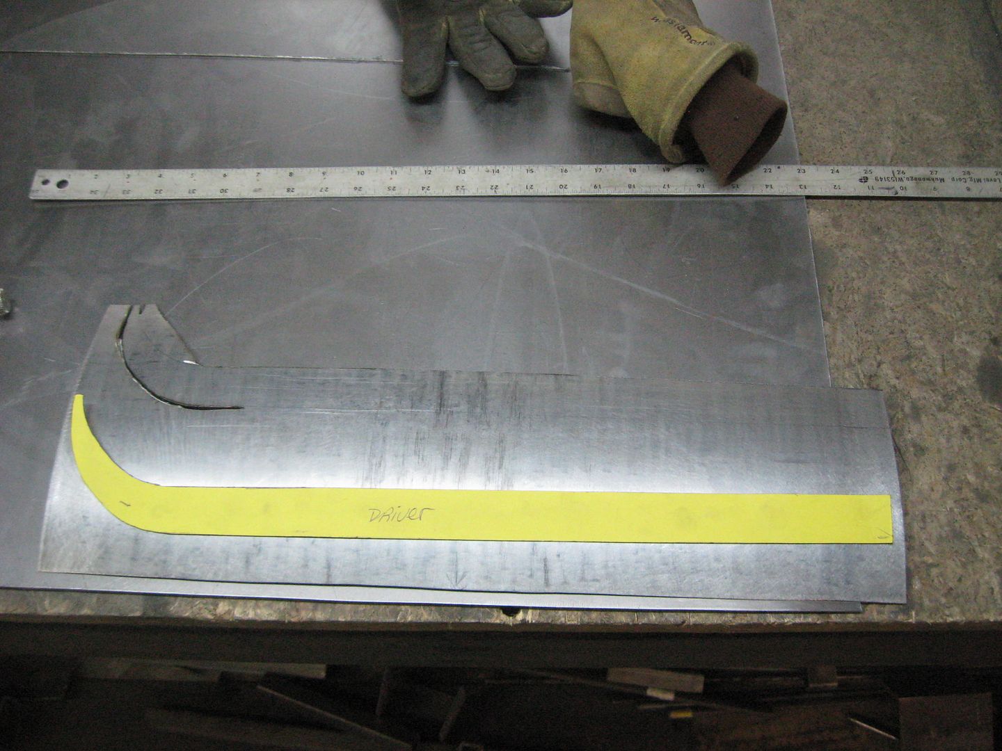

    ok we left off doing the filler piece above the door jamb thats also part of the drip rail we had to hand make this piece so lil dave is the right man for the job
    once he liked the fit we'll get er tacked in

    making the filler pieces for the pass side drip rail and over the door jamb
    heres a shot of the pieces we used to hold things in line for when we made the paturns for the 2 back pieces
    the paturns for the rear filler sting on top of the piece dave rolled
    a shot of the paturn and the opening were it goes
    another shot of the paturn on the rolled panel
    the fitting of the new piece
    here dave is holding up the piece while max scribes it so it can be trimed
