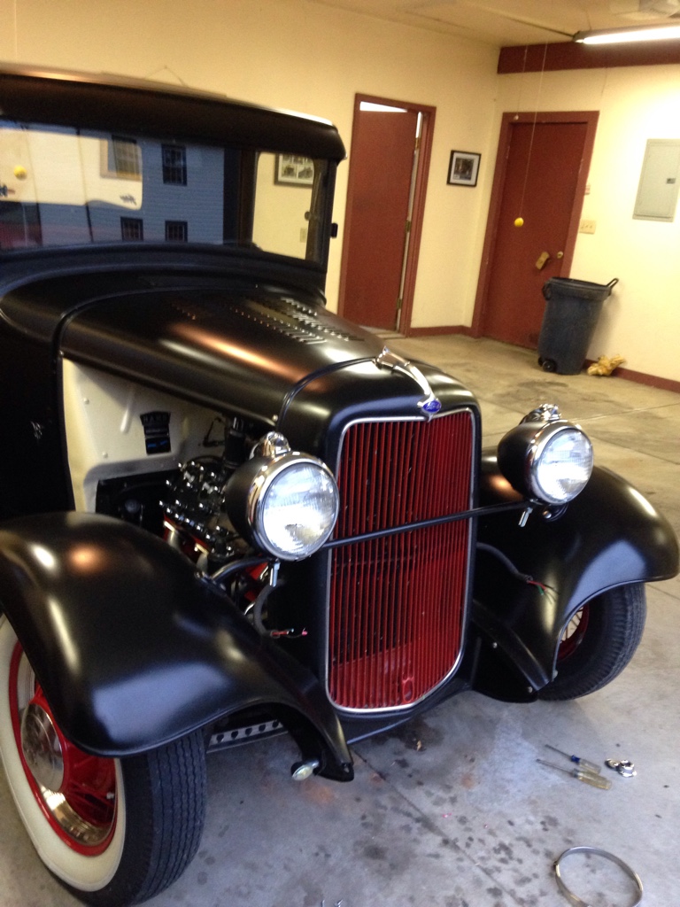

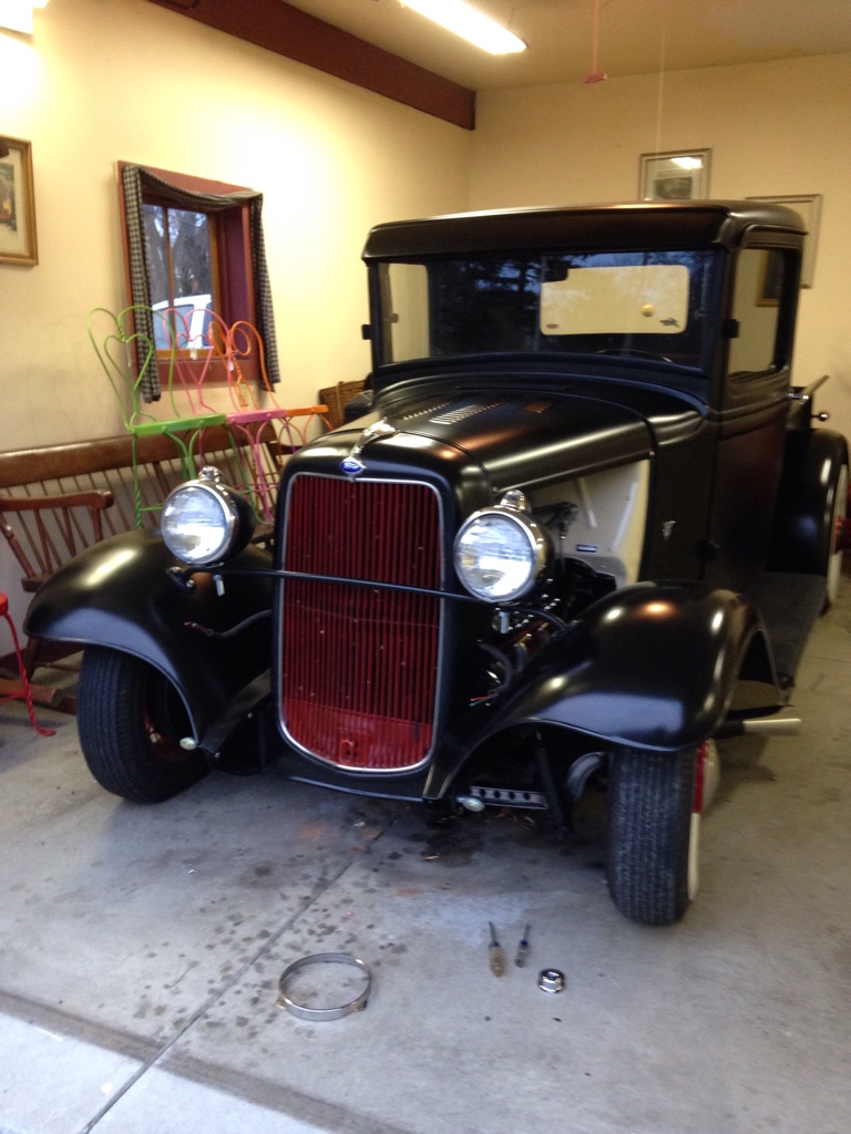

    I like these much better.
    Picked the ones with the chrome marker lights.
    Now I just may dropped the bar some.

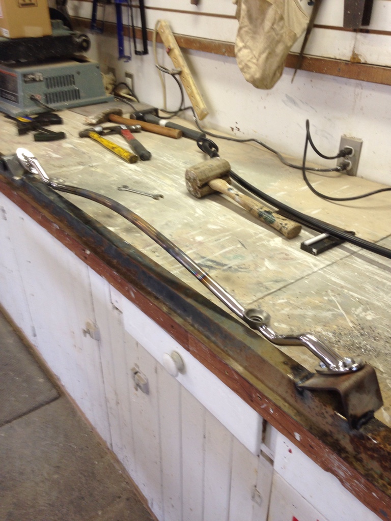

    Ok you guys won. Partly.
    I bent and installed a new drop bar.
    The new 32 drop bar doesn't fit a 34 truck because of the radiator placement I bent it to just miss the grille.
    Made a brkt to hold the hole to hole location of the fender mounting location by welding a couple of angle irons onto a stiff piece of channel. Drilled holes into the angle iron to mount the new drop bar and hold its position in place.
    Heated the center area of the bar and bent it forward by a wooden pry bar.
    [​IMG][​IMG]
    The dropped bar fit perfectly.
    Follows the contour of the grille and mounting bolts slid right in.
    The stainless buffed right out.
    [​IMG][​IMG]
    I like these slightly smaller lights better especially with the top mounted turn signals.
    The drop bar slid the light position down and I'm a happy petejoe.
    [​IMG][​IMG][​IMG]
