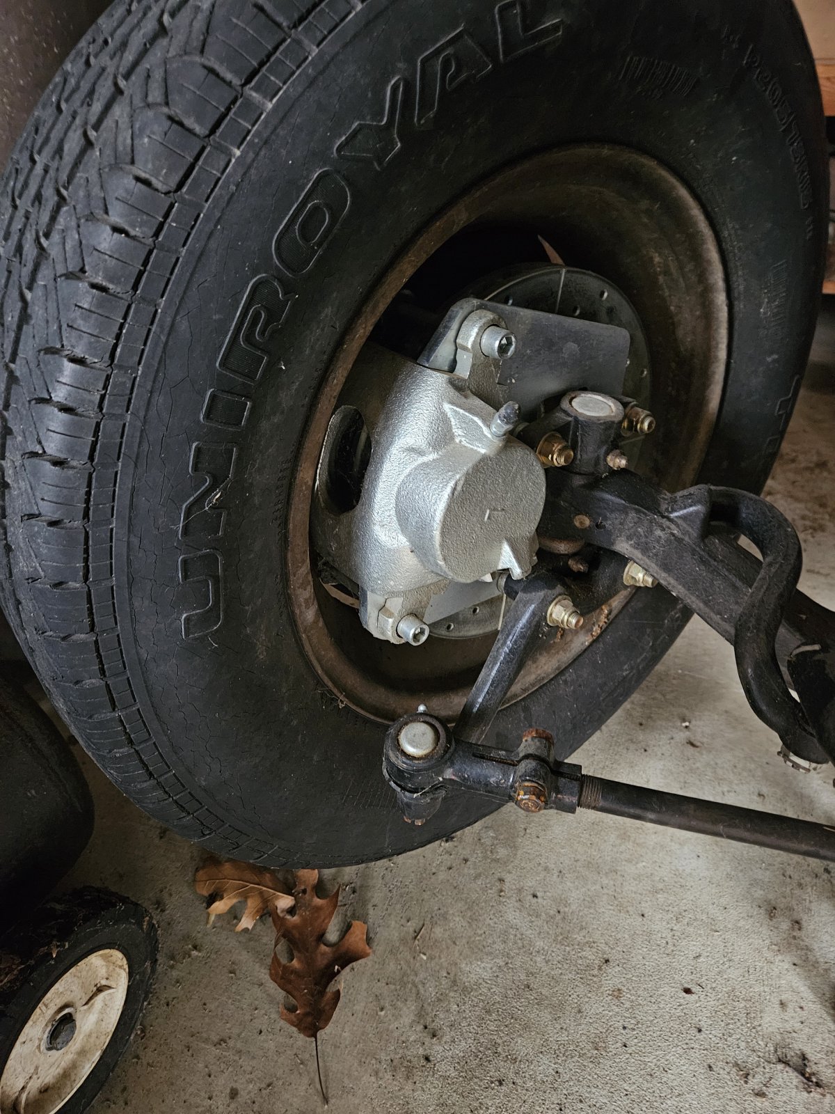

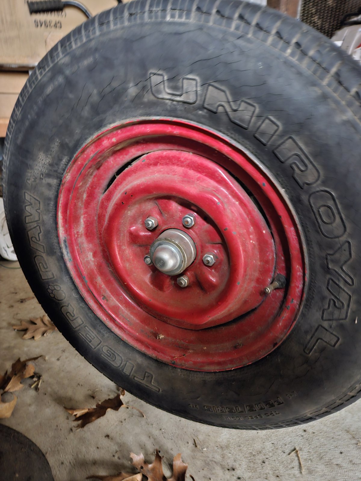

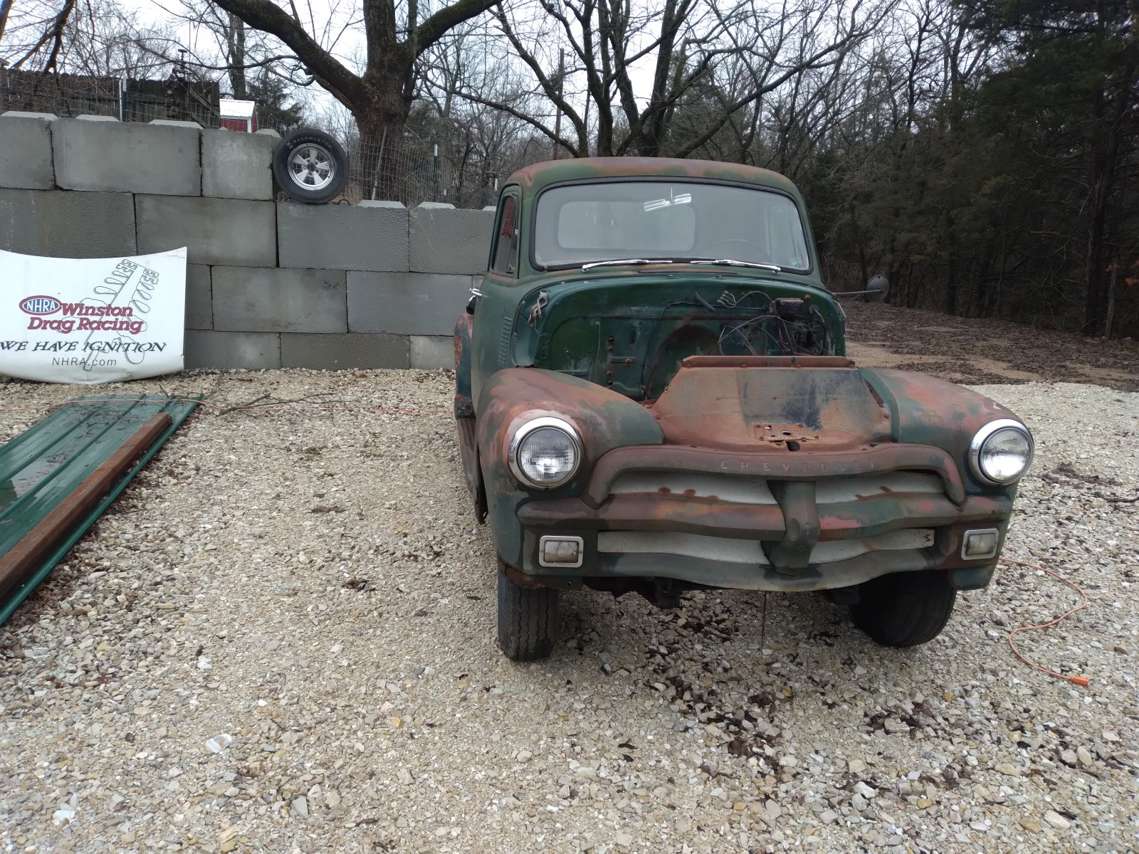

    CornCob, now you've got me confuzzed. Like Lloyd I had had a hard time finding plain steelies, but a fine gentleman here on the HAMB fixed me up with 15" stock wheels from his Nomad. Granted, the center hole is slightly larger than the disc hubs, but they fit the calipers fine. Also they don't have safety beads for tubeless radials. The center hole, if it becomes an issue can be fixed by turning up thin sleeves for the hubs. But if hotrodding was 100% risk-free, it wouldn't be hotrodding... 20240127_151327.jpg 20240127_151303.jpg

    The usual clearance problem with discs is that the outside face of the caliper hits the wheel centre.

    Yep.
    The older the wheels are most likely will not fit a disc brake set up as the inside wheel flange causes clearance issues with the disc brake caliper.
    It comes down the trial and error fit.

    My understanding from experience for GM Metric disc brakes like yours appear to be is that 14" disc brake wheels will fit, but 14" drum brake wheels will not, and any 15" will clear the caliper.
    I have 14" disc brake wheels on one right now and it's fine.
