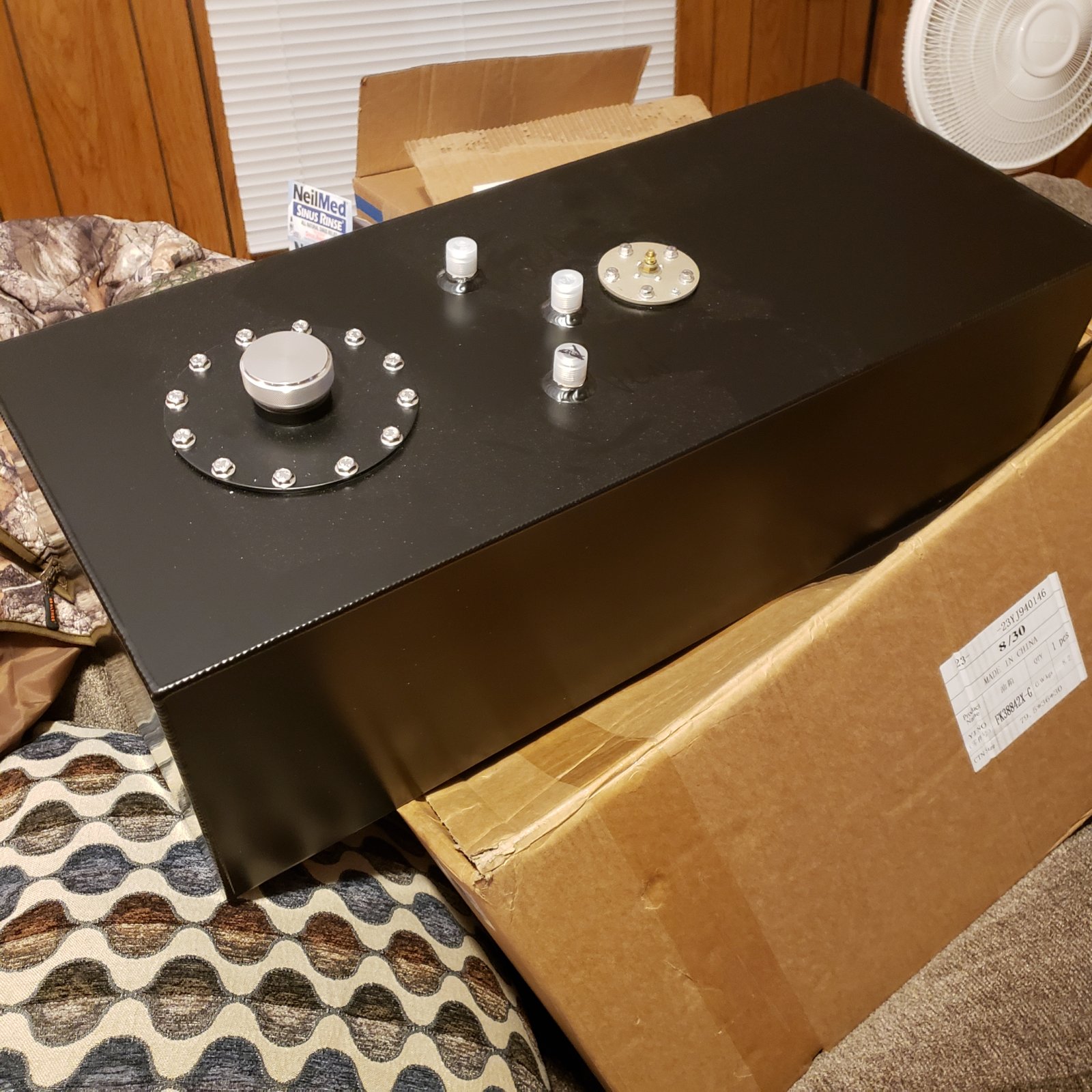

    Well I came home to a fuel tank on my porch, that's a plus. Put the new ignition switch in it this evening and wired all of that up. 20240130_210239.jpg

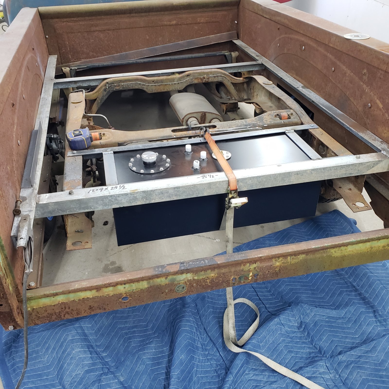

    Fabbed up some mounting shit for my gas tank today. Not mad at all with how that came out. Got a question for you guys, would you run rubber from the tank to the pump? Stainless steel braided with the nylon braid on the outside, 6AN. Or is that unacceptable? Not gonna be inspected for NHRA competition or anything like that lol. 20240203_151032.jpg 20240203_153448.jpg 20240203_161846.jpg

    -6 Push Lok AN fitting's and the rubber hose to go with it. :cool: Everything's lookin' good Brother!:D

    I run SS hard line to within a foot of the tank and then make flex lines out of that nylon covered 6AN stuff for the connection. I doubt it matter dude. Because it is "out of sight, out of mind" I wouldn't scrimp there. But that is just me.

    I normally run hard line front to back, like you. But I have the fittings for the tank and they're pushlock 6AN, one of my buddy's was at the shop today and asked why I don't just run braided line. I replied with the whole "nhra only allows 18" of rubber in the system Yada Yada Yada" to which he asked "you planning on an NHRA tech inspection?" Lol... I'm good with running one solid braided rubber line, less connections!

    I don't plan to race everything I build but those rules make sense for good reason.

    I always thought the NHRA was talking about regular, parts house, rubber fuel hose, not braided hose.:confused:

    Braided hose is worse in my opinion. You can't see the cracked rubber hose inside. Looks all pretty on top, hidden danger underneath. That's why hard line is the go to product. As little flex line as possible, no matter what it is covered in.

    I have no idea man. Still rubber I guess. I ordered the 6AN hose. First time I've done it this way lol. I got the frame clamps and everything. Cross your/my fingers haha!
