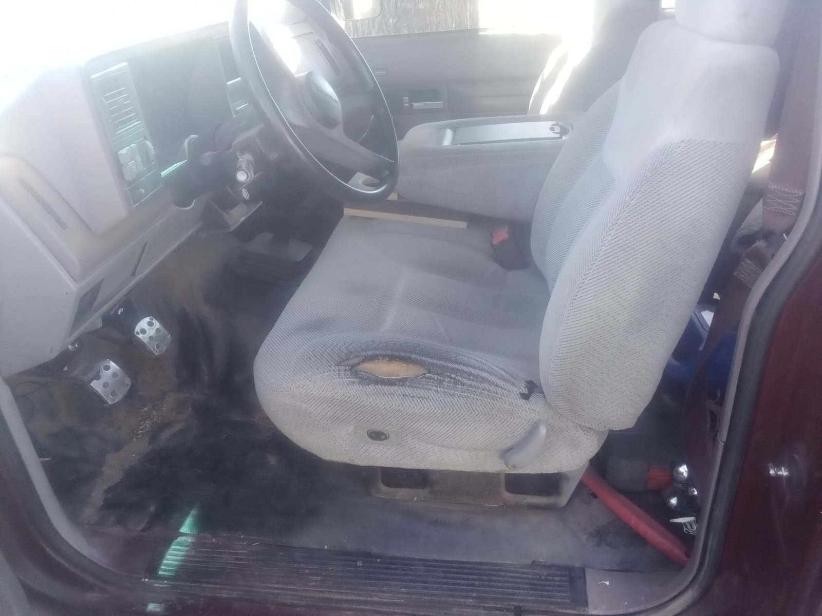

    That's the one! they also had a 60/40 split bench if someone found that more desirable, and similar looking buckets.
    Bill's Auto Works likes this.
  2. I like those seats but they are a royal pain in the *** to recover because they are molded. If I could find a black one I'd roll with it :D
  3. These are the newer-ish Chevy pickup transplants that came already in my '50 AD panel truck. I'm gradually s****ing off a lot of the "street rod" influences on it, but I think I'll keep the seats,........ partly because I like the built-in seat belts. In my case, I like being able to step through to the cargo area. I might reposition each seat outboard an additional 1/2" so I'll have an inch more in between for my big feet.
  4. 05snopro440
    Joined: Mar 15, 2011
    Posts: 3,480
    05snopro440
    Molded as in the foam is molded? Just curious, I know little about upholstery.

    Being in the business, how hard would it be to re-foam the carc*** and make a traditional cover for it?

    Can't you just go right over the factory material to avoid the struggle ?

    I've had all 3 styles in it, the 60/40 and the fold down armrest models (armrest set up like 60/40) make you sit a bit left of the steering wheel since it's a contoured foam design, the early models of the bench were the flattest, this bench is an 89.

    I use the 88-98 seats in all the 55 -72 trucks I build, and yes the upholstery shops dont like em because they say they have to peel the fabric off the foam.

  10. The pattern is in the foam, I've never been to the factory and seen them made, but it's all heat formed and the cover is glued to the foam. When you try to pull the material off it'll tear the foam up. You can recover them, 1/2" sew foam will absorb some of the pattern, but not all.

  13. That's how we did them back when we had S&S Automotive. Glue a piece of 1/2" sew foam down, then use 1/2" on your covers. It works decent

    for the 88-98 style, if you find a cheaper version truck that has vinyl covering they don’t have the formed foam. Much easier to upholster. Also, stay away from the ‘95 -98 style as that foam is contoured to your body and doesn’t line up well with the steering wheel on the 47-54 style trucks.
