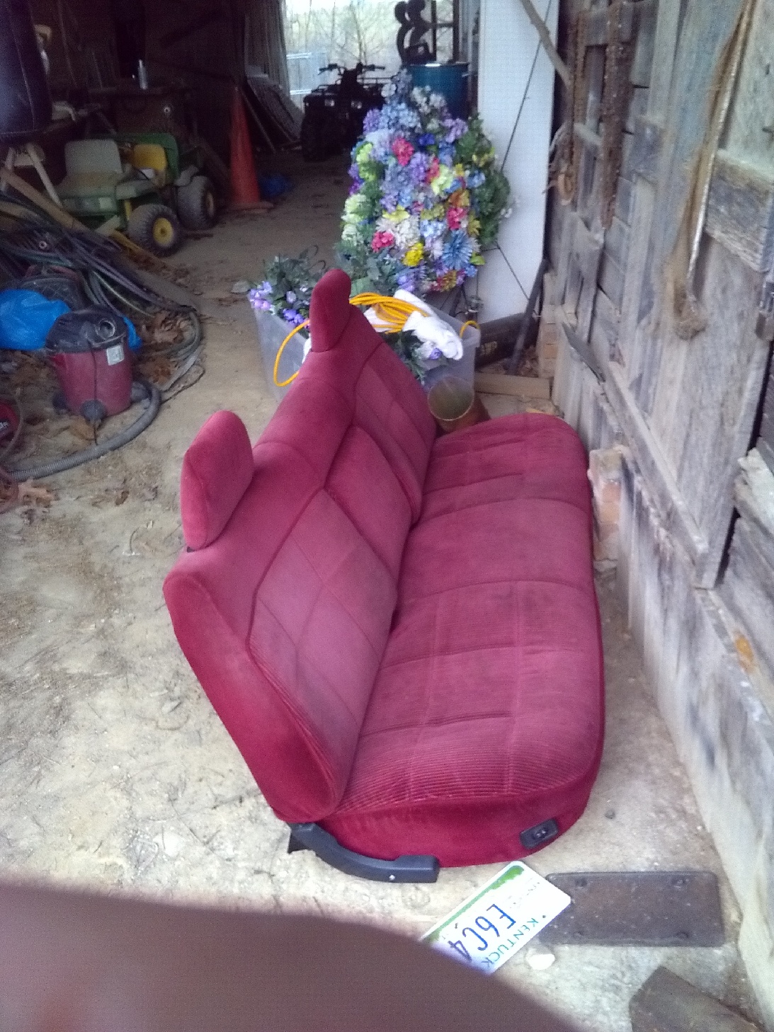

  3. Those seats look like they were rescued from the private party room at the local topless bar. Don't be shining the black light on them!

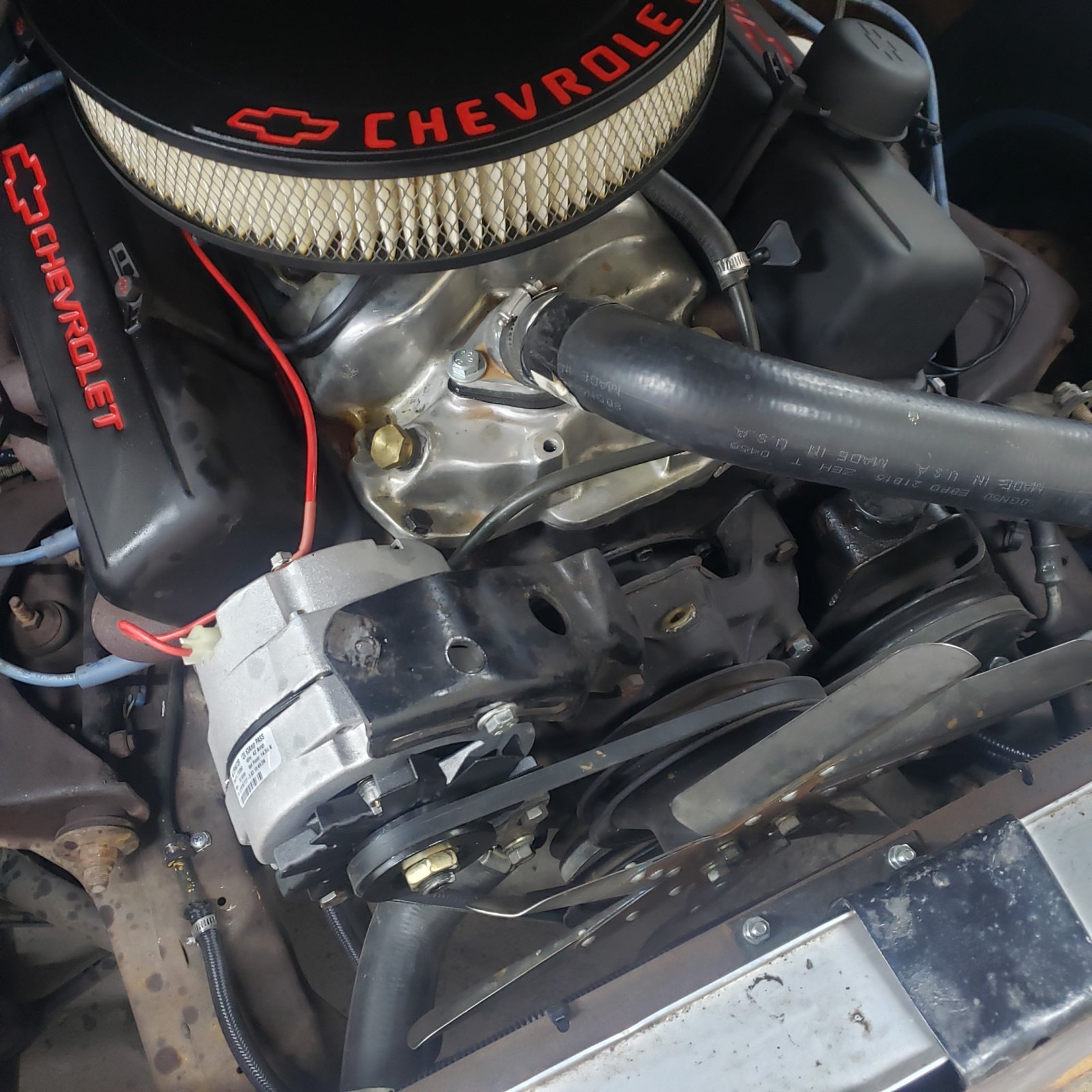

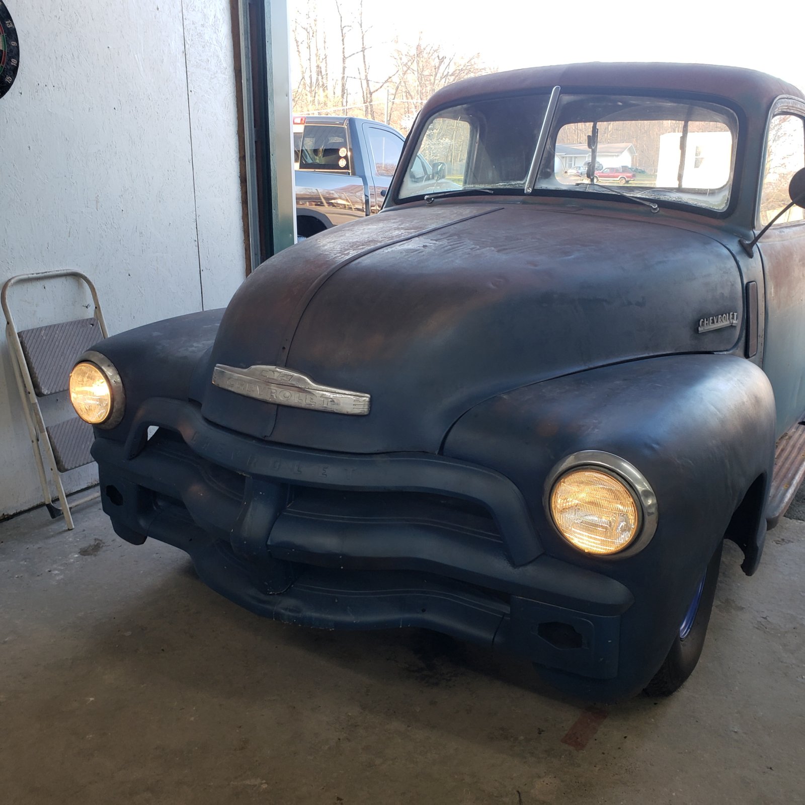

    Worked on my truck a little today. Door glass installed, gotta pull it back out though, the front "roller" on both regulators is wore out, gotta make some new ones. Got the power steering done, I've gotta say, that's really nice! All of the lights are done, well, except those front park lights, I've gotta get something to stick in those holes, or fill them. The Holley on this thing is the one that was stopped up on my El camino, I've gotta pull it apart and soak it. Getting closer. There's a cruise in a couple of weeks, about 5 miles from the shop, I'm gonna try to drive it down there. 20240328_190552.jpg

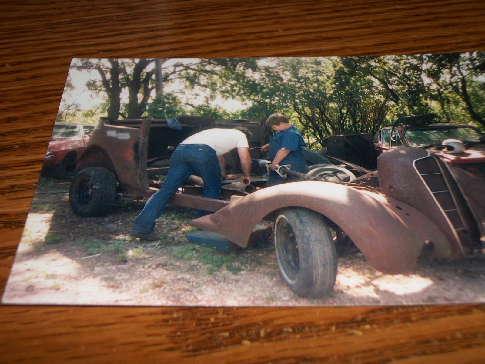

    Untested old car? My 1st ever major rebuild took this pile and turned it into a car with a full roof (that is me and my son that just turned 41 a few weeks ago). 100_0790.JPG
    The first real drive (more then around the block) out of the shop required a roadside radiator replacement (the 1st rad had a mouse nest in it that made its presence known when it blew open the top radiator tank as soon as the motor reached operating temp). That was about 2 miles from the shop. Then (about an hour later with another used rad) the still really rough car went to a local cruise in. Then I drove it 10 miles home. The next morning the car went on a 400 mile one way road trip to Back To The 50s in MN and than back home. There were a few quick road fixes along the way (like tightening the axle to leaf spring U bolts I somehow missed doing, and chasing an oil leak that was blowing oil onto the passenger side windshield). We made it home alive.
    First road trips can be exciting!

    Rebuilt the carburetor, because this is the one that was on the El Camino and had the crud in it, never could get it right. I took it apart, soaked it in the Berryman's bucket for about 2 hours, blew it all out, put it back together with 66 jets and a black spring on the secondaries. Stick a 35 accelerator pump nozzle in it also. Runs good from what I can tell. It's now charging, all of the glass is done, bed floor is done, exhaust Hangers are done, got a couple of little things left, oh and the trans cover, avoiding that as much as possible lmao! Gonna get plates and insurance first of the week, and take it to the cruise in on Friday if it's not raining, or blue dick cold..... 20240406_191222.jpg 20240406_195217.jpg 20240406_195236.jpg 20240406_200406.jpg 20240406_200527.jpg

    Every time I look at a picture, I realize I need different valve covers and an air cleaner, those make me nauseous lol
