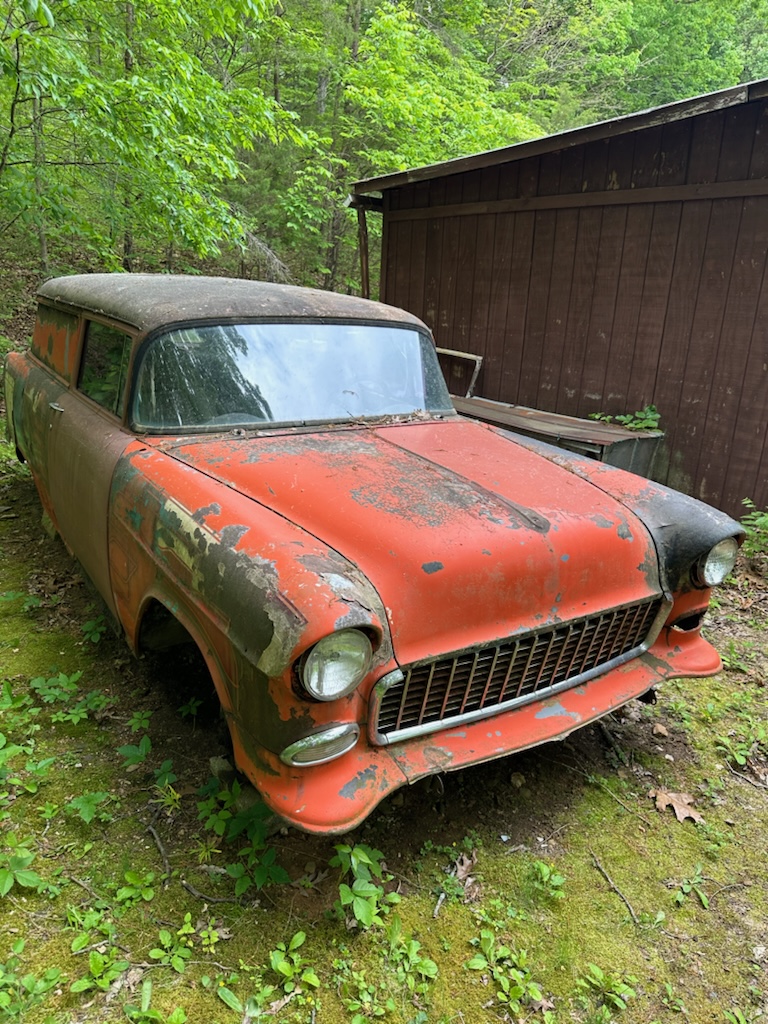

    Hmmmmm..... might have found my new gasser project :cool: gonna take a short drive this coming Saturday. IMG_0350.jpg IMG_0349.jpg

  11. I’ve got fingers and toes crossed for you Brother!!
  12. Budget36
    Joined: Nov 29, 2014
    Posts: 15,013
    Budget36
    That looks like fun. Good luck getting it!
  13. Doesn’t even need paint
    lucky

    My buddy, state trooper, found it while he was patrolling back roads. Old dude around 80 years old has a pretty good stash. Said the wagon was a drag car years ago. Me and my buddy are going over there Saturday. The old custom paint on it just tickles the shit out of me :D

    Yea, that paint job was killer. :cool:
