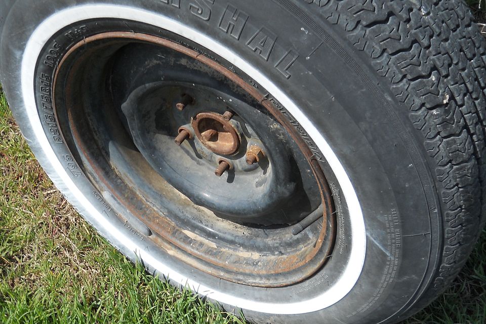

    Got me a set of steel wheels, 5 on 5 for $100 :D cleaned the others up and had my buddy put em on marketplace. IMG_2419.jpg

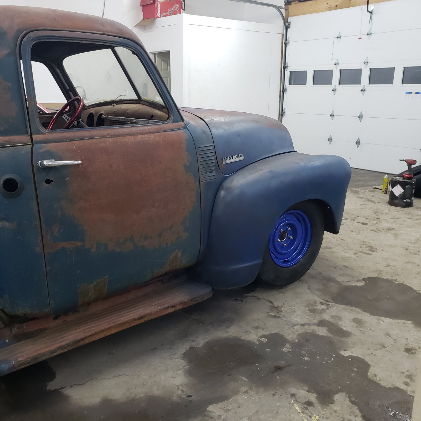

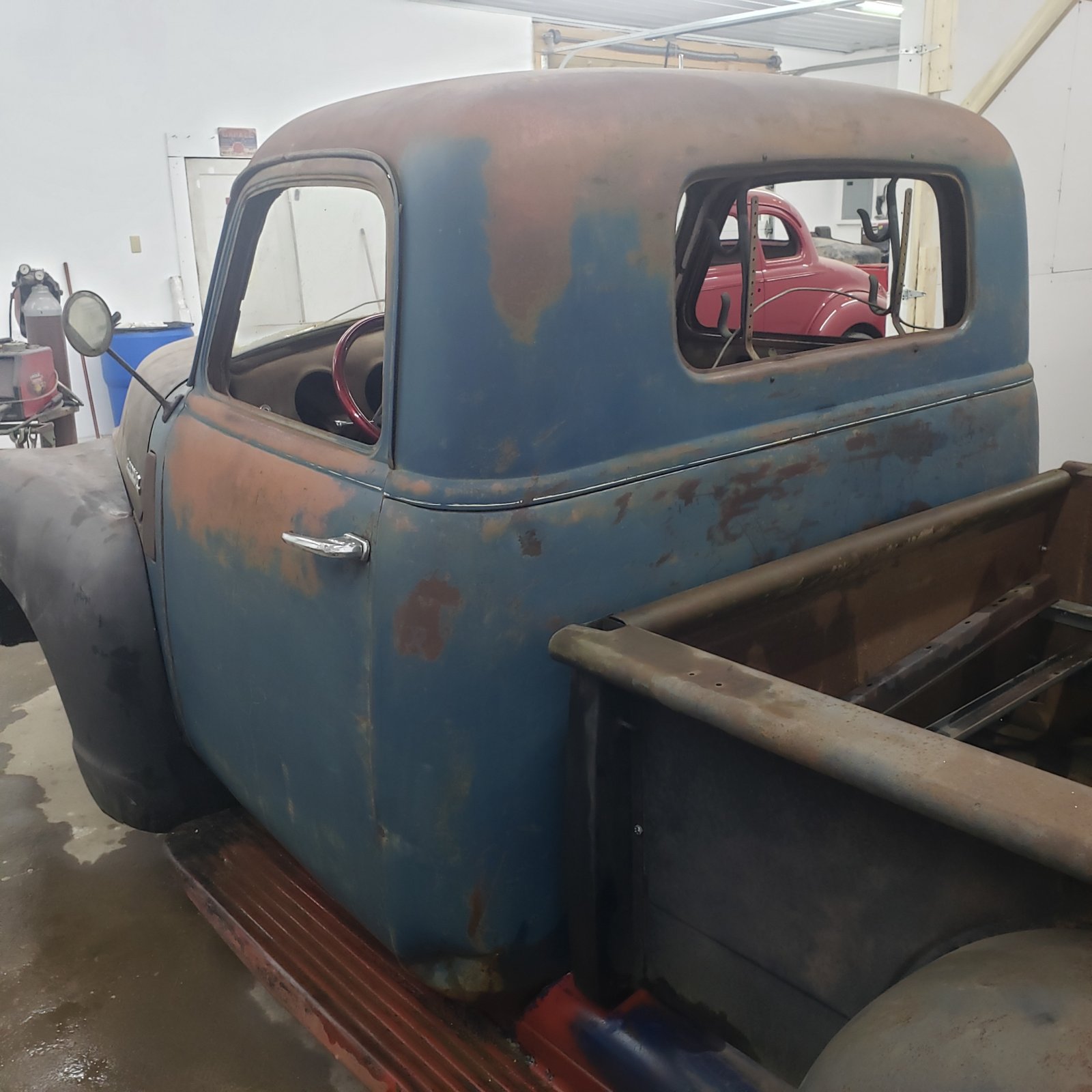

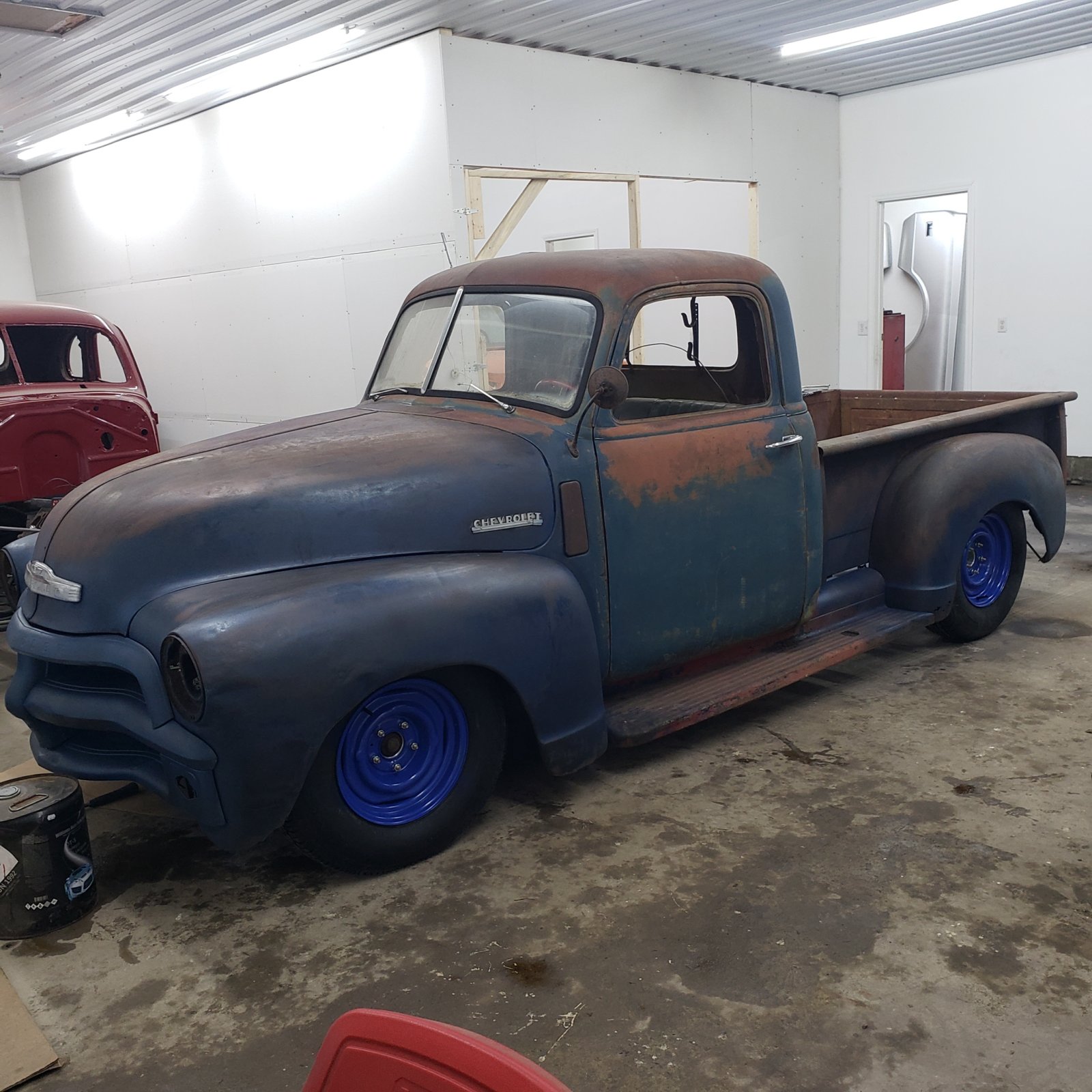

    Went from white and rusty to stripped on the wheels. Ordered tires from ebay, says they might be here this weekend. All long i thought the cab was green! Turns out it's blue lol put new rear calipers on it, lumpy was dead on with his info. 20240124_143316.jpg 20240124_143427.jpg 20240124_144805.jpg 20240124_160249.jpg

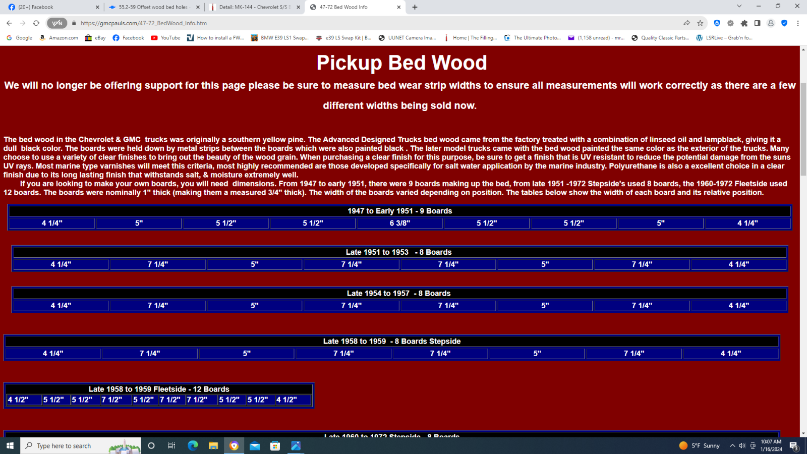

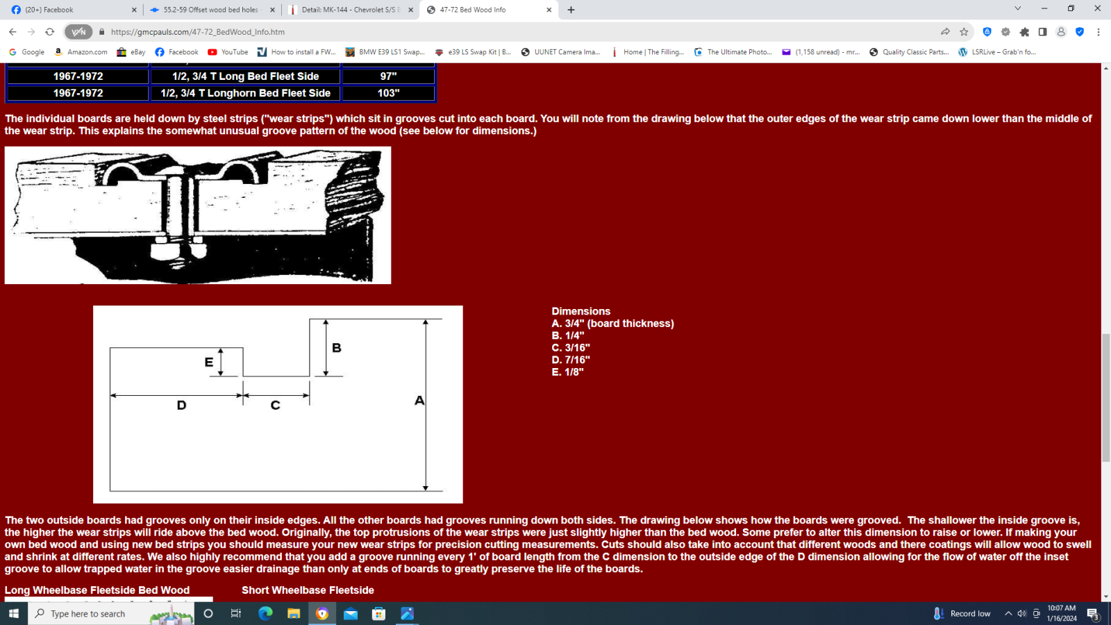

    You probably have them but here are the dimensions to cut the boards if you want original size boards, It also shows how to cut the grooves for the factory style bed strips. Stock bedwood was Southern Yellow pine. Screenshot (753).png Screenshot (752).png Screenshot (752).png
