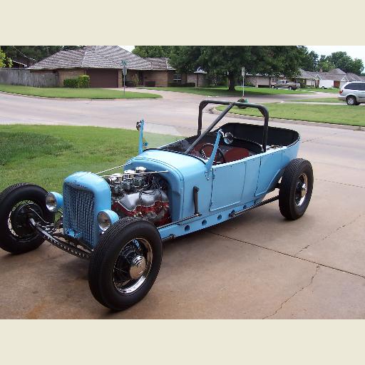

    After visiting with Carl aka MoKanMan we decided Carl would sleep better if I showed up with a little protection, and I don't mean condoms here!
    Not quite finished with this little Saturday project but thought it was turning out OK. Wife thinks it is a hell of a good idea too Carl.

    how'd ya mount that thing?

    It's a bolt in. The hoop is welded to a flat plate that goes from sub rail to subrail. Angle brace has a square plate welded to the end.
    Stil have to drill the holes and bolt it down in the pic.
    Wish your hairy butt was gonna be there dude!

    looks like your brain pan will be well protected dude. well done

    Fiddy, here is a pic out of the car. You can see the mounting plates. They will be plated on the other side of the floor as well.

    that aint half bad man... i dig it
