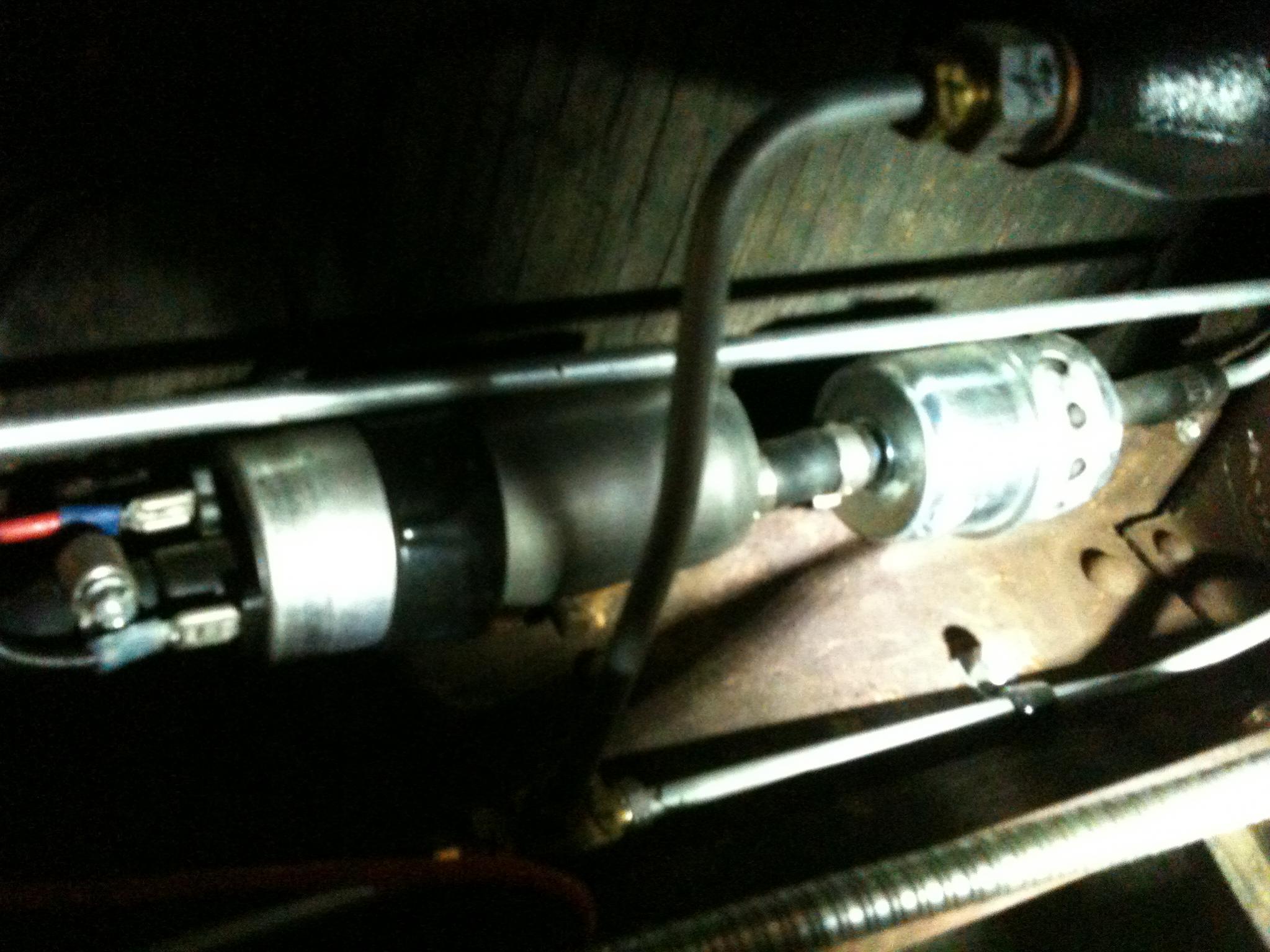

    i'm working on a Model A ch***is with an A motor with B head. Nothing fancy, just simple stuff. but, i'm using a 26 roadster body, so i don't have the benefit of gravity feed fuel.
    so i'm wondering what you guys recommend for a fuel pump to get it from the tank (probably in the trunk) to the carb. i'll be using a single downdraft carb.
    thanks,
    mark

    Well, on mine, I used this carter low pressure pump;
    http://macsautoparts.com/model-a-fo...sure-efp-9350-6/camid/MDA/cp/JS0R3CHL1137085/
    Then I had to use a holley low pressure regulator to get down to 1.5 PSI
    Worked for me...

    i was looking at that pump and wondered if it would do the job. i'll look into the low pressure regulator.
    where did you put the filter?

    When it arrived, it was put together as an ***embly. The filter was attached to the end of the pump with 1 1/2" of fuel hose, sweged on. So, when together, the entire ***embly was "****** in-****** out".:eek::D
    Fit nicely within the confines of the frame rail. No time for photo now but will do later today.
  29. crminal
    Joined: Jun 6, 2010
    Posts: 1,941
    crminal
    Okay, not the best but this gives you an idea....;)
    One ****py thing is that it only came with one mounting clamp for the pump itself. Had to make a hokey one out plumbers tape for the filter part.
