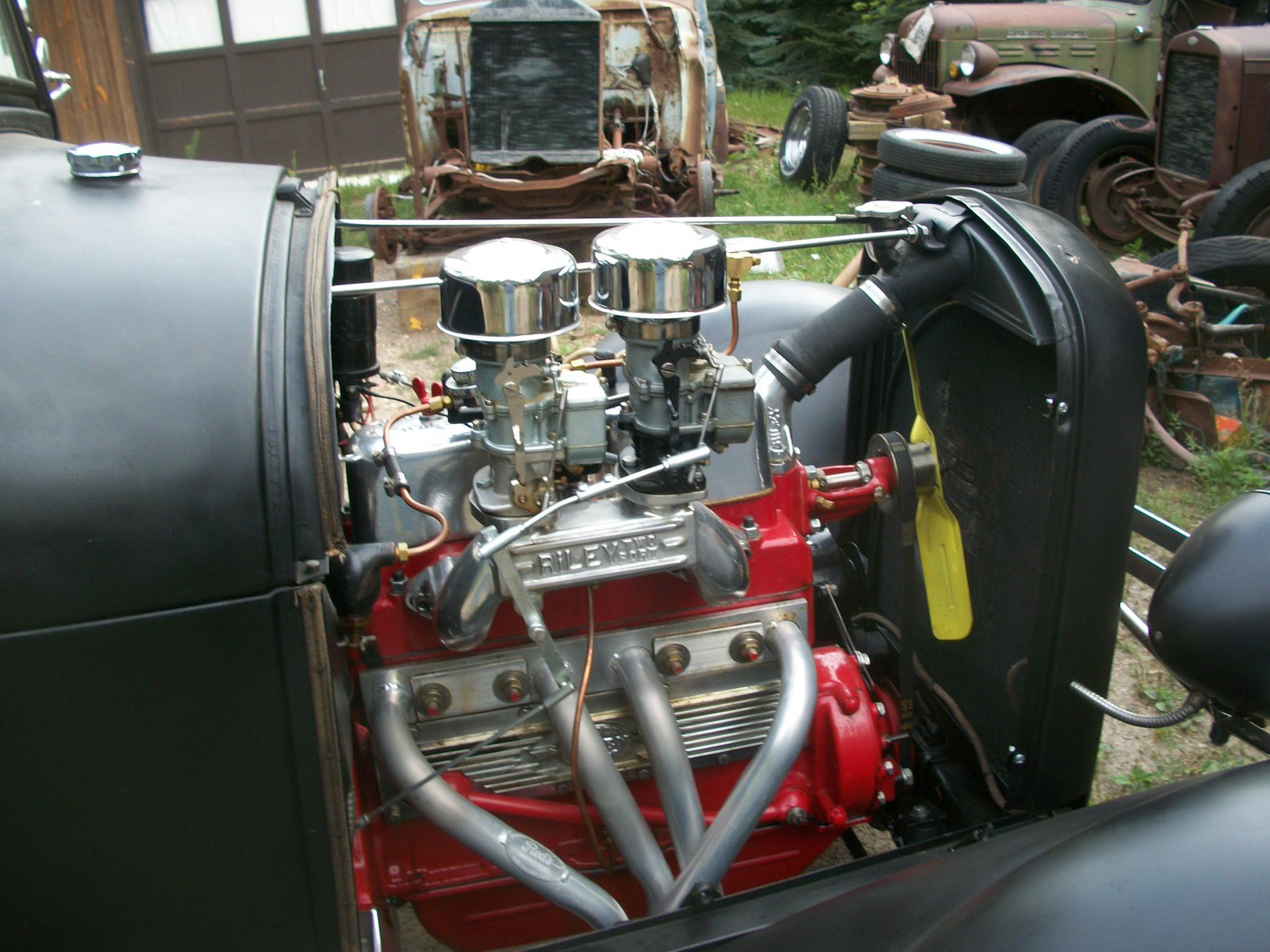

  2. I run dual BB's on my Riley 2 port, really can't see any difference between S's or SR's as far as acceleration. The 2 port ran 84 at the Antique Nationals. I now have a pair of BB's on my Winfield flathead, 230 CI planning to go to C's on that engine. Winfield flat head with the BB's ran 82 at the 2010 Nationals. Intake ports are 1 5/8", to me big is not better, whole system needs to be balanced

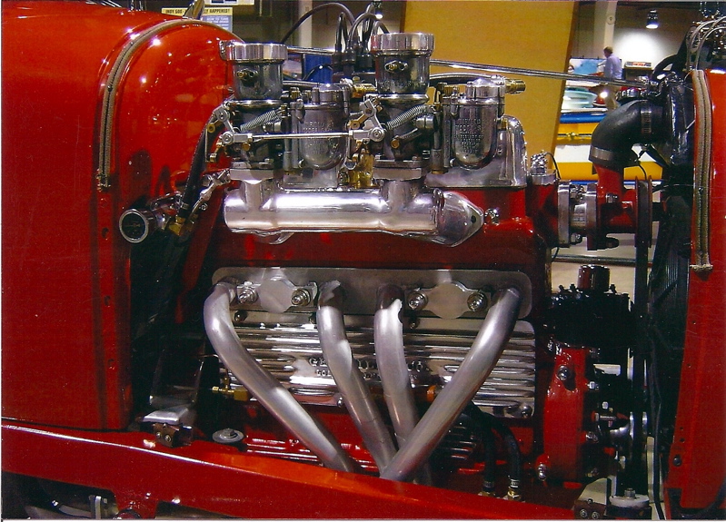

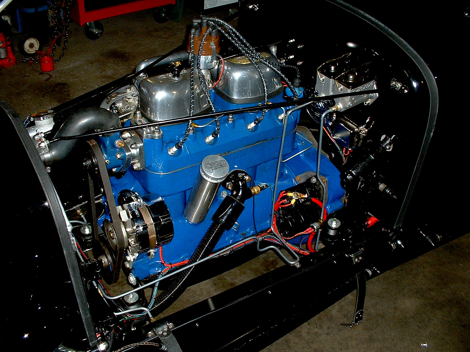

    Just plain bill a couple of great looking engines there I think with our motors good presentation is what sells a well built banger.
  6. Actually posted those for Hapydz as he asked about the carburetors!

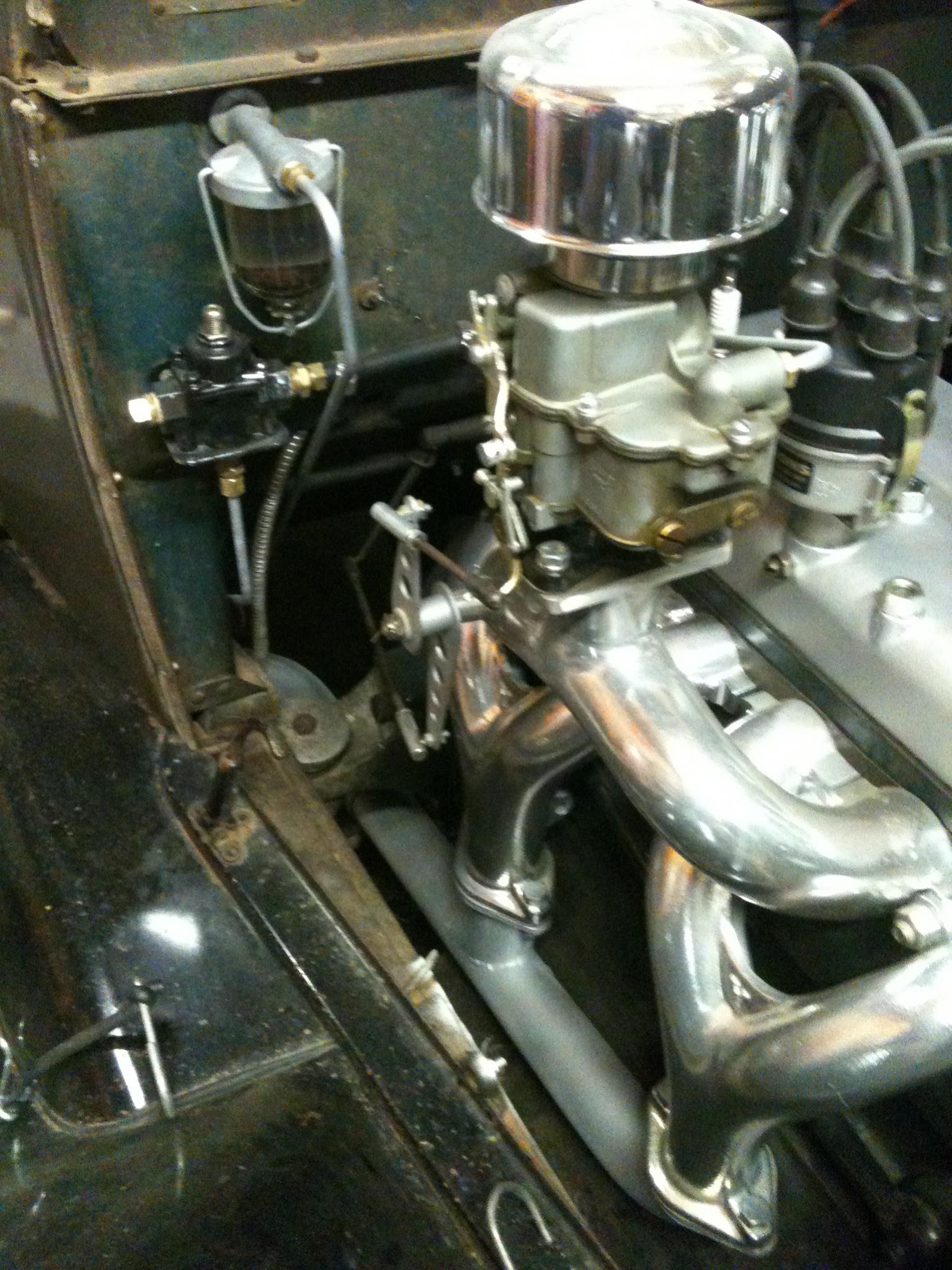

    Exactly. Fuel bowl to pump (mounted to ch***is under floor) then back to regulator then to carb.
    Sumtin' like this...
  8. Everything is exposed, got a 1/2 coffee can of bends that didn't work! Left the stock filter/screen in line. Regulator mounted to fuel tank bolt. Short length of injection hose between carburetors and regulator as vibration dampener.

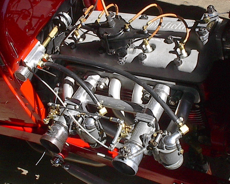

    Here is a shot I took today of the "B"s far side. Need to do a bit of paint touch up but barring any unforeseen cir***stance next week in Mn., I think I'm done. I will post a picture of the more interesting, other side tomorrow. It's running much better now thanks to Jimski and all of the other Bangermeisters that have helped !!!

  20. crminal
    Joined: Jun 6, 2010
    Posts: 1,941
    crminal
    She's a beauty! Nice work.

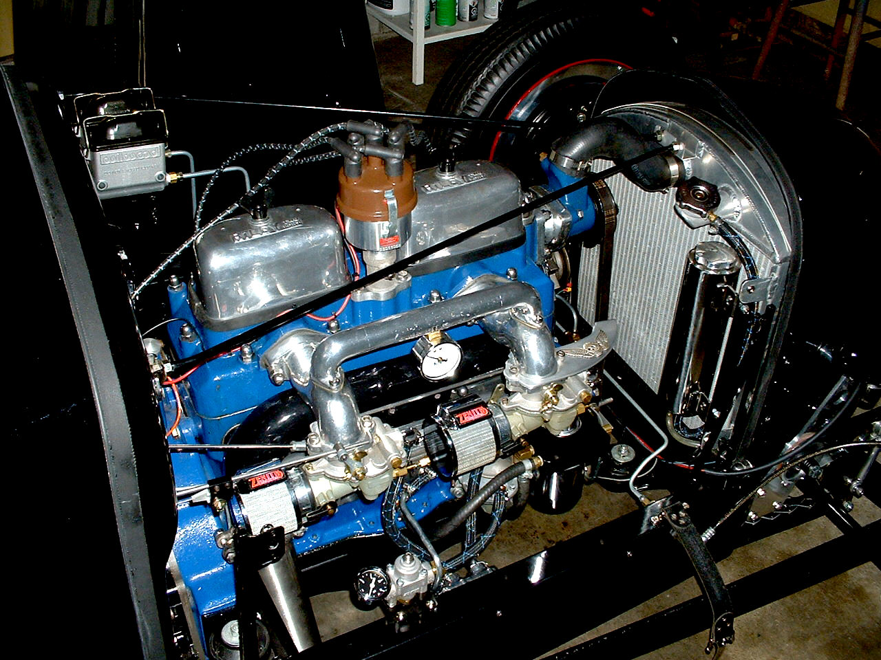

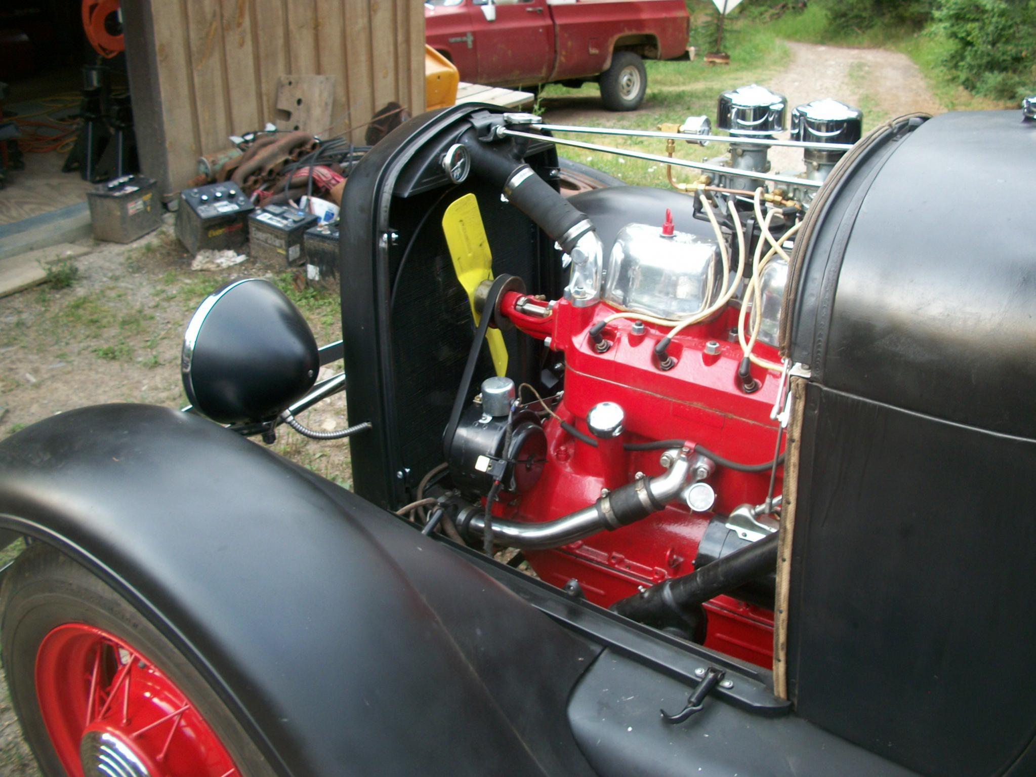

    Here is my engine. Looks like we went different directions on generators and cooling. I just installed the power house generator the other day. I have a Stromberger 81 for the primary carburetor and a 97 for the secondary. The progressive linkage and the spark advance took a few days and a lot of trial and error. It is running good today. The dog has to ride in the front seat and it is a little crowded. He has lost about 30 pounds and now weighs 193. I try to keep him and the wife both under 200 pounds. Just kidding about the wife.

    And a shot of the interesting, near side . The good thing about next weekend in Mn. is that my engine builder and very good friend, Bob Baas from Alexandria, Mn will be there so he will be able to check the tune of the Super "B", as he hasn't seen it since the roadster was finished, if in fact it is finished :eek:.

    STURGIS39
    Have any better pictures of the linkage you used , I am running twin 81's and not sure how to set up a progress linkage mine work together
    Also any one running a Moon style tank in a pickup I setting one up w but wanted a gauge , still running 6 volt

  27. I like both sides of your engine. I had a fan break and it hit the radiator pretty hard. The radiator did not leak. I ran it without a fan and there were no heating problems. I bought a good radiator from Br*** Works and I was in a small depression after the fan placed a battle scare on the radiator.

    I will try to post some picture tomorrow. The carbs have a long throttle shafts and the progress linkage is between the carbs and distributor. The arm on the front carb is twice as long as the one on the second carb. I bought the rods from the local hardware store along with the shaft collars.
    I went through a lot of rods. I bought some parts from Speedway and The Secretes of Speed. I built some lever arms from 3/8 square bar and drilled a bunch of holes in them. The end that fits on the throttle shaft was slit and a hole was drilled for a screw to tighten the lever arm to the throttle shaft. I messed around with this for a long time. I ended up buying a progressive linkage kit from Secrets of Speed. I think it was about $100 but the lever arms look like small piston rods. The second carb does not start to open until the first is half way open and then they open both until they hit the stops on the carbs.
