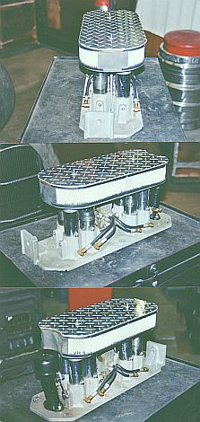

  2. Please excuse the mess, this cleaner I made from the air cleaner cap from a gardner Denver screw compressor.

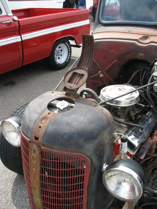

    It is from the 65 GMC I traded to get the 42

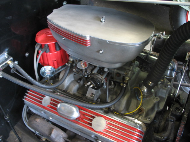

    Cheap Ebay dual quad A/C.
    Bead blasted and adapted to 3 deuces about 70 bucks as seen here. The Ford repos are a lot more. The lump on the front is an aluminum winged Mercury head logo that will be epoxied on. It could get some heads scratchin' and I'll have the only one.:D

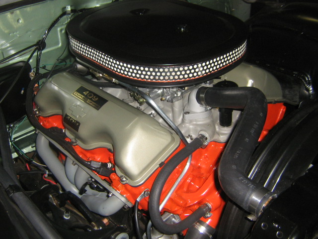

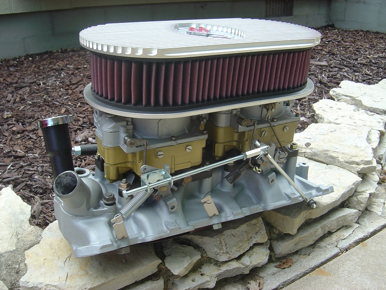

    Here is my Mopar air cleaner adapted to fit my dual quad 409......couldnt afford the mortage payment for the repro factory unit.

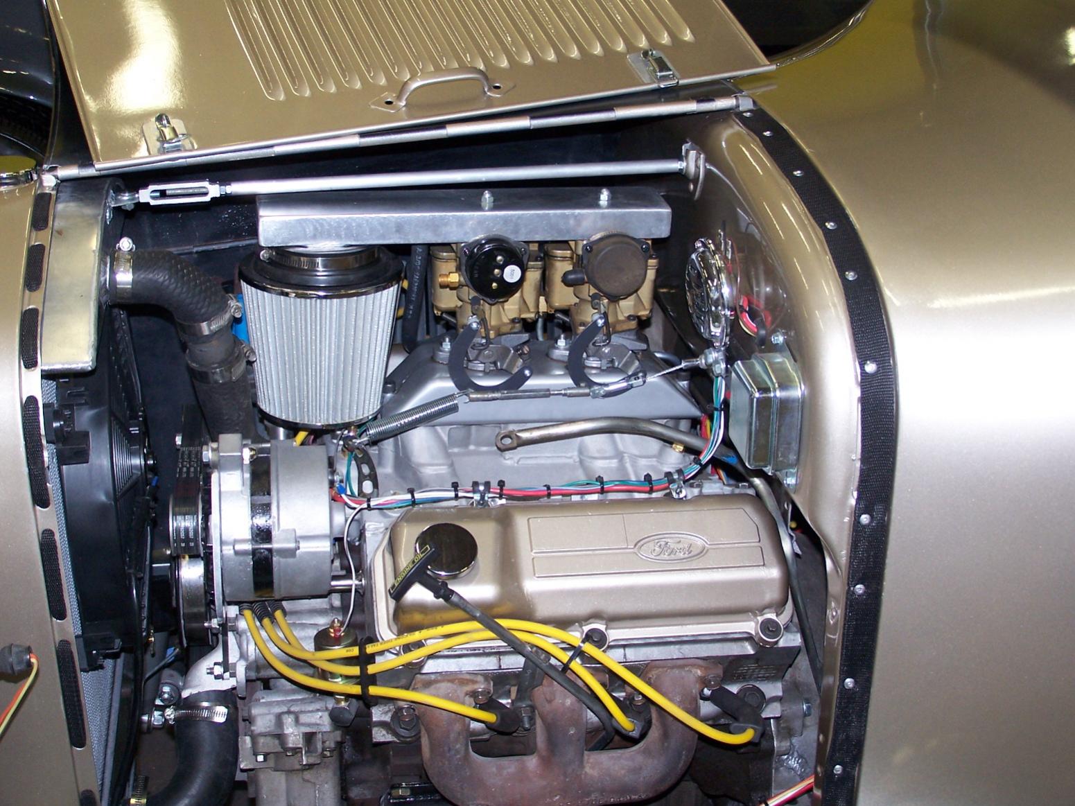

    This is the one I made for my injected Ford Zetec 4 banger.

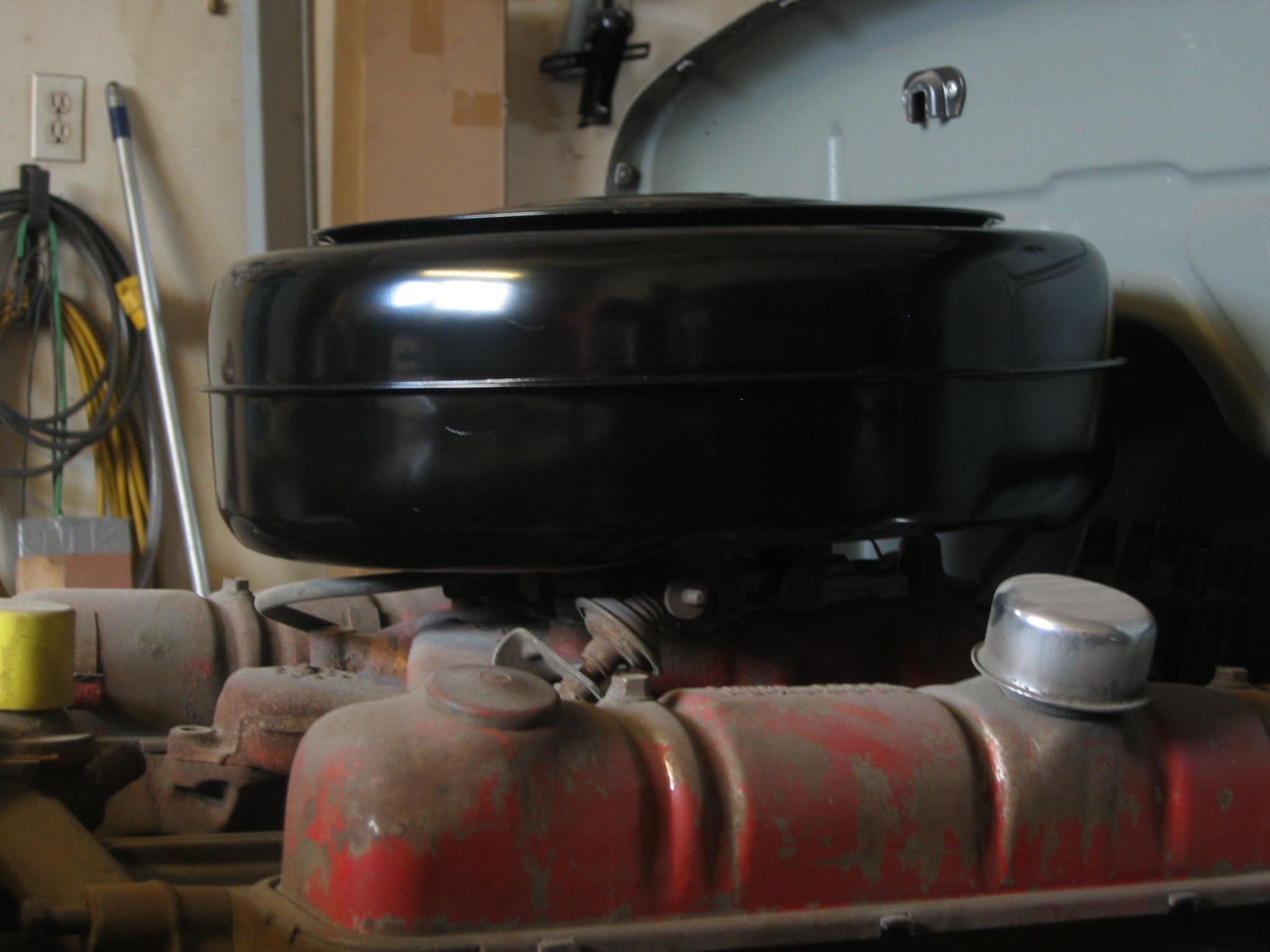

    I went the flip side on air cleaners that got thrown away like exhaust manifolds. Discovered there where harder to find than i thought and they want real money for them now. Just a stock early 60's ford cleaner. Adding another snorkel and i'm done.

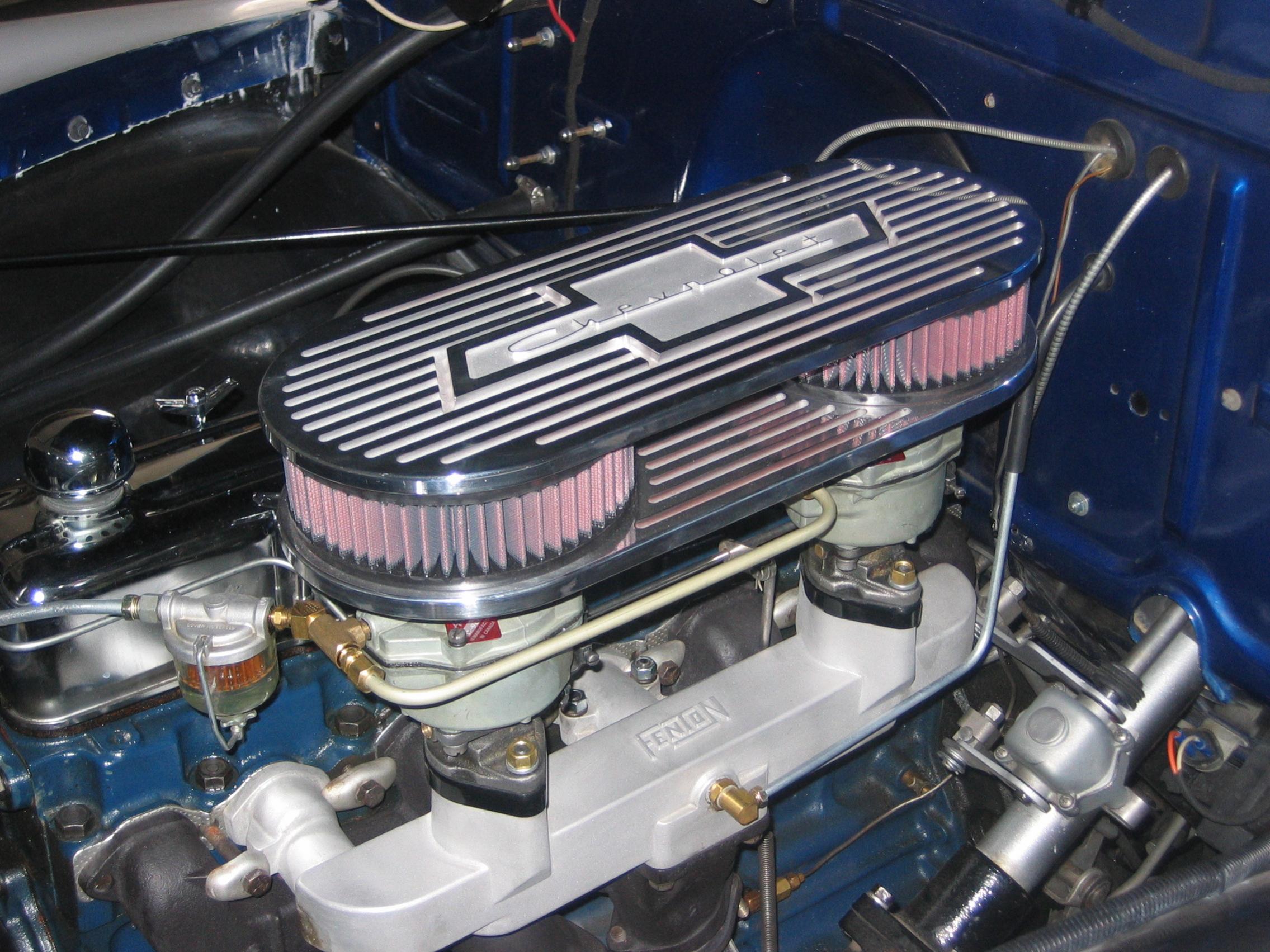

    I made one for my 235 to mate with a Fenton intake.

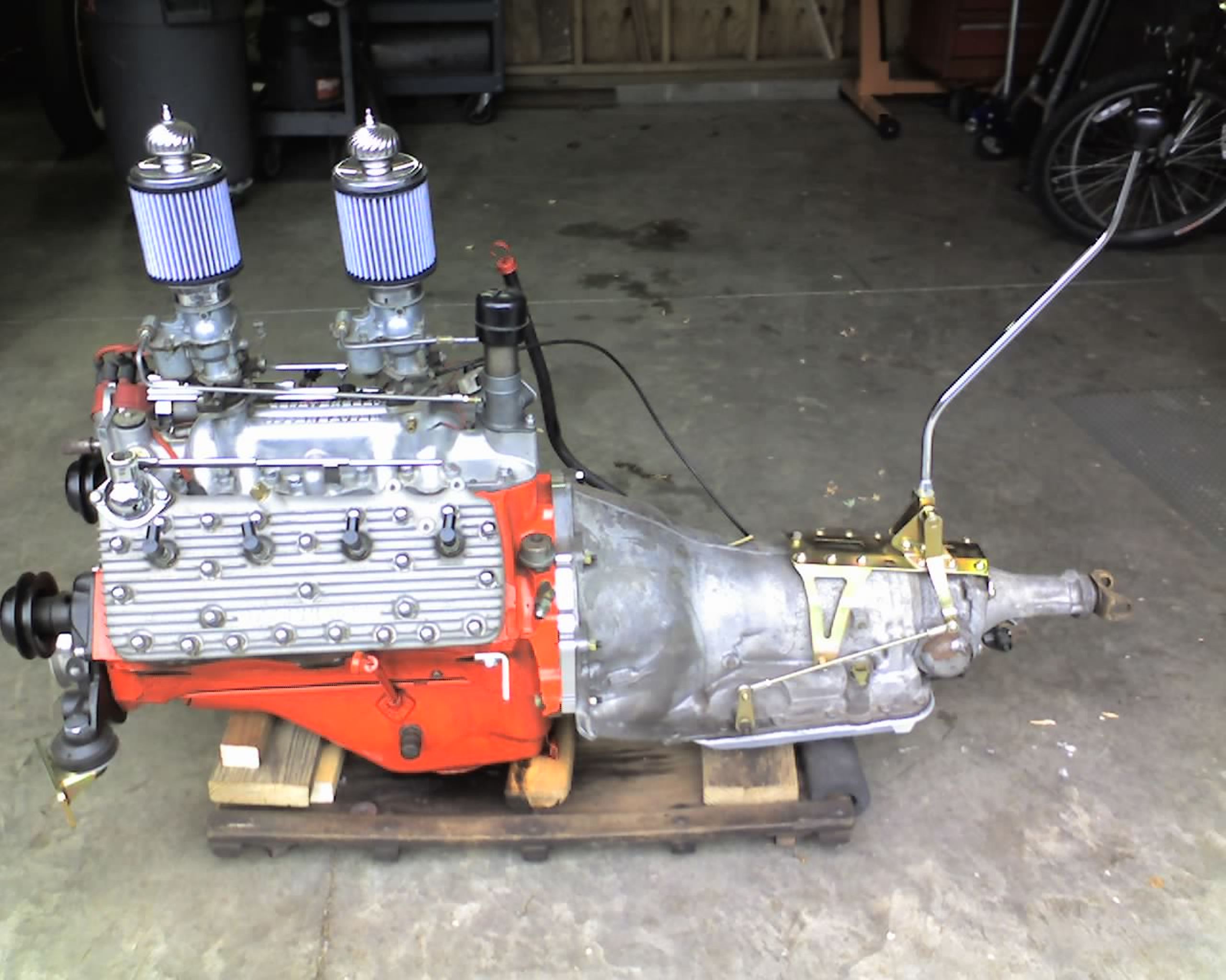

    here's some tall ones...since the center bolt is 1/4-20, I found some curtain-rod finials at the local bed/bath store to top them off....never gonna see another set like THESE

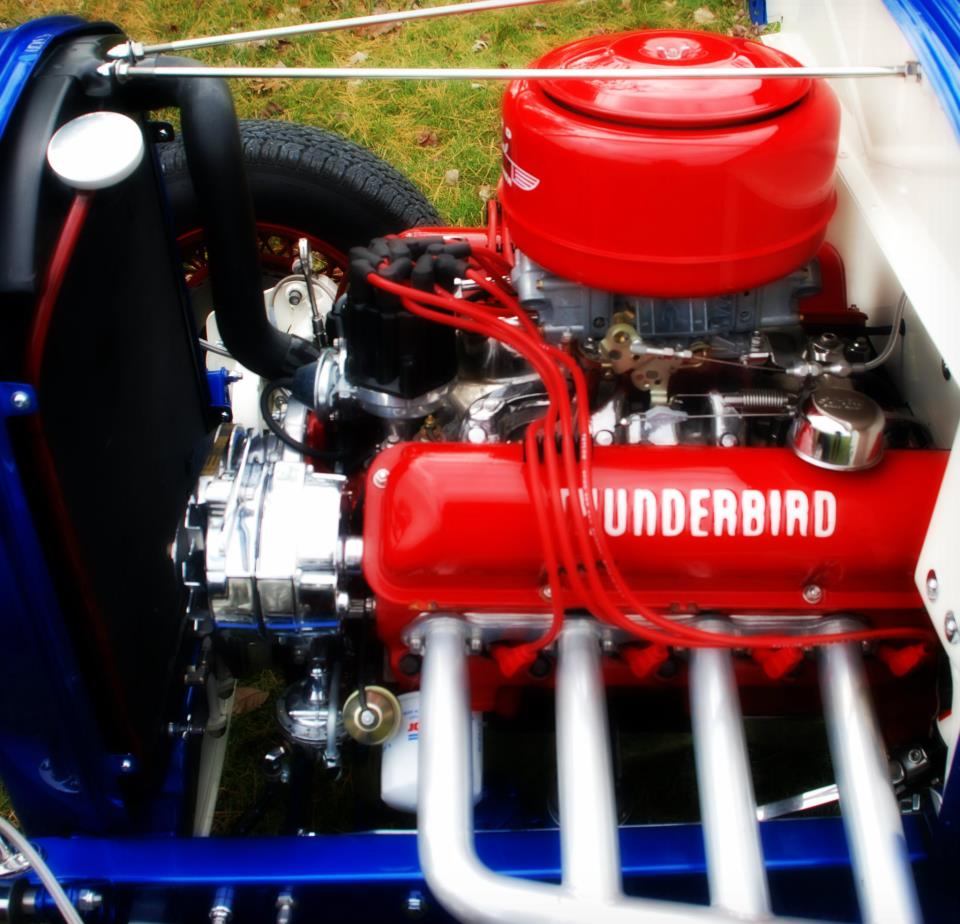

    Modified for a single AFB, I like the look

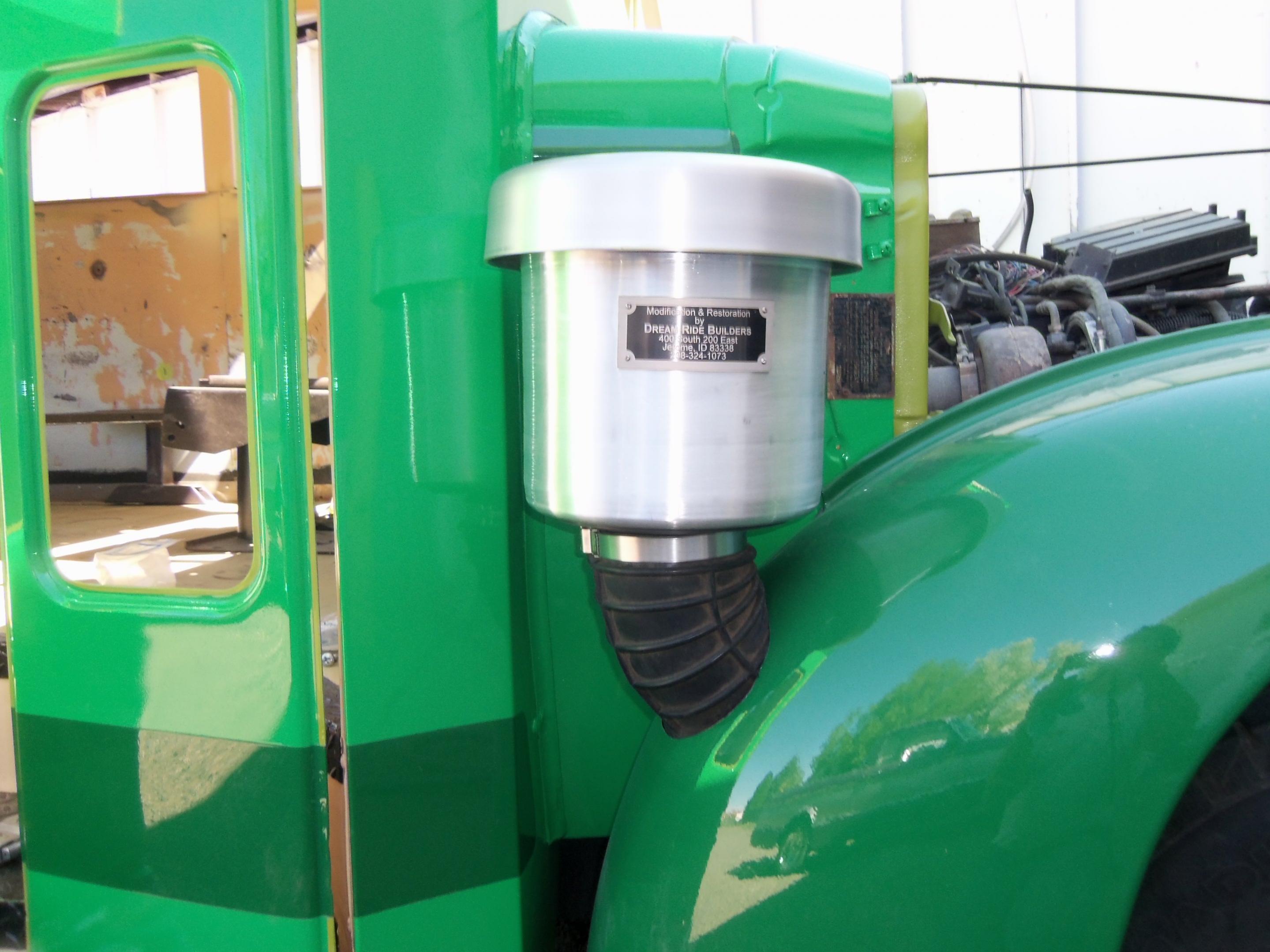

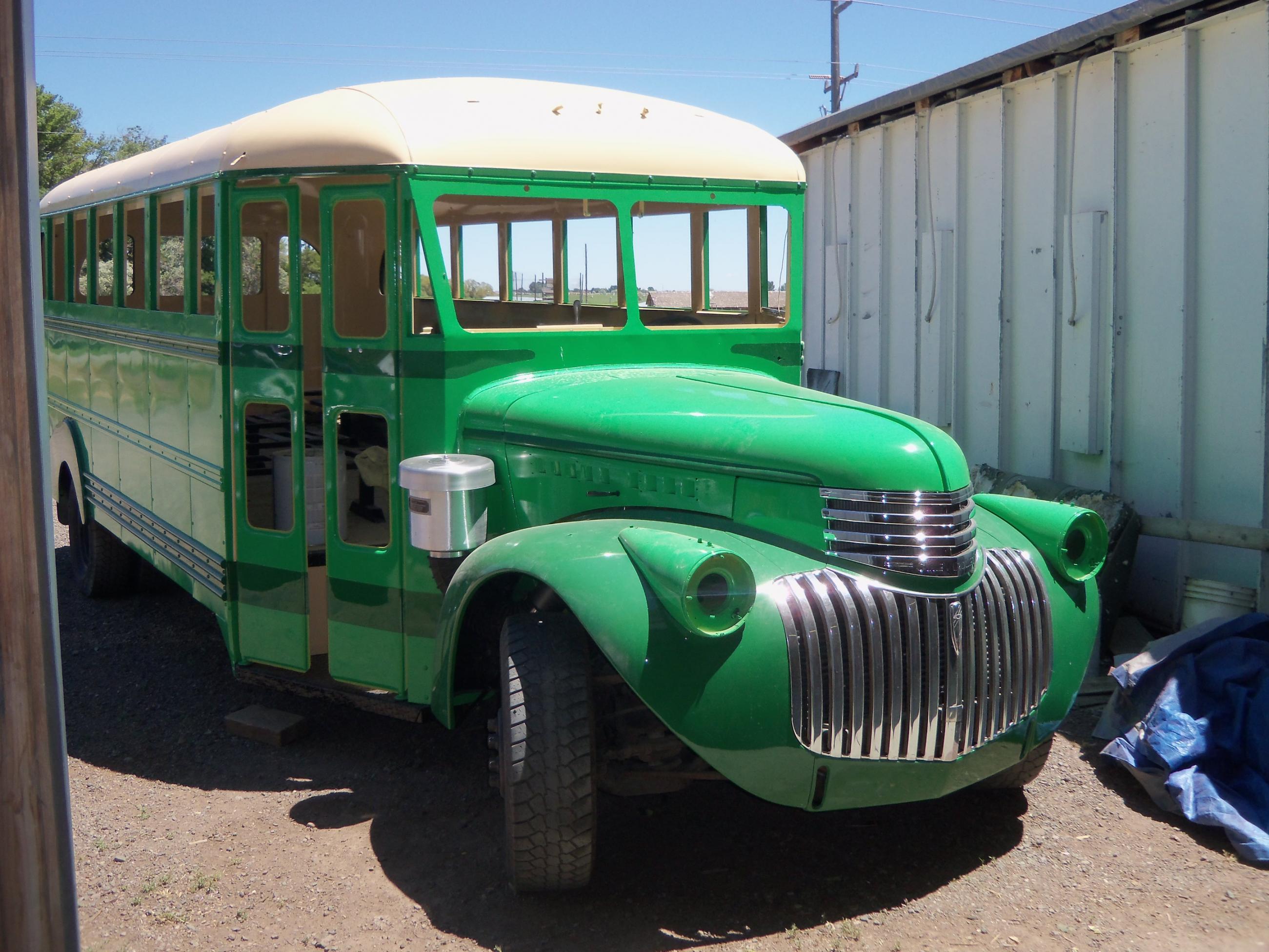

    45 Chevy bus with ***mins desiel, no room for air filter under hood. Made filter housing from a aluminum cooking pot(base) and fry pan(top)

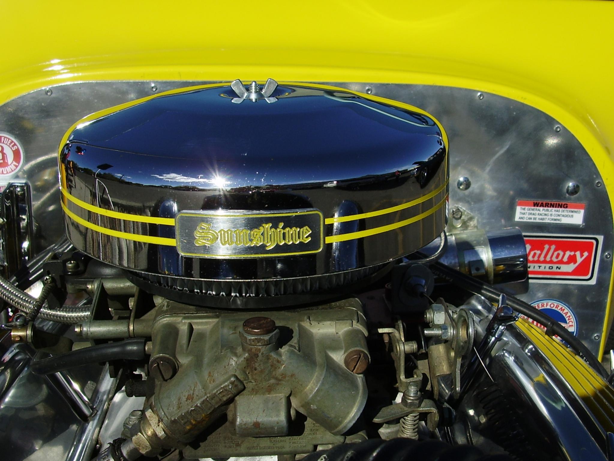

    20 years ago I made one from an aluminum pizza pan, polished up nice.

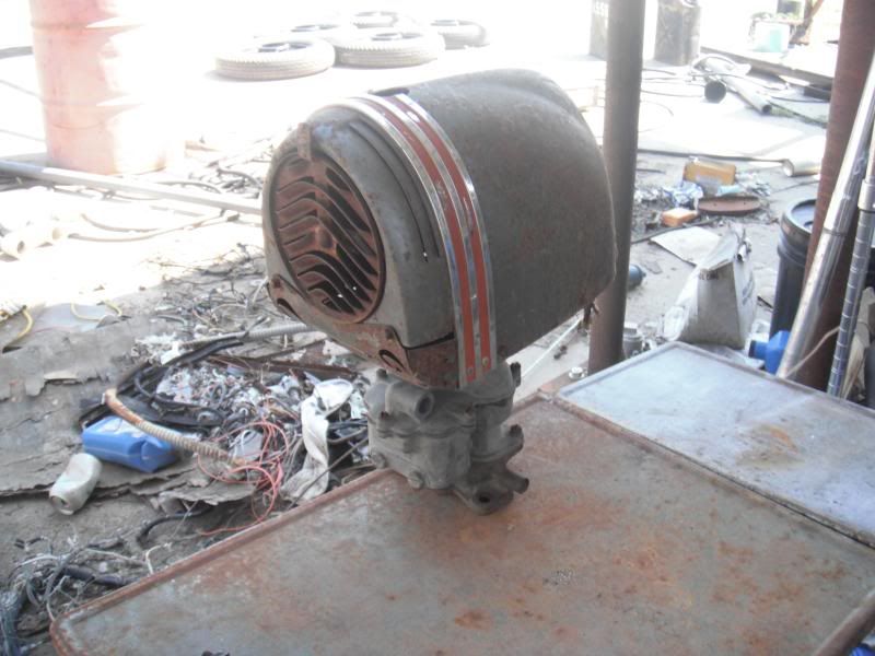

    This air cleaner I made out of an old car heater.

    that's thinkin out of the box Putputboom

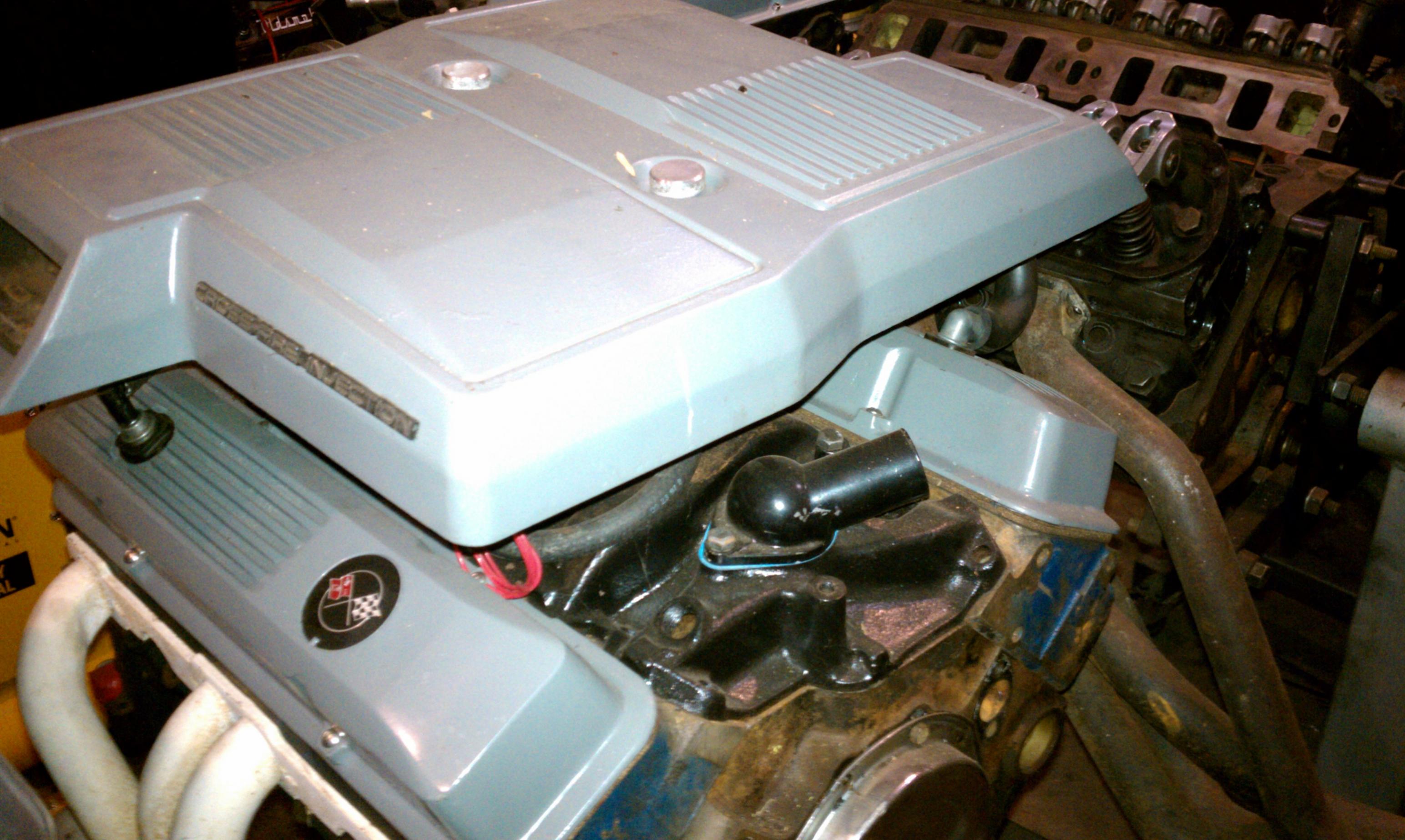

    I made mine out of the engine cover off an old outboard motor

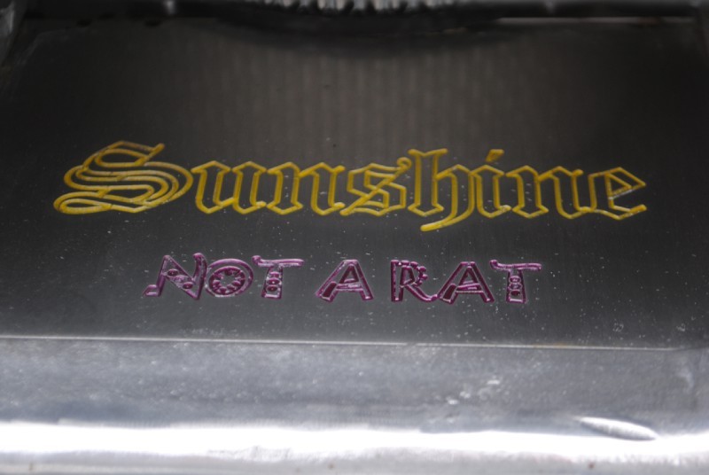

    Here are a couple of versions that I modified, engraved with a mill and then painted... robber

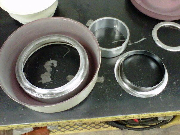

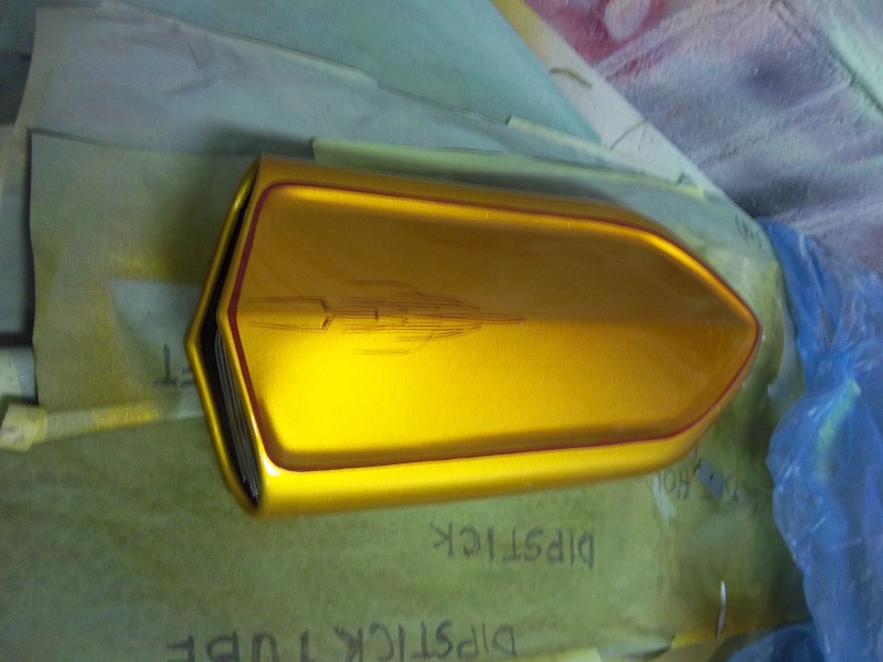

    I built the one mentioned in the first post, for my 61 Dodge. There's even a how- to somewhere here on the HAMB.

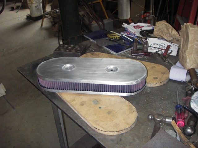

    I also built some replica 53 Corvette filters for the Kopper Kart clone, out of stainless steel. The most recent is one I did for a 61 Olds I'm doing, did a how-to building this one a while back. If you know 61's, the shape matches the body lines on the side of the car. The filter also has a square tube grill, just like the one I built for the car.
    AND Anthony White (00Mack) pinstriping!

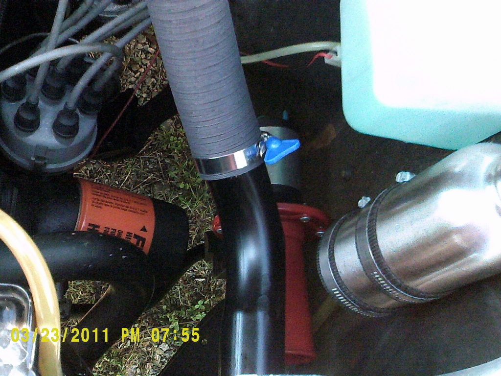

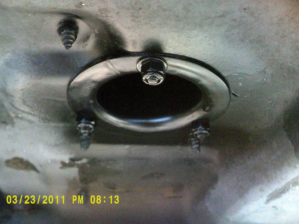

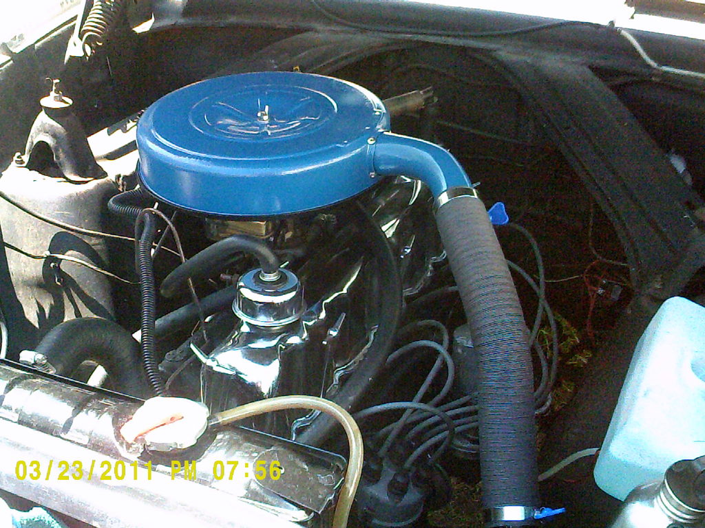

    Here's my attempt at a cold air [not ram] intake for my '63 1/2 Falcon 170 . I'm not sure what year the base came from but it fit my 1904 carb with a little work including reshaping the inlet area to raise the base to show off the gl*** bowl on the 1904 which also formed a shape much like a velocity stack and adding the hold down bolt . I later added holes to relieve excess air pressure . The top is basic issue for an early '60s Ford small six with the snorkle replaced with a curved piece of exhaust pipe . I opened a hole in the radiator support for another piece of curved exhaust pipe with a flat flange for the air inlet . I connected the two pipes with a piece of common pre-heater hose which I remove when the weather turns cold . The pipes and hose may seem small [2"] until you realize the venturi on the 1904 is only 1 1/8" .
