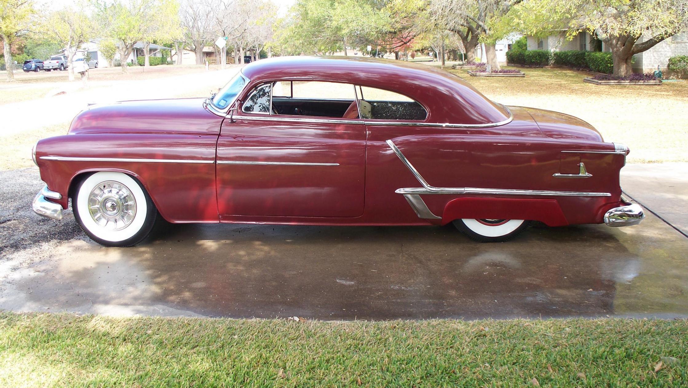

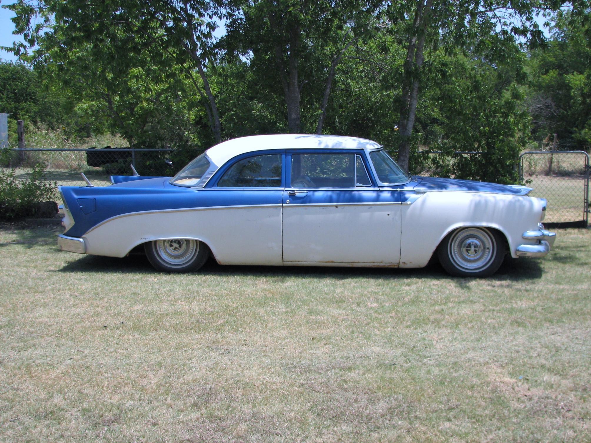

    Here's my beater. Front is turned down torsion bars and 25" tall tires. The rear could stand to be lower and I may bag it sometime.
    The frame rail immediately following the front wheels is about 3" off the ground. Fortunately it is the lowest part of the car. I do sometimes drag on speed bumps.
    Maybe it doesn't seem really low? The crossmember sits directly in the middle of the front wheels... fortunately.

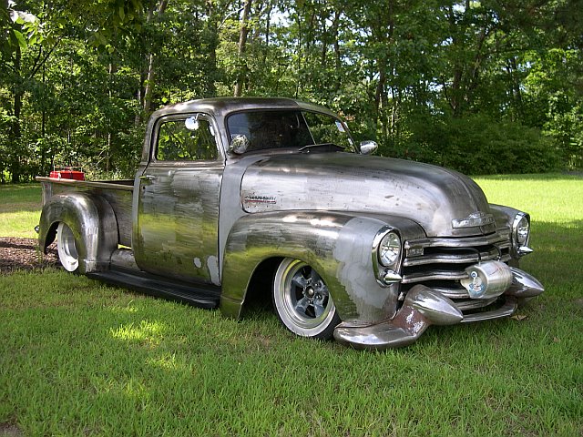

    Mustang 2 with dropped spindles and s-10 rear with 3" lowering blocks.

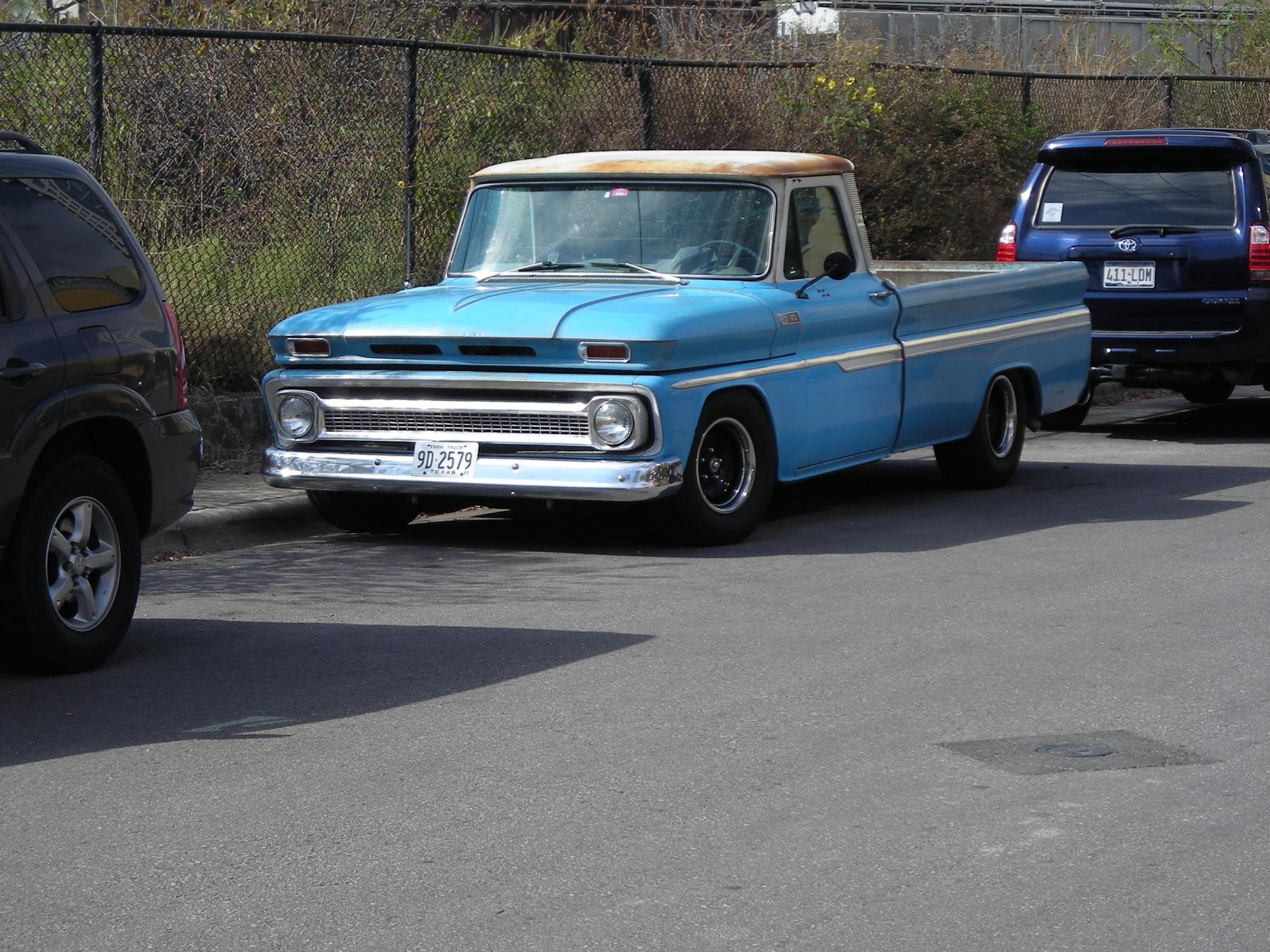

    2 1/2 drop spindles and 1 inch blocks in the front and 3 inch blocks and the shackles flipped in the rear 14 inch wheels rides nice . i believe that this is as low as i can go around here the roads are shit !

    baremetal48.....that truck is SWEEEEET!

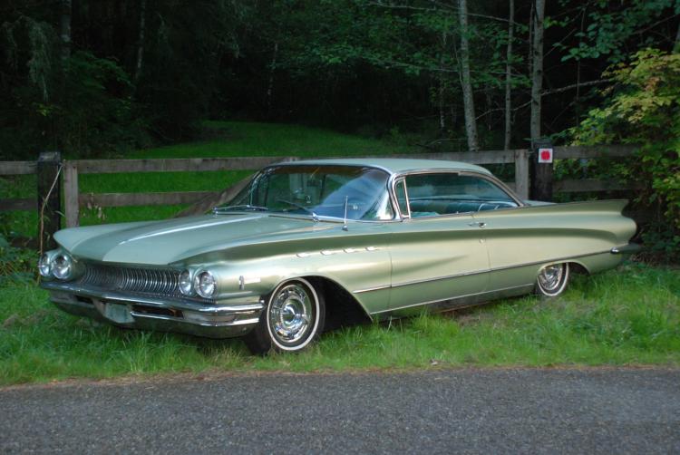

    Yeah man! I like '59's, too....looks like it was a neat one. I want some pinners for mine for when I get bored.
    The front frame section at the cowl area is MUCH lower than the rockers...it makes it pretty hard to get 'em to look too low without a bunch of work.
    It's my daily beater, so...not looking for a major project. I have enough of them already!
    I like 'em low and "natural", anyway...
