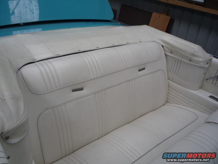

    Mine's not real high tech, just recovered the factory rear deck with 2 layers of black speaker cloth.

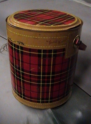

  6. Well now I don't have to exhaust my Skotch Kooler surplus.

    I like the cooler!
    Also,for the rear deck you can use backless carpet. It's available in many colors and is acoustically transparent.

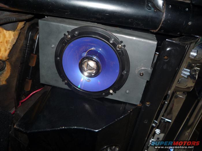

    I am kind of at this point in my rpu build. I know that I will never get perfect sound in it, but I have to have music in it. I know that the speaker locations will never be ideal, because I don't wan't the speakers visible.

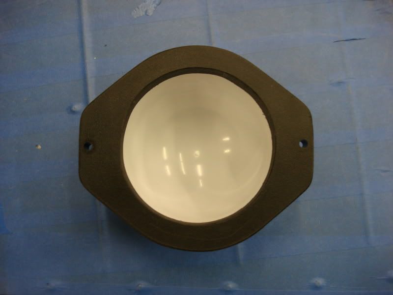

    I built pods to mount two 6 1/2's under the dash. I built the baffles from 3/4" black starboard. Starboard is awesome stuff-it is like plastic plywood. Used lots in marine applications-it doesn't warp or rot. It is available in many colors, and works like wood.
    To enclose the speakers I used these:
    http://www.discountweather.com/nc20.html
    They are molded white plastic, but I will paint them black. They fit a 6 1/2" speaker perfectly. Here's some pics of the speaker mounts as I was building them:
    I built a housing to tuck the deck under the dash. The deck mounts recessed, because I don't want the deck to show. I will build a door that hinges and covers the whole front of the deck. Once this is all painted & the door is closed, it won't stick out too bad. It will look like an underdash heater or storage.
    Not ideal, but it'll work. I'll throw an amp, and a small single shallow mount sub in it & it will do a decent job. For a deck I'll get one that I can plug my ipod into & call it a day.
    Hope this helps a little
    Dan
    This shows some of the speaker pods & deck mounted without the dash in place:
    And with the dash mounted:
    Wowcars likes this.
