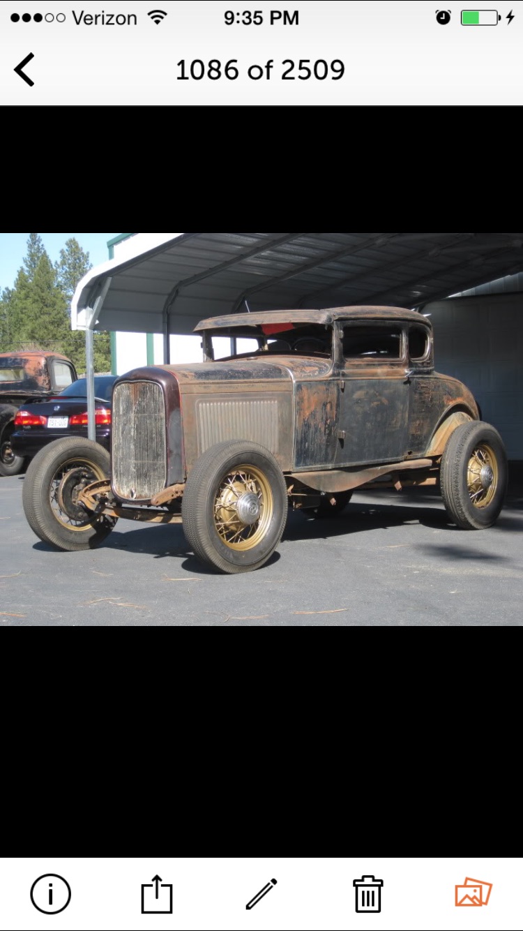

    Dropped axle and mechanical brakes. It's really not that difficult to do. You can make perch extensions as we did or use '32 perches and axle ($$$$). Also another book that's very useful is Mike Bishop-Vern Tardell "How To Build A Traditional Ford Hot Rod."

  8. CTAV8
    Joined: May 18, 2014
    Posts: 107
    CTAV8
    They are '35 mechanicals, 12" diameter with 1.75" shoes, just like later juice brakes.

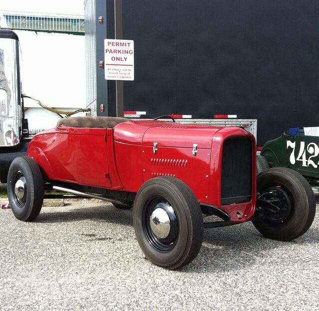

    Complete 32 front end with a reversed eye A spring. Rear spring is A with 7 leaves.

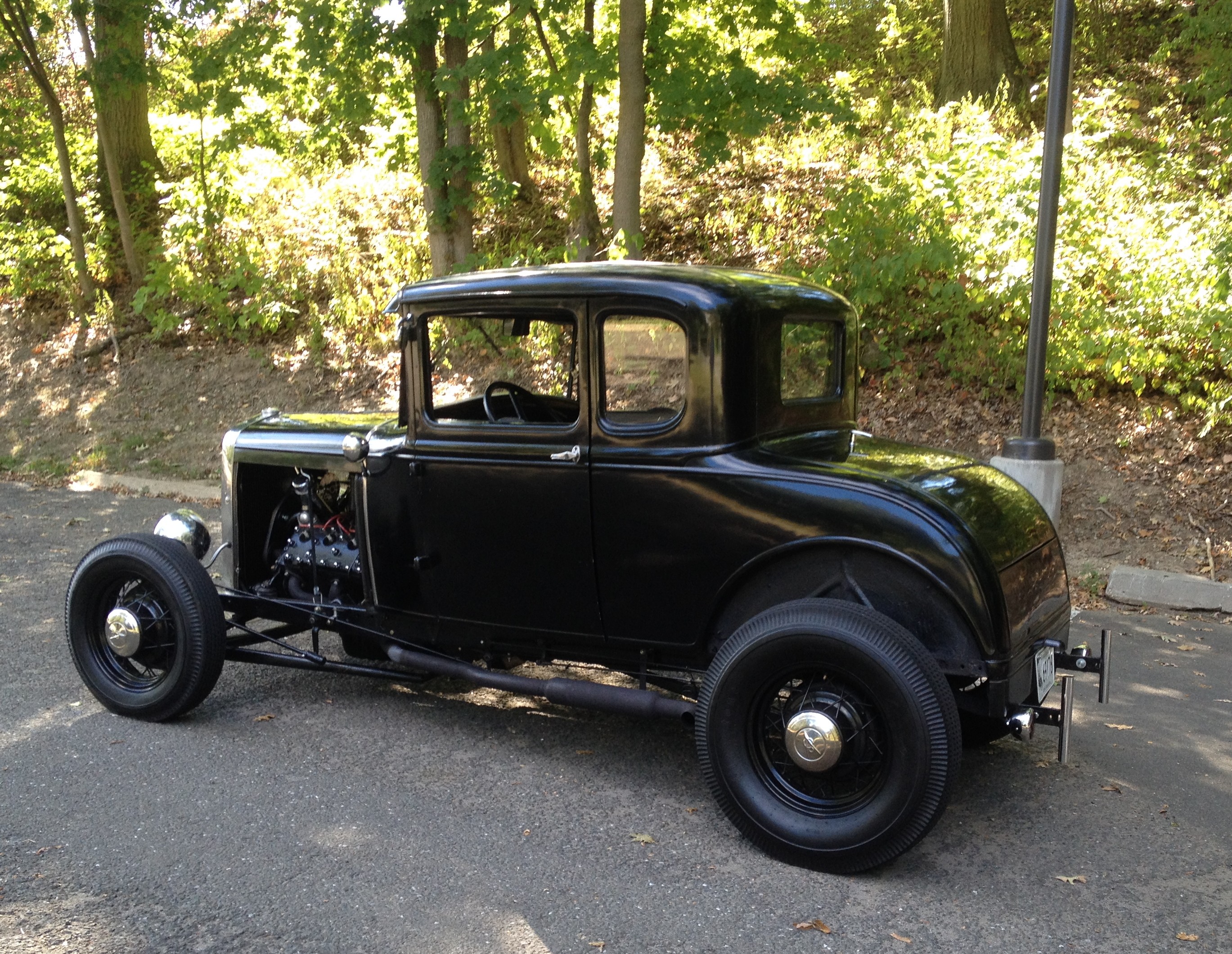

    Here's my 1928 Roadster which has a 8 leaf Model T rear spring and a reversed eye front spring.
    Also a picture of my former 1929 tudor that has the same combo but shows the results on a car with fenders. Both use 16 x 7.50 and 16 by 6.00 tires.

    '32 axle with reversed eye spring. A leaf or two was removed. A lot of the work was done by our own Zach Suhr!
