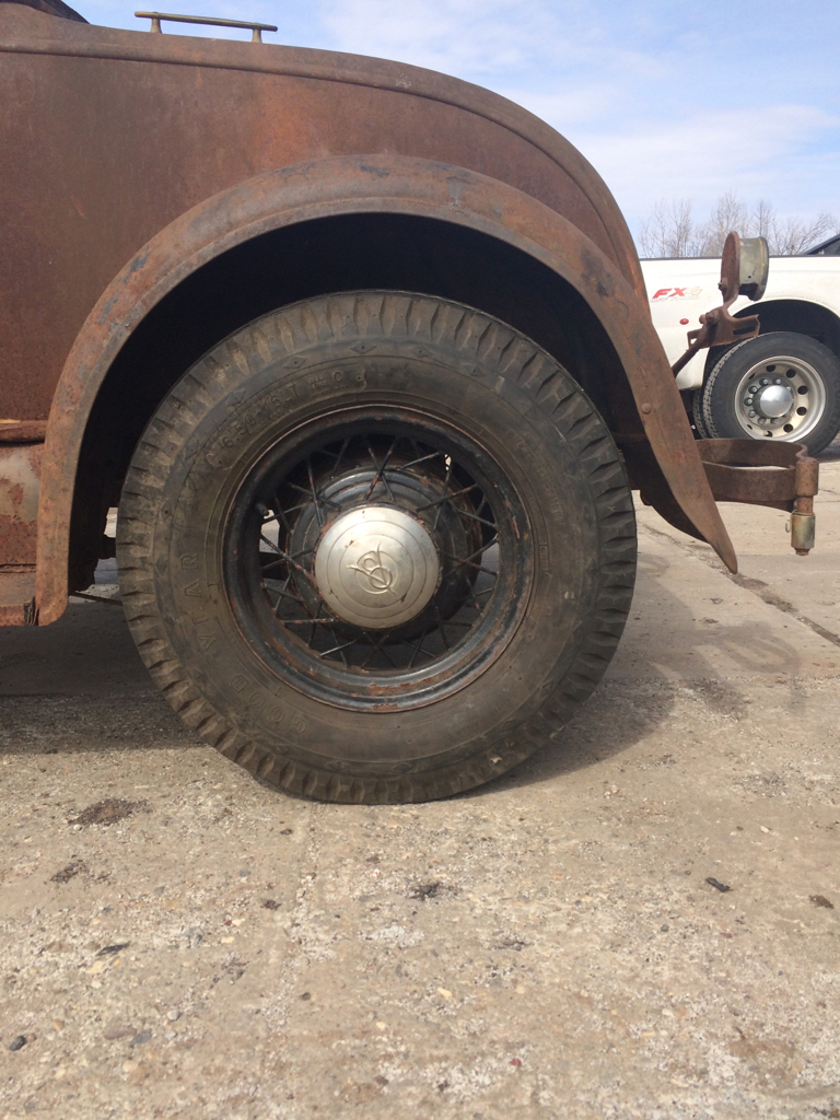

    hey guys I am building a very basic - budget Banger, looking to find out which leaves I should remove from
    front and rear springs, also looking for opinions about necessity to replace at the bottom of the spring pack , I am also using reversed eye main leaves , looking at using car in Nostalgia drag events and dirt track - dust up style events thanks in advance
  22. 97
    Joined: May 18, 2005
    Posts: 1,983
    97
    I always leave the first leaf after the main leaf, you may have to shorten it a little and re radius the ends, if you have reversed the eyes on the main leaf.
    After that you can remove every second leaf if you want depending on how much weight you have removed from the rest of the car...eg. fenders etc.
    Yes you need to replace the removed leaves or place an equivalent spacer under the spring pack so that the retainer bars on the bottom of the U bolts can clamp the spring into the front X member.

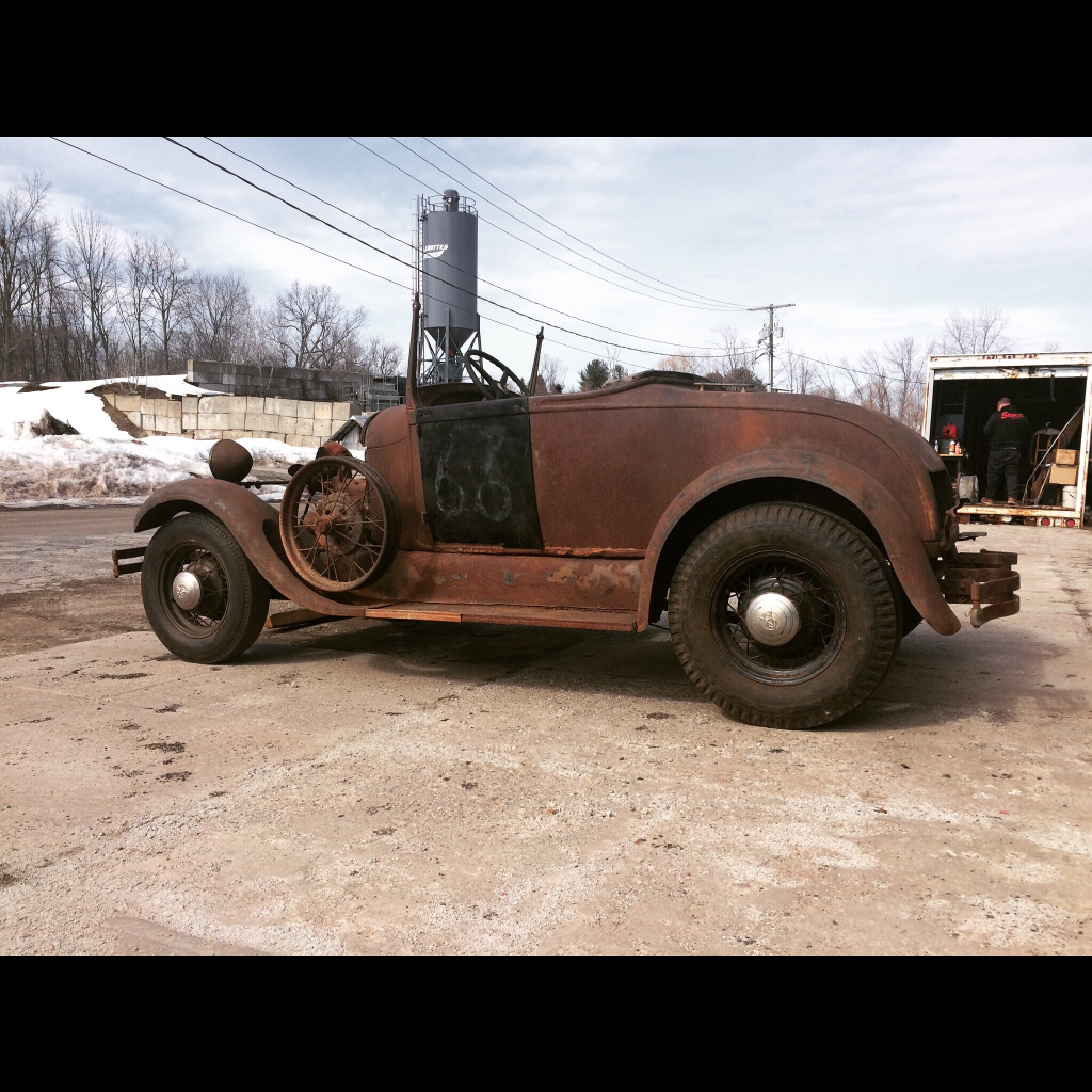

    Here's our 28 Roadster mocked up with 6.00 up front and 6.50 in the rear for tires. Front suspension is stock. We put our "hot rod" spring with reversed eye main leaf and 3 springs removed in the rear. It gave us a total of a 4" drop bolt in ImageUploadedByH.A.M.B.1426615491.857485.jpg ImageUploadedByH.A.M.B.1426615513.792705.jpg

    Matt that's a cool looking roadster. What all are your plans?
  30. 100% Matt
    Joined: Aug 7, 2006
    Posts: 2,778
    100% Matt
    The roadster is a shop build, the general plan right now is. Bobbed 32 rails, 59AB Flathead with an early McCulloch Super Charger, 39 Gear box, 39 Lincoln brakes all around on 35 wires. We've been collecting parts for the last few years for this build so we pretty much everything we right now except time lol. We sold the original ch***is and drive train this past week.
