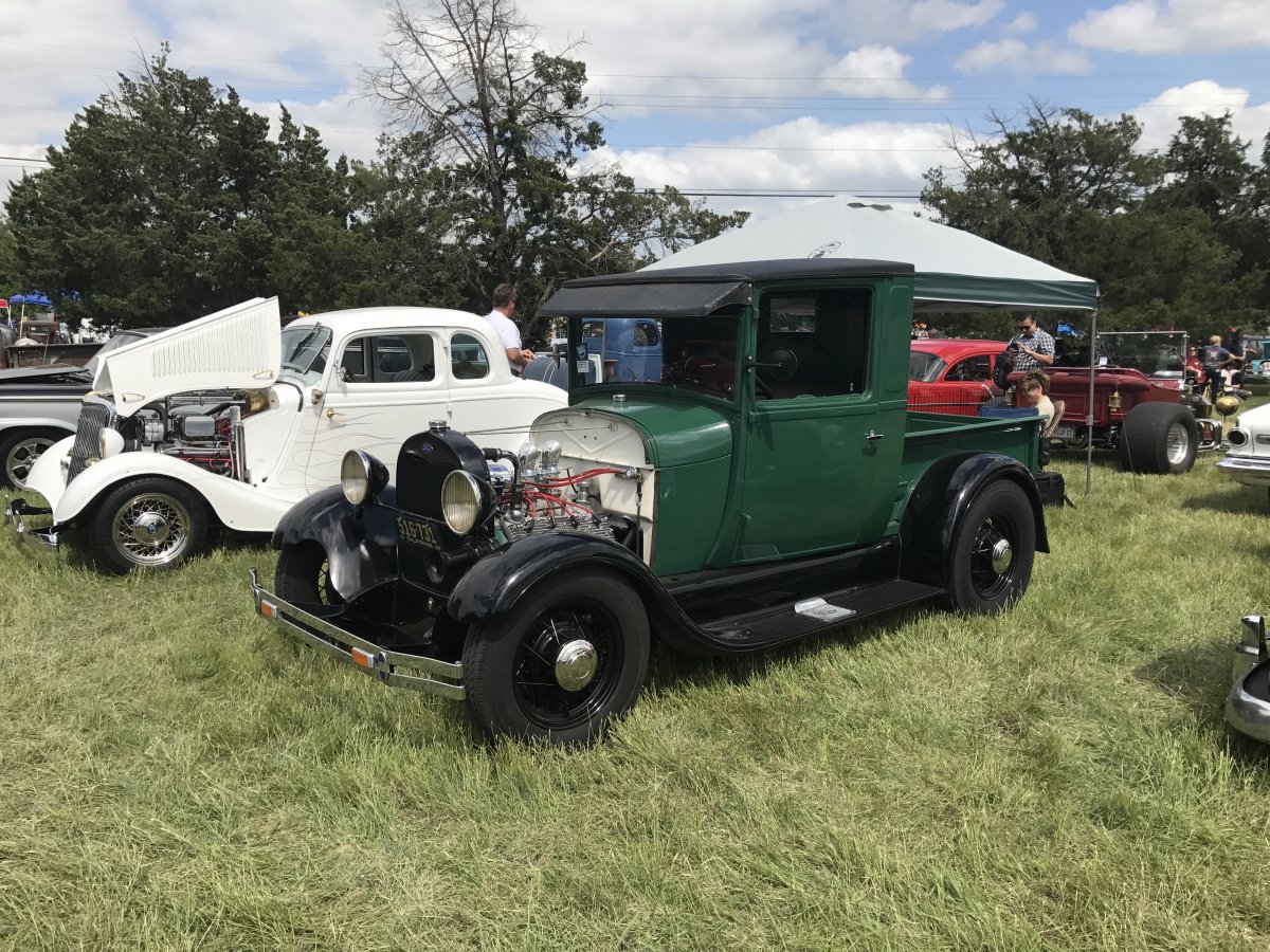

    This stance was achieved by using a '35/'36 front axle with a 2" drop front spring and notching the front crossmember to get another inch. I actually raised it 1/2" after this picture was taken to keep the tires from rubbing the front fenders as much. The rear was achieved by lengthening the frame 7 1/2" and using a '40 rear axle with a reverse eye Model A spring. The tires are 5.50x16 Front and 7.00x16 rear.

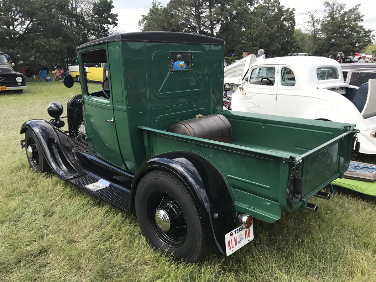

    I have a model t spring with every "other" spring removed. Top is the a spring to keep it centered in frame

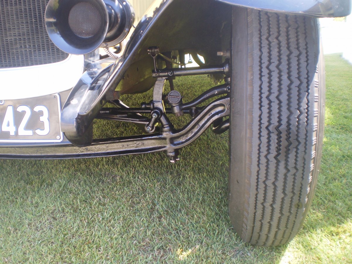

    I put a droped axle under my A with mechanical brakes, 16 inch wires and 550/16s onthe front..
    It was fendered, I stood back took a look and ripped it out again.. the combination of the dropped axle and the deep set backplates on the mechanical brakes pulled the wheels to far in reducing the track width a fair bit . Upshot was it kinda had the look of a VW with a narrowed beam ..
    Taking spring leafs out the front spring made it so the spring hit the frame, not to good .. best solution seemed to be to run a 36 axle for a tiny drop of around an inch, reverse eye spring for another inch, and fit 600s to fill the fender gap and give it the look of being dropped more than it really is ..

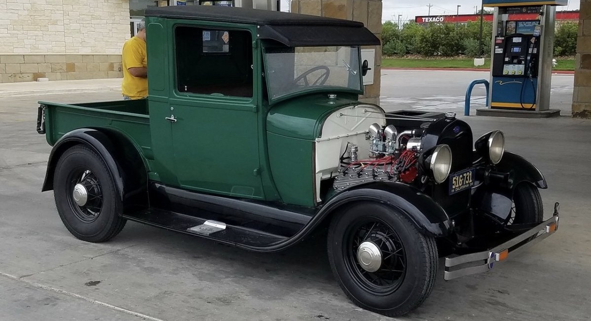

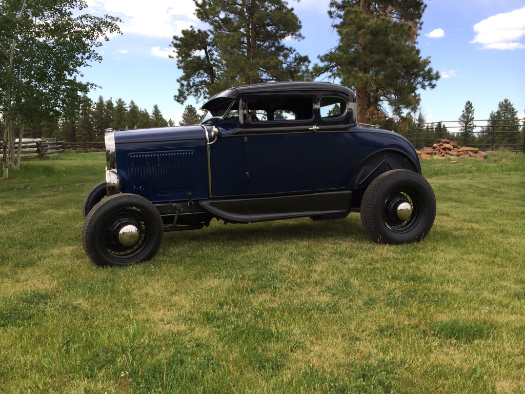

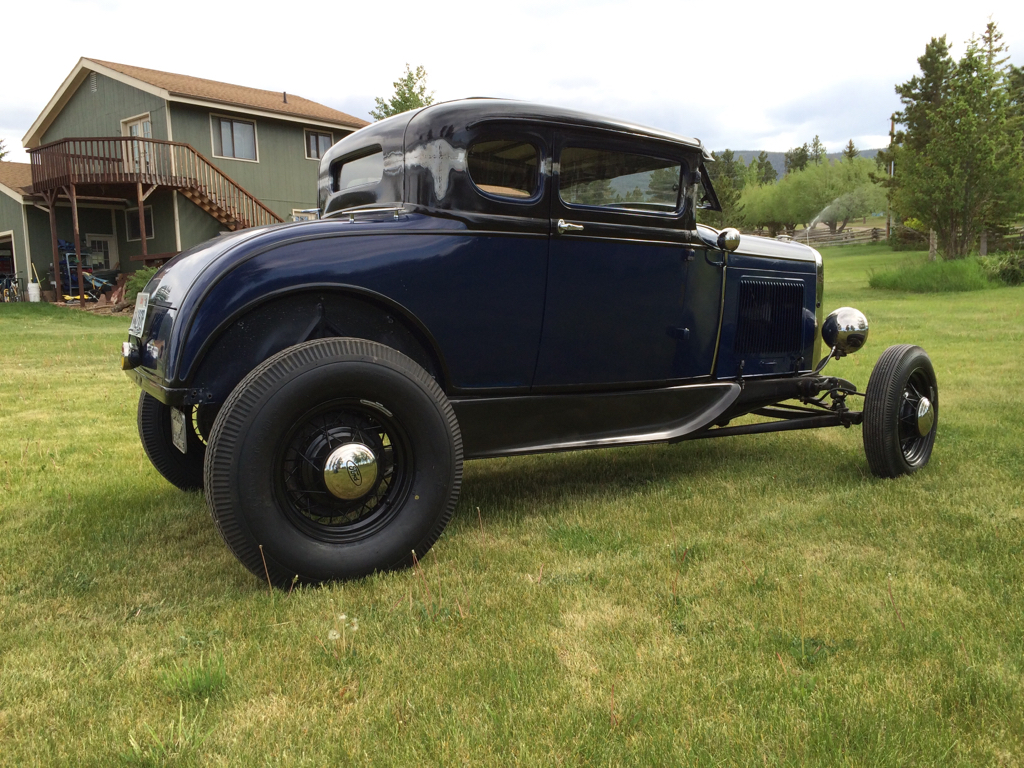

    Here is an update on mine since it has been on the road a few years
  24. Cold Canuck
    Joined: Oct 4, 2017
    Posts: 24
    Cold Canuck
    I absolutely love this car! Please tell me where I can find more info and pictures of it.
