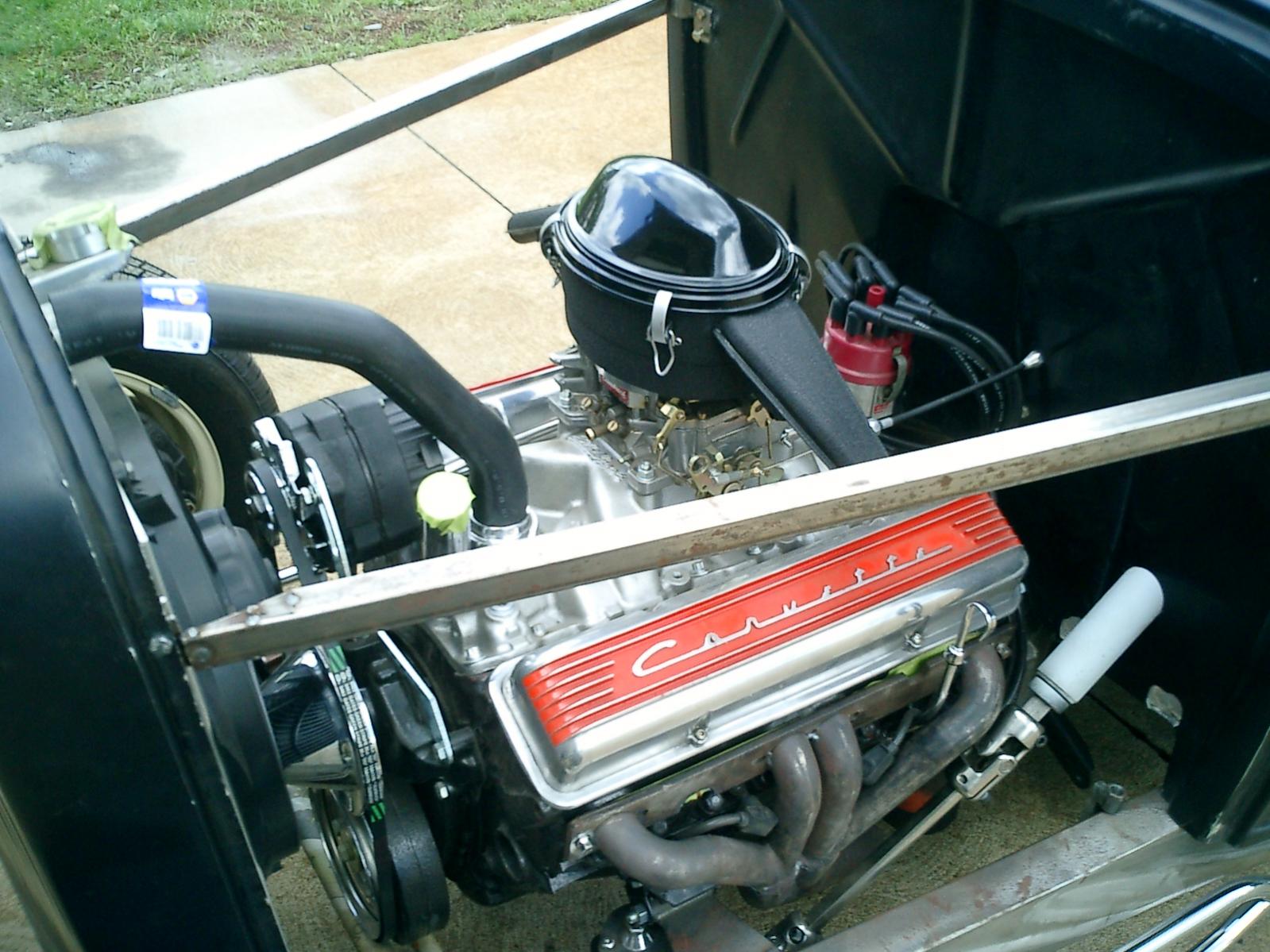

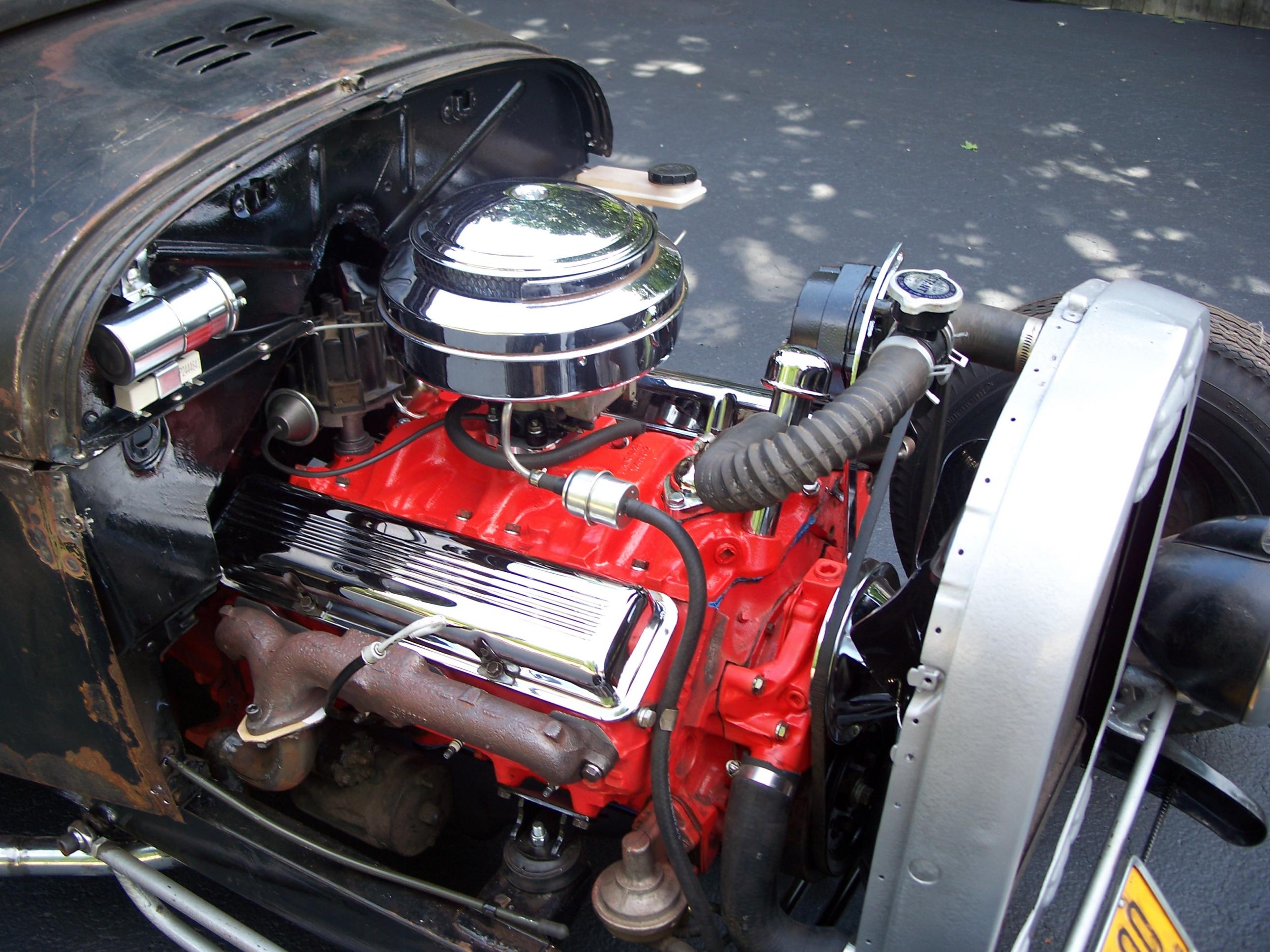

    I was going to put a SBC in a 53 Lincoln, for my GF's grandson, so I tried to make the Chevy look as natural in it's environment as possible (as opposed to building a "phony" engine) The Linc valve covers just slipped over the Chevy ones, and I picked up this old oil bath filter off Ebay, pretty sure it's and old Ford one, but I really have no idea what it's off. Looked good in the engine compartment, though!
    Wound up relocating the engine into my F1 pickup later, and yes, I changed the green top to Candy Bandywine to match the firewall, at a later point!

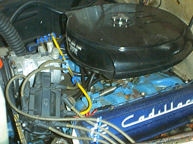

    Here's my pumpkin oil bath conversion.

    Nice like the Buick valve covers...we pretty much did the same think with the oil bath..biggest pain was getting the screen section out.

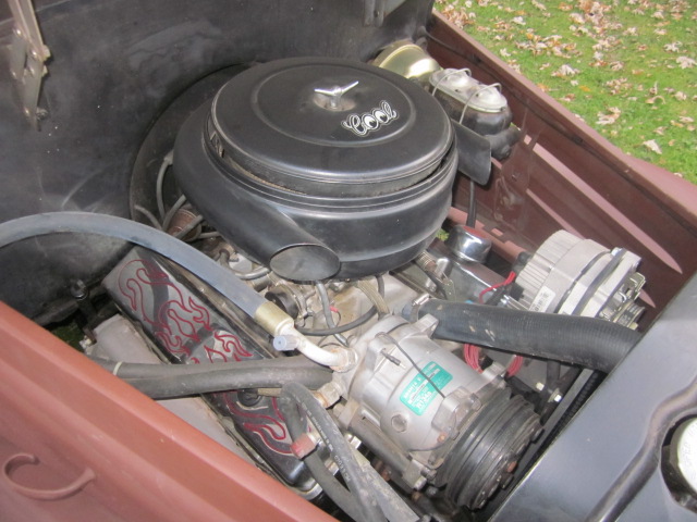

  6. scrap metal 48
    Joined: Sep 6, 2009
    Posts: 6,128
    scrap metal 48

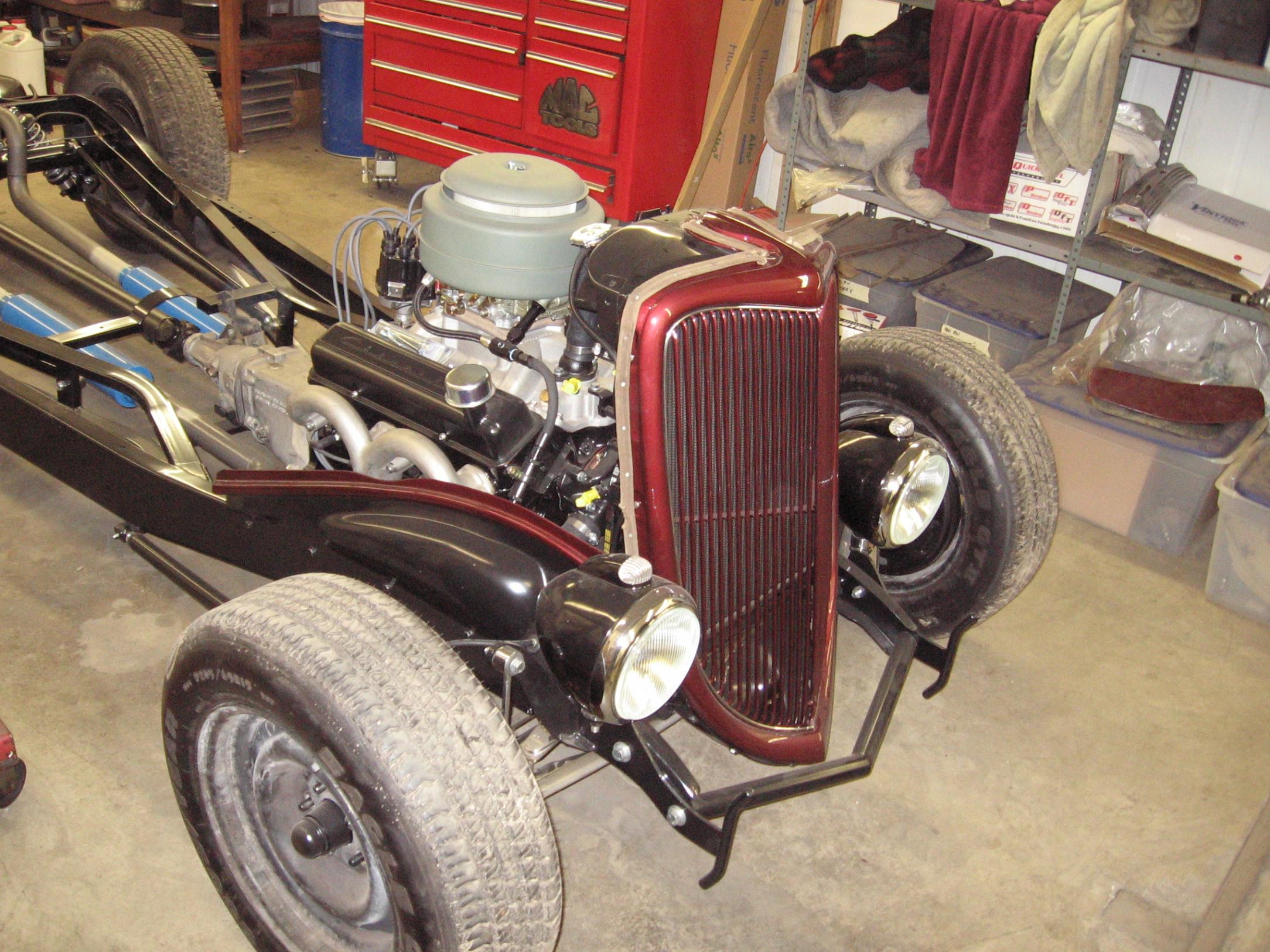

    Here's one...

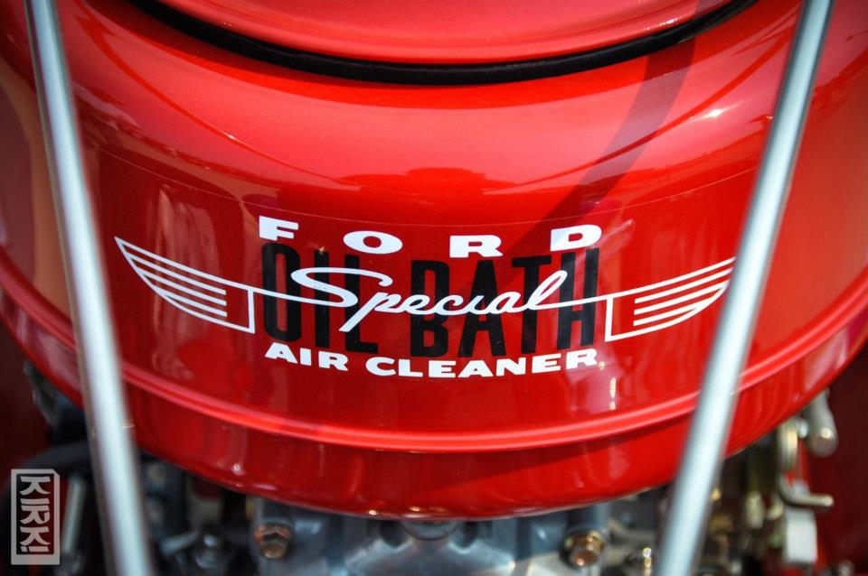

  7. Framewelder
    Joined: Jun 17, 2010
    Posts: 100
    Framewelder

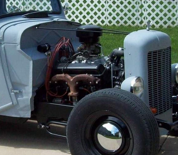

    Here's one for my roadster
  8. historynw
    Joined: May 26, 2008
    Posts: 806
    historynw
    Nice I like the look better than bat wings...i'll have to get Bonz back on mine with finish tacking.
    Framewelder what yours off of?

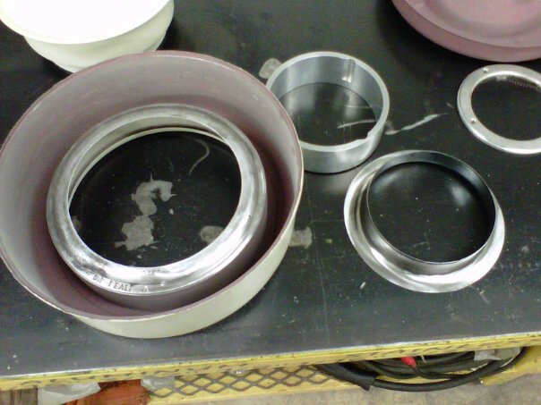

  9. dirtbag13
    Joined: Jun 16, 2008
    Posts: 2,540
    dirtbag13

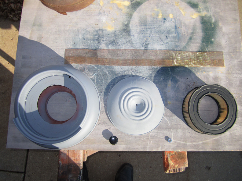

    sure did, got one off a 53 ford , pulled it apart , machined a rider out of aluminum for the bottom half to sit on the carb , tig welded in the center of a modern air cleaner to the top half that pressed into the piece i machined , drilled holes in base and inside of upper half to pull air , nachined an aluminum top hat to go in the lid and center the filter which is an industrial one i got at an arnold motor supply ! looks pretty good i think

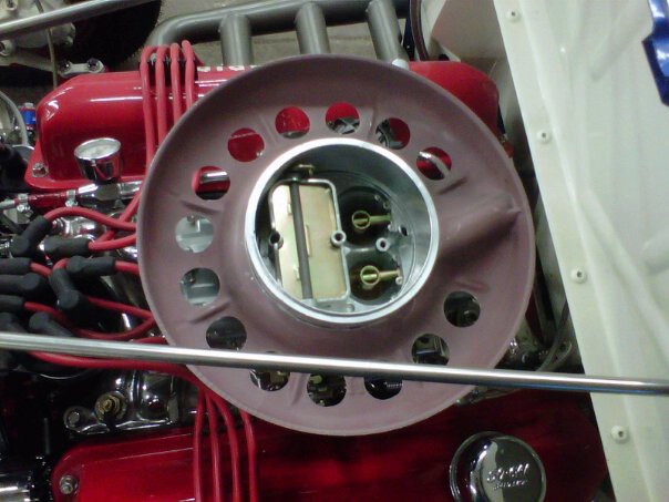

  10. blue 49
    Joined: Dec 24, 2006
    Posts: 2,084
    blue 49
    from Iowa

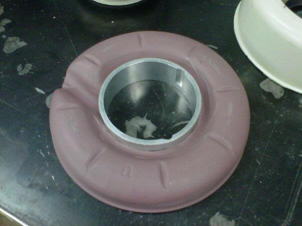

    Here's one I made up for a Rochester 2bbl.

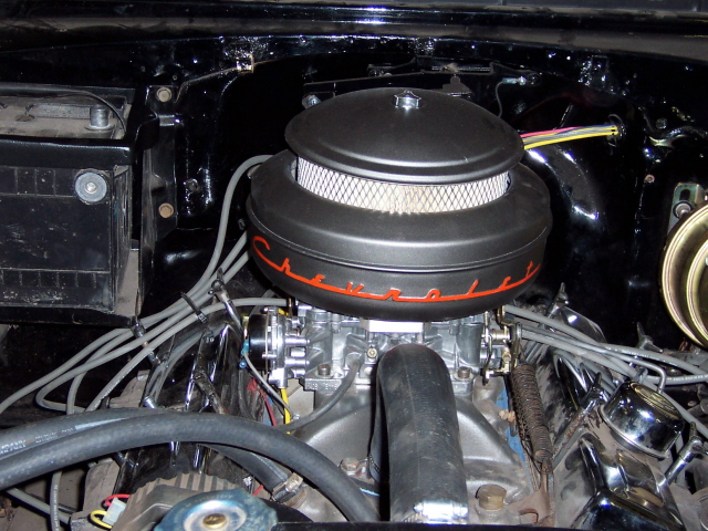

  12. raymay
    Joined: Mar 2, 2008
    Posts: 2,592
    raymay
    I have done several types of air cleaners. Two of them were old oil bath ones. I usually modify the bases using parts from a newer air cleaner.
    On a 37 Chevy pickup I welded exhaust tips to each side for additional air intake which worked very well.
    On my 56 Chevy I stayed with a more traditional oil bath look and welded the Chevrolet script from an old small block valve cover into the base.
    One thing I learned even after cleaning the old oil bath. Don't use a plasma cutter to trim it out. All is well but some of my buddies got a good chuckle when I was doing it.
