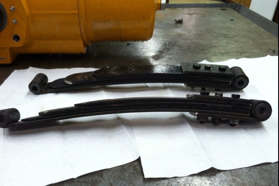

    For the springs I sacrificed two old stock main leaves. Reversed arched them with a roller at work. Then cut the rest of one spring pack in half and bolted them together. Fabbed up the mounting brackets similar to others I've seen advertised. Here's some photos I dug up from a few years back. As you can tell this was a total home/low budget build over 3-4 yrs. it's been a lot of fun and the Hamb has been my reference on much of it. I'm always amazed at the talented folks on here.

    Very similar to what I was planning. Do the jack bolts contact the spring itself or the front spring pack bolt? How did you roll the eye after you shortened the spring?
  16. Look at the pictures again. The new eye is bolted on from another leaf spring.

    I didn't catch that. That explains the 3 bolts, which was going to be my next question.

    The adjusting bolt contacts the flat area of the spacer piece on top of spring pack just ahead of the third clamp bolt. The short end eye is a separate piece cut off the other end of the main leaves that I sacrificed.
    I cut the springs with a friction saw and drilled with ***anium drill bit, all final ***embly was with Gr8 bolts and nylocks. The springs mount to frame bracket with proper length shoulder bolts in double shear.
