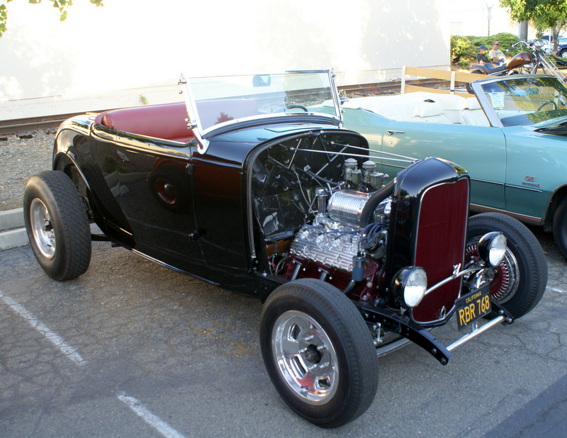

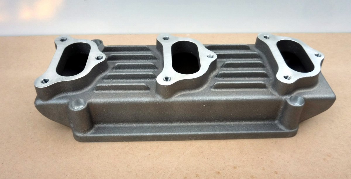

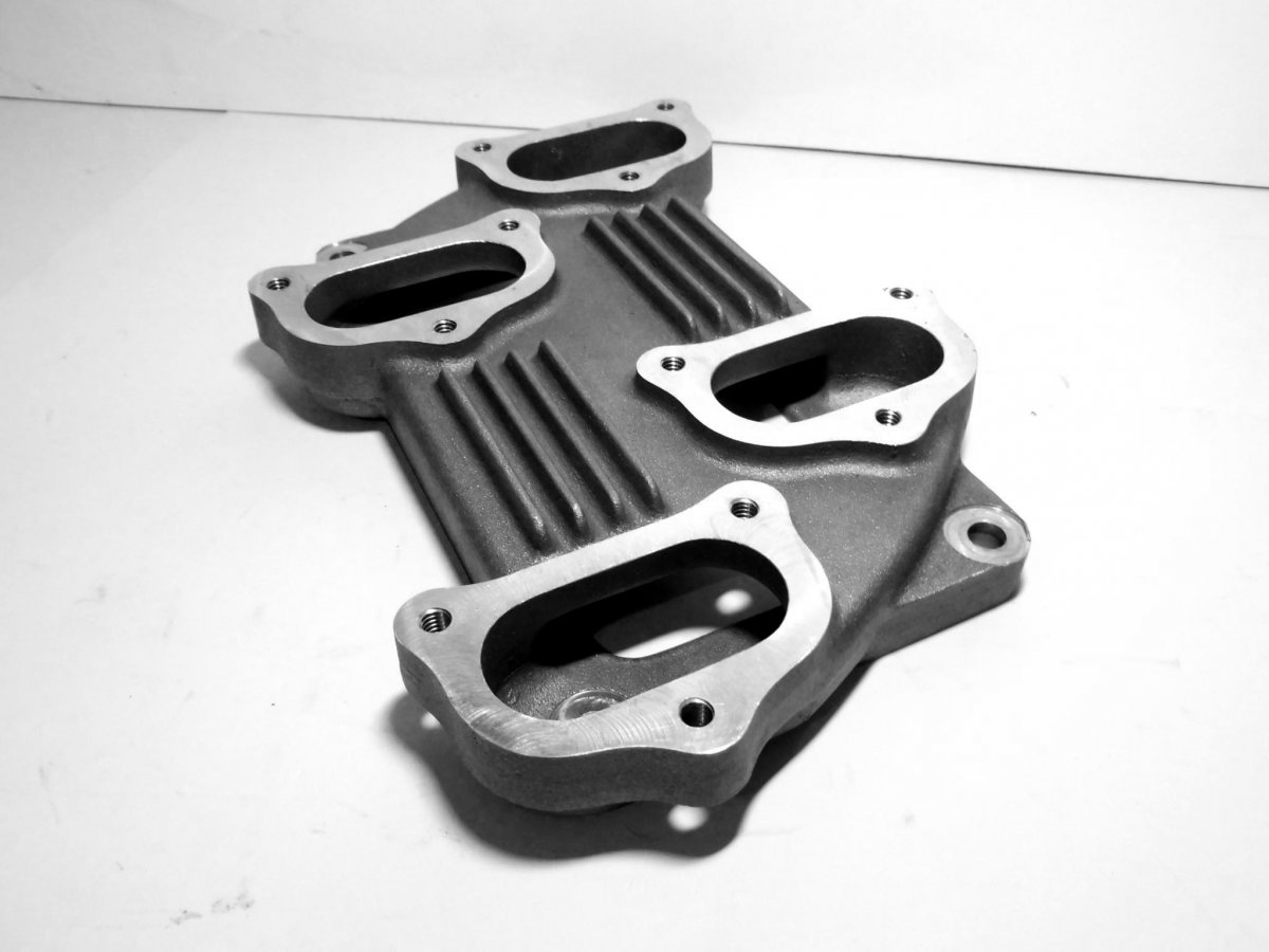

    A friends Flathead V8 4-71 blower and he is using my 4-71 blower intake and 3x2 4-71 blower top plate intakes that I manufacture. I also make a multi purpose Flathead intake and 4x2 471 blower top plate intake,[ photos below. ben 2.jpg
