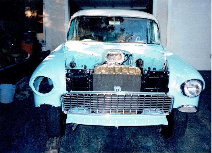

  1. We all know the outcome of pro paintwork, now let's see some rattle can excellence, doesn't need to be the entire car lol, just some designs, hopefully lace, fades, candy....
    With candy, flake and 2k clear available in a rattle can, it makes it a bit more easier to do for someone who doesn't get into painting on a pro level.

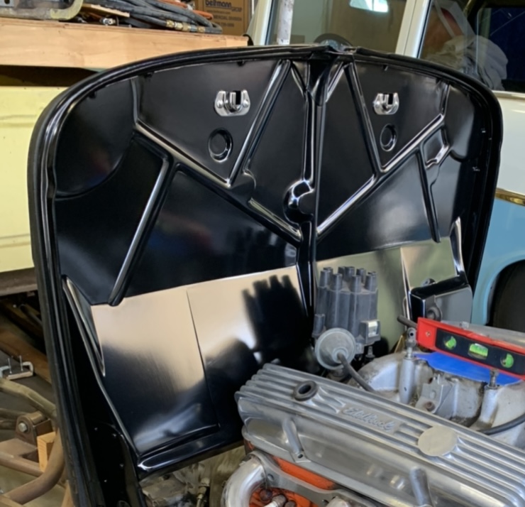

    Firewall is all rattle canned primer and paint. Just like a spray gun it’s all about good wet overlaps. 4AA2BC98-D63E-40B1-9F16-970F213A293B.jpeg

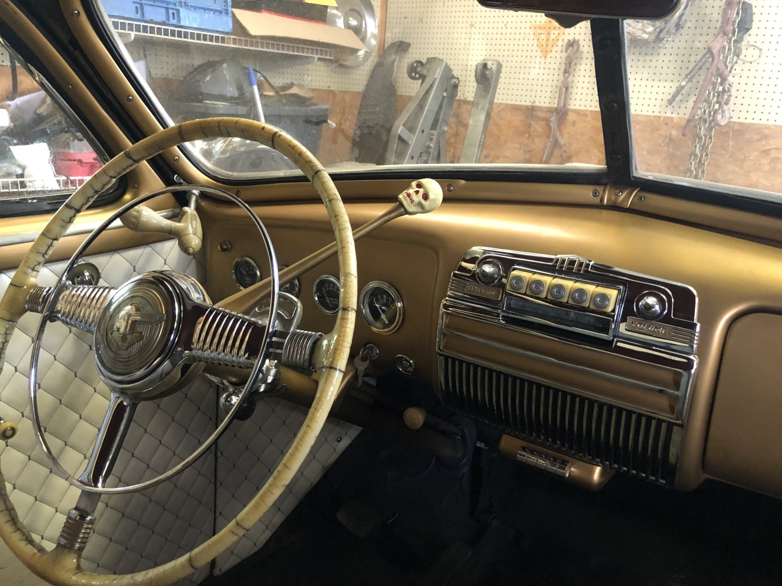

    Rattle canned the dash, the column, and the steering wheel.

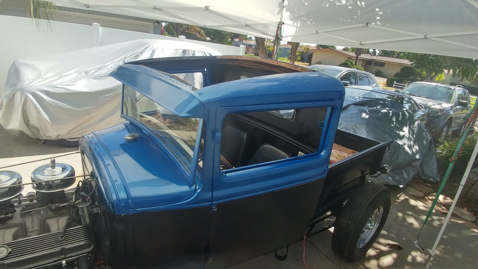

    It fits in the "Driveway Paint Job" category too 20200515_154746_HDR.jpg 20200515_154756_HDR.jpg DSC_3861small.jpg DSC_3869bsmall.jpg

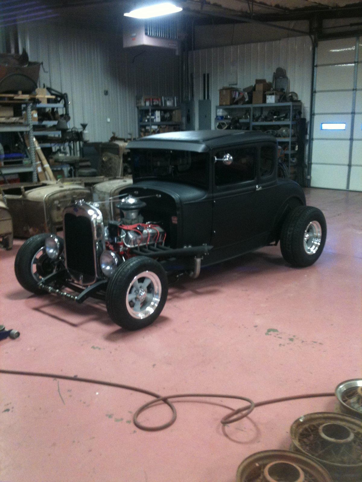

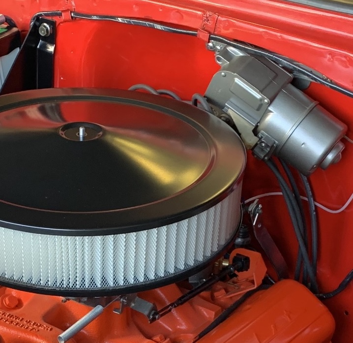

    Cowl is a little duller than the firewall touch up with rattle can. E3DEEB3C-93EC-4F69-8A51-9413AB21ECC9.jpeg
    Hell everything but the air clean in my this pic has been SSSSSssssssst.

    What primer and topcoat did you use Johnny?

    Duplicolor lacquer primer (lots of repeat recoating/blocking)(was a cut up firewall I welded back together) and Krylon finish.
    This didn’t happen over night. All that primer needed to gas out first.

    Firewall turned out real nice.

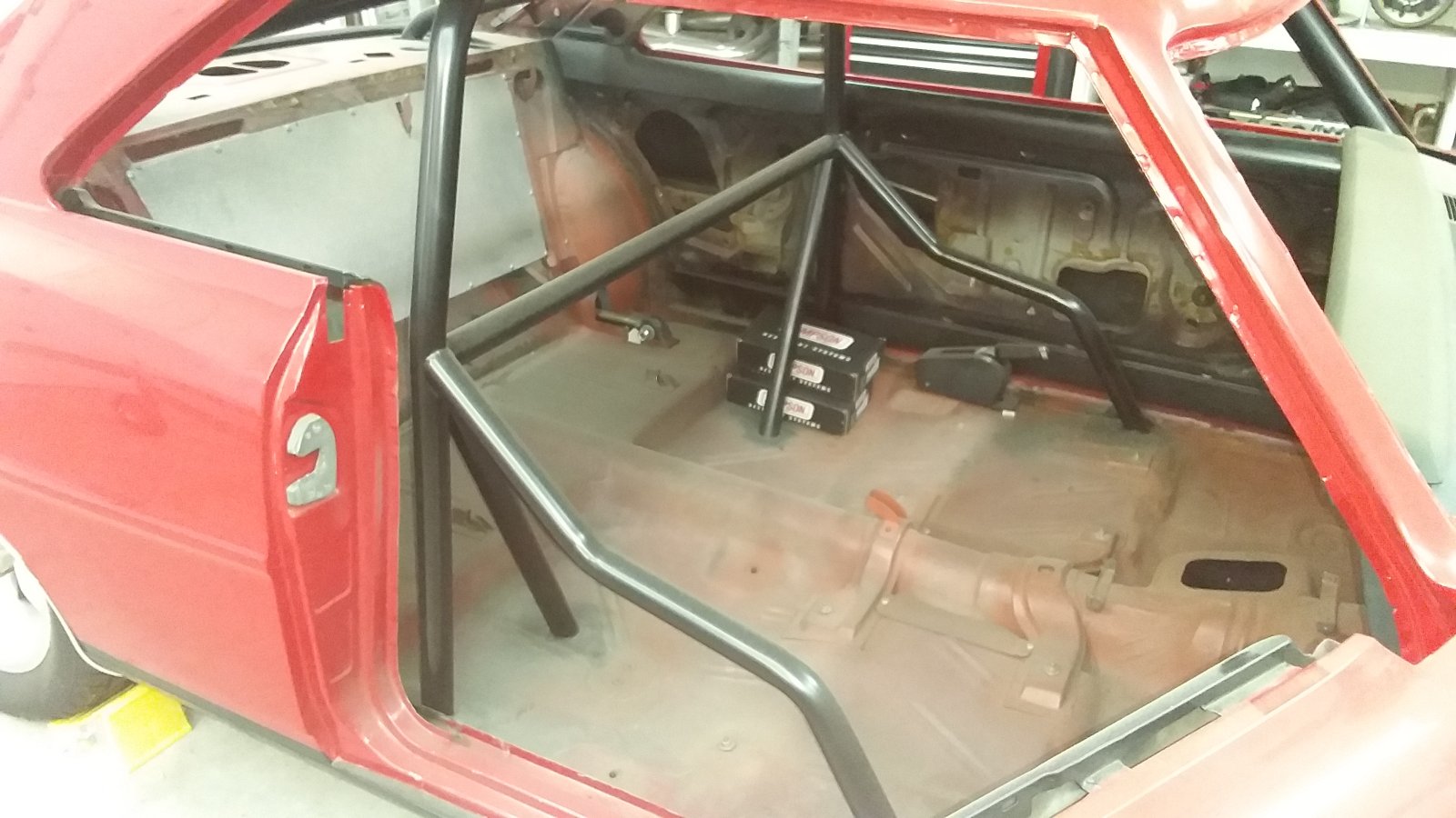

    I used (a bunch) of Duplicolor self etching primer on the roll bar in my Nova with Krylon semi flat black, I'm pleased with the outcome, seems durable.
    Thinking the dust will help protect it.

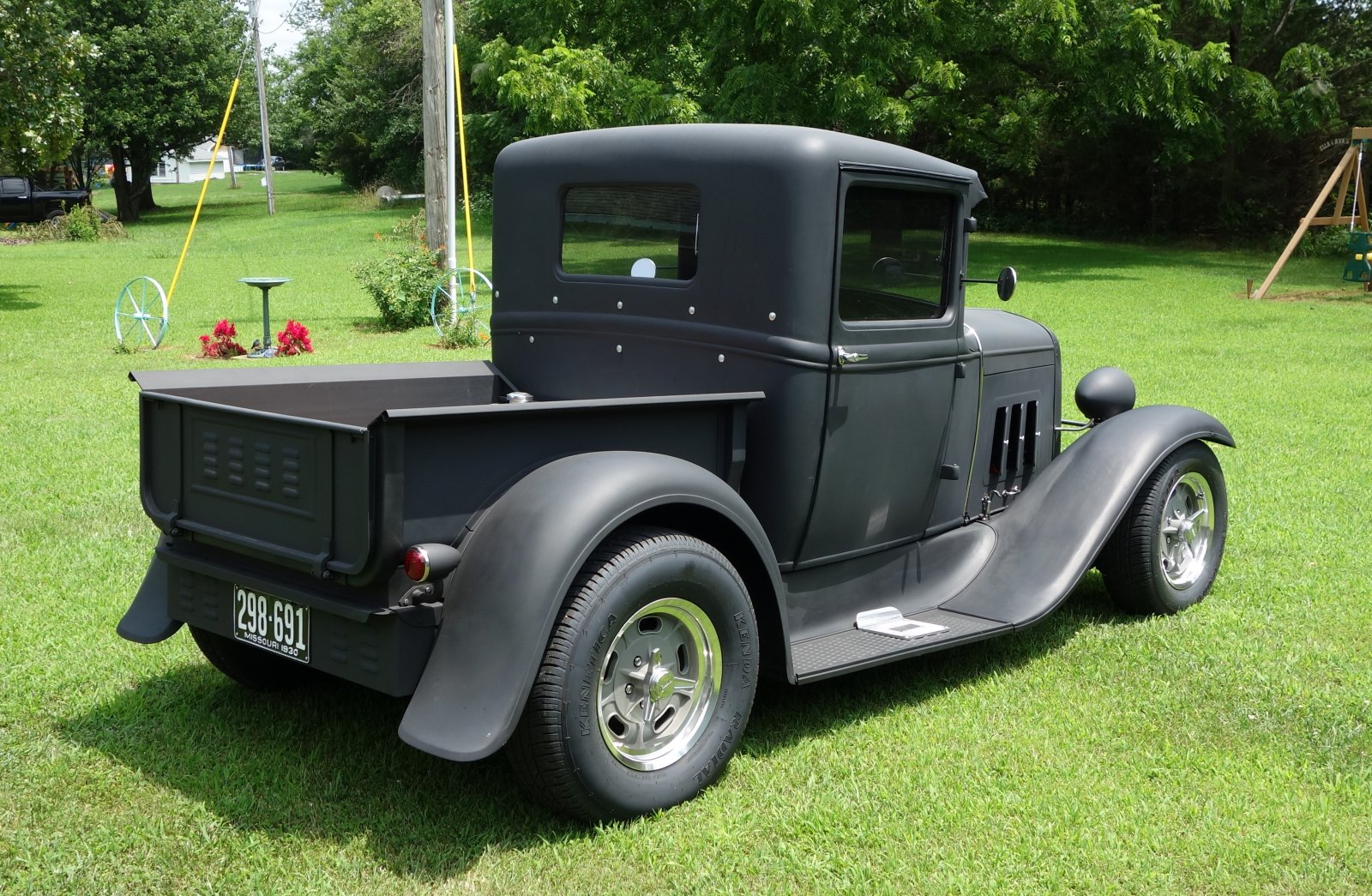

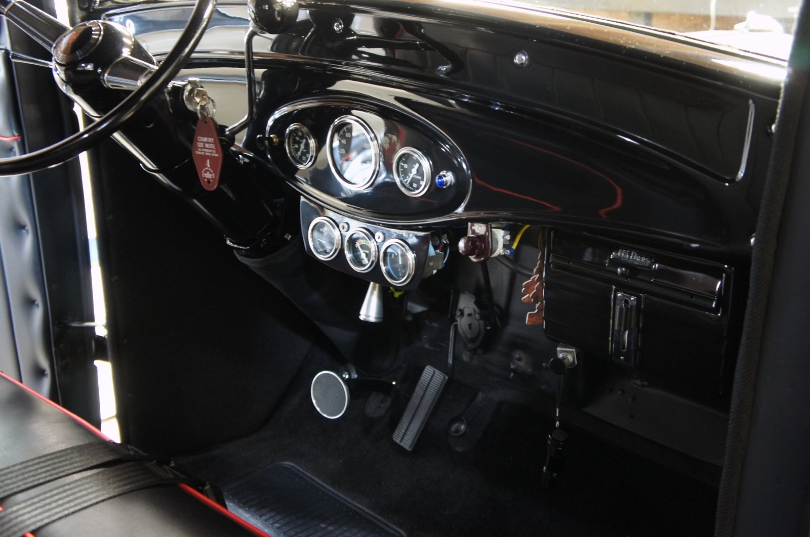

    Rattle can laquer from our local paint store (Bob's Paintland).

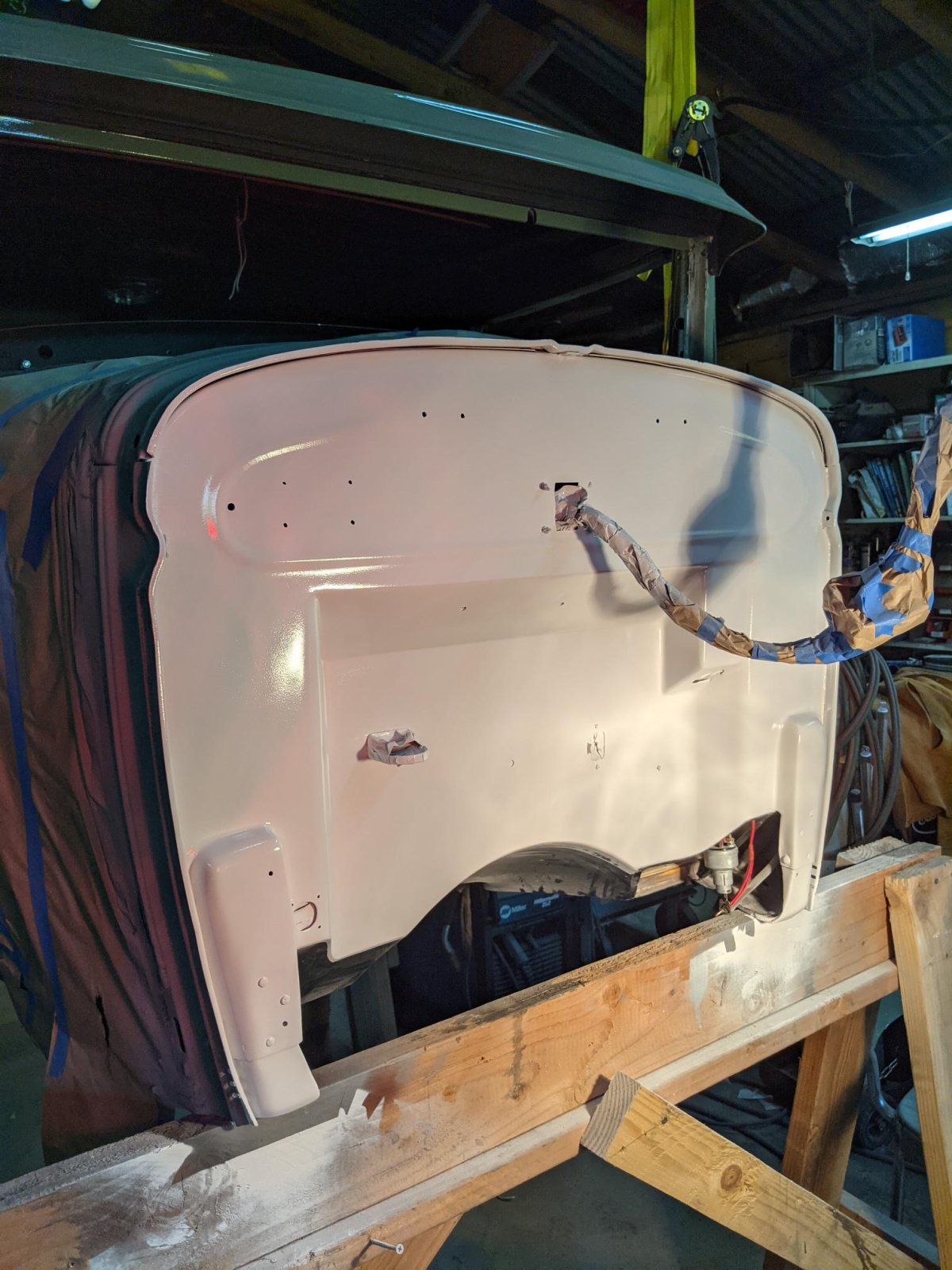

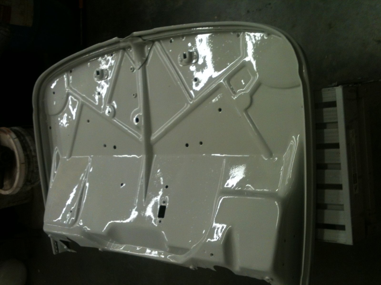

    Rust Oleum appliance white, eight coats. I think this picture is before cut and polish 31 firewall paint 2.jpg
