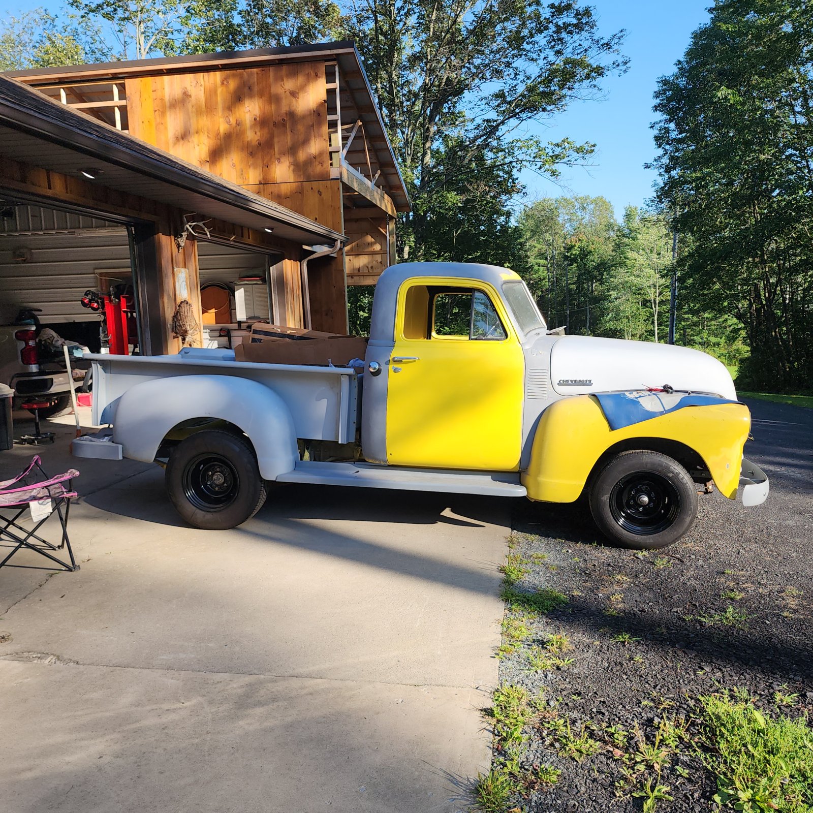

    Just got done installing a new wiring harness in my newly acquired 51 chevy 3100. Building a daily driver for grocery getter. While I had the dash all apart rattle canned the dash with Gun Metal gray from Lowes.
    Off to Hershey at the end of the month to hook up with Sid for an exchange of a 3 inch drop axle and some front and rear Posies 3 inch drop super slides. Runs and drives and now everything work with the rewire! Took me about two weeks in between kids baseball and cheerleading!

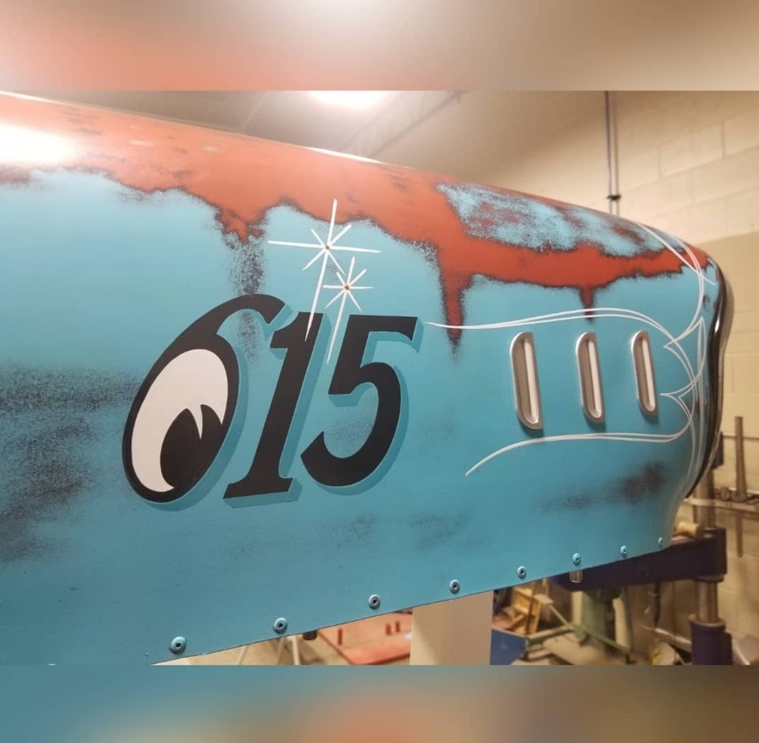

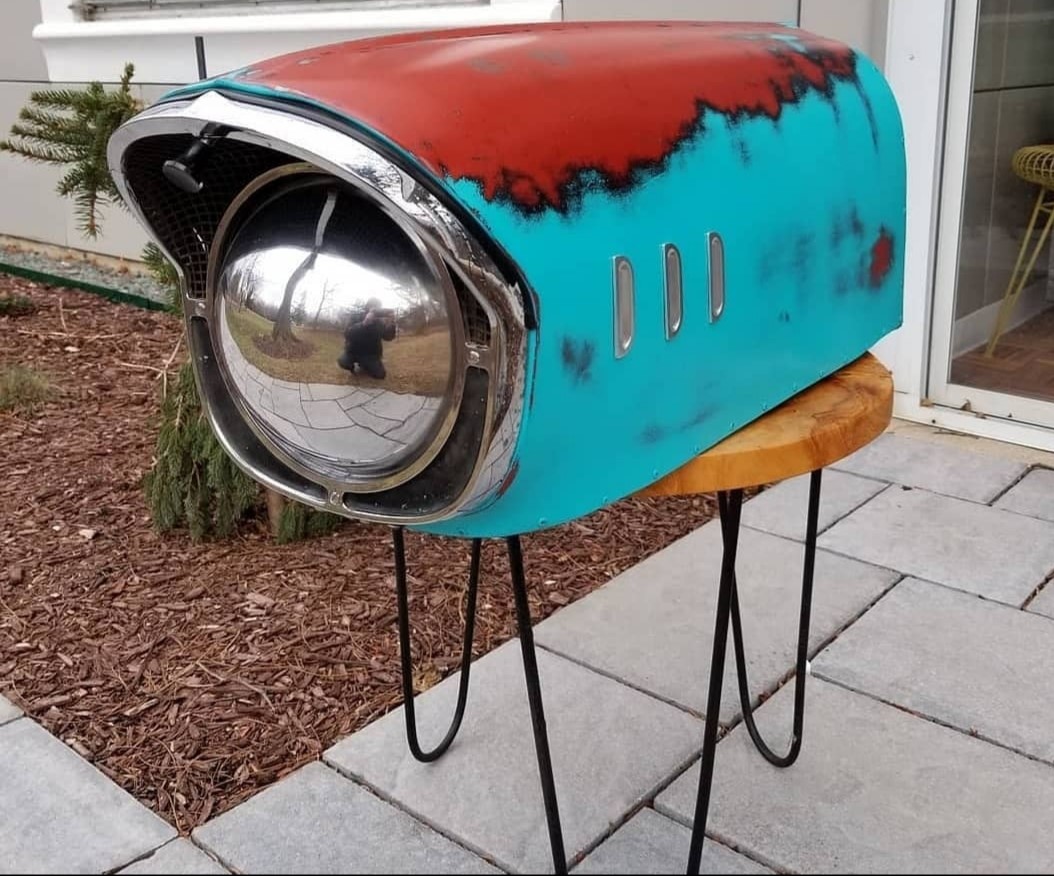

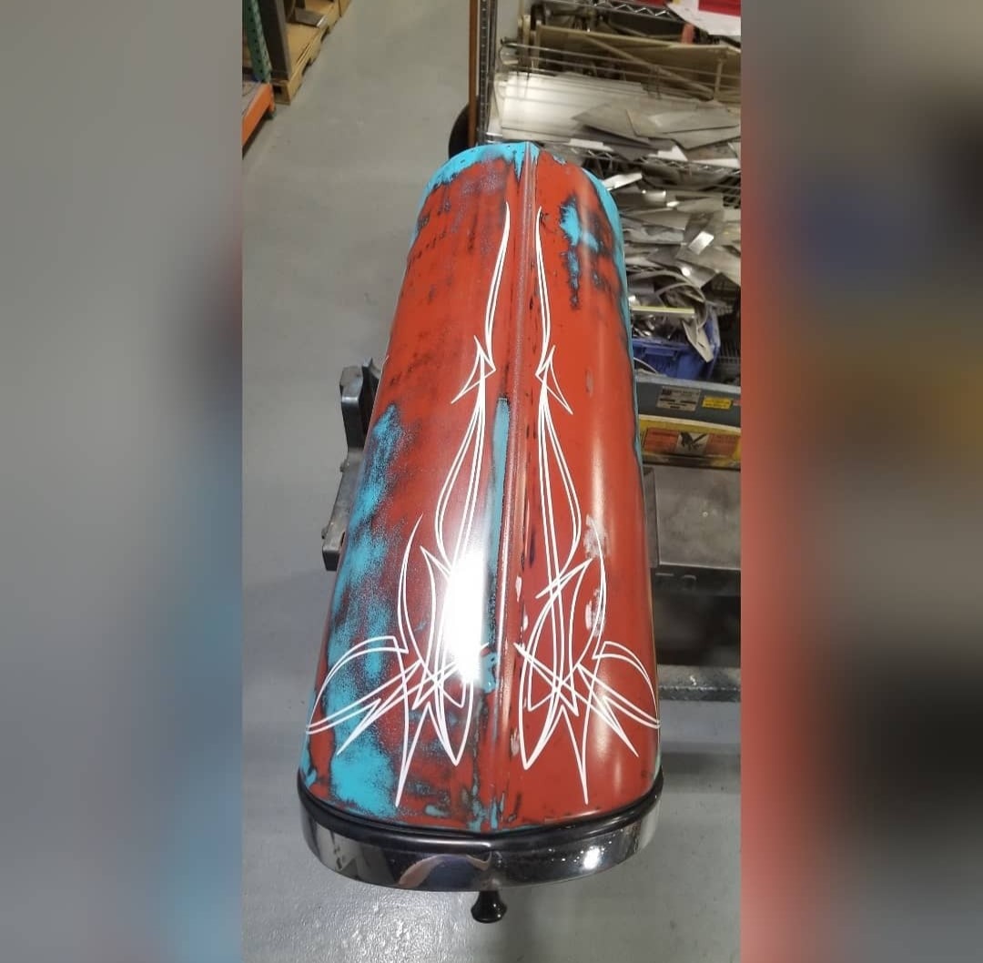

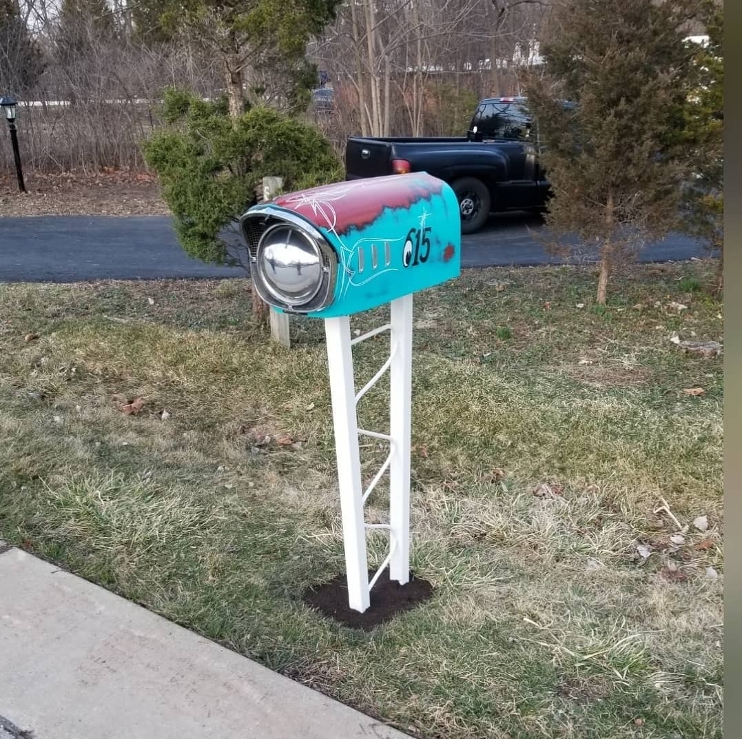

    Made this a few years ago. Made the mailbox, stand and rattled can it and "patina" the paint. The numbers and pinstriping was done by a guy named Greg in Berwyn IL box1.jpg box2.jpg box3.jpg box4.jpg

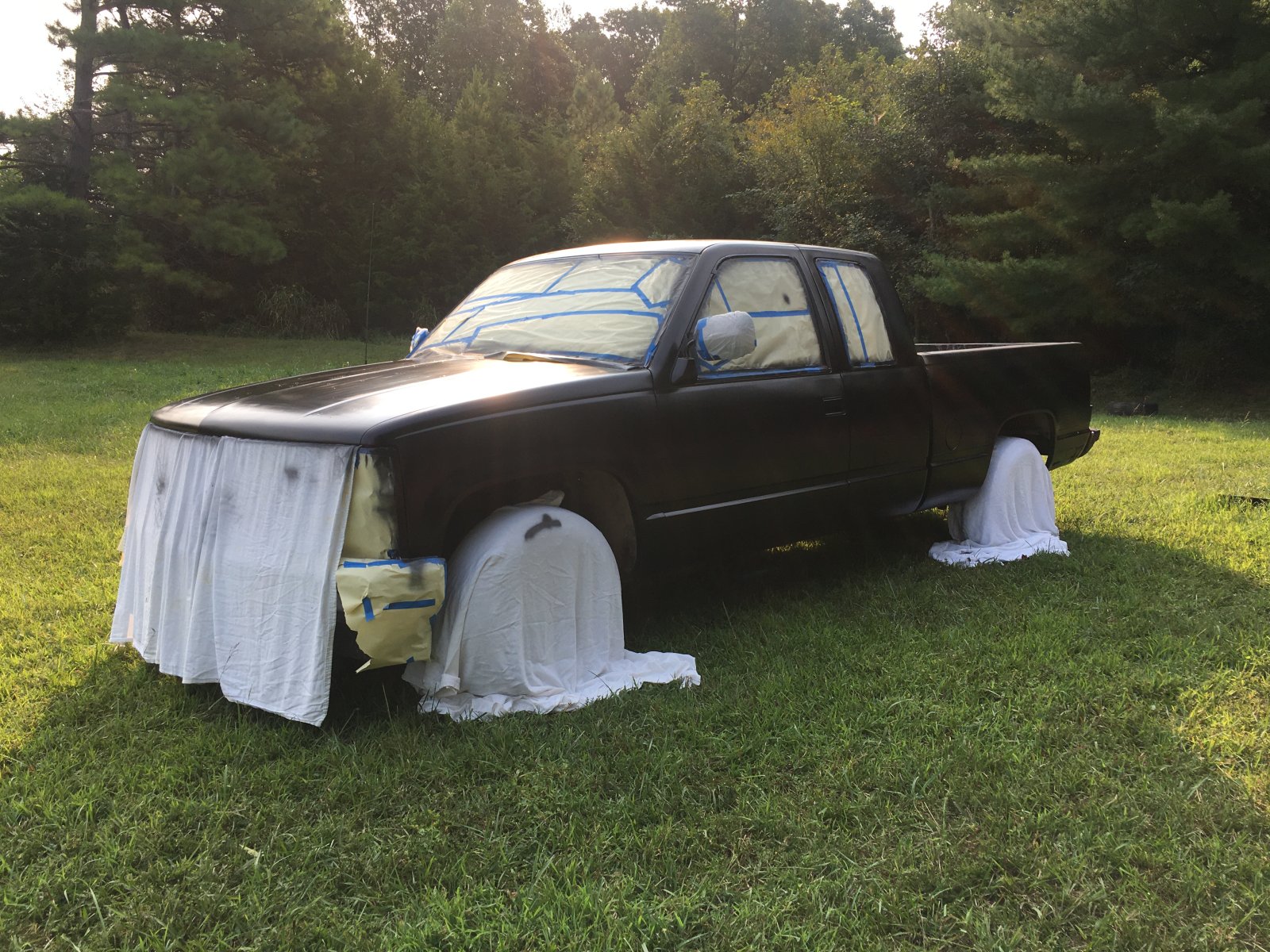

    Here is my o/t truck done with rusoleum wheel paint was in mat black primer for a few years then one day when the weather was right I emptied 5 cans onto it.

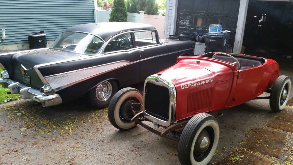

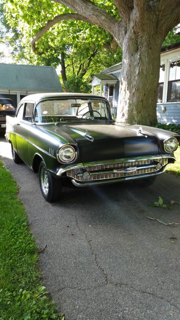

    Admittedly neither was done with rattle cans however the Chevy is a gallon of rustoleum mixed with mineral spirits through a gun- took a LONG TIME to dry. The roadster was brushed on tractor paint. Cheap is as cheap does, sir

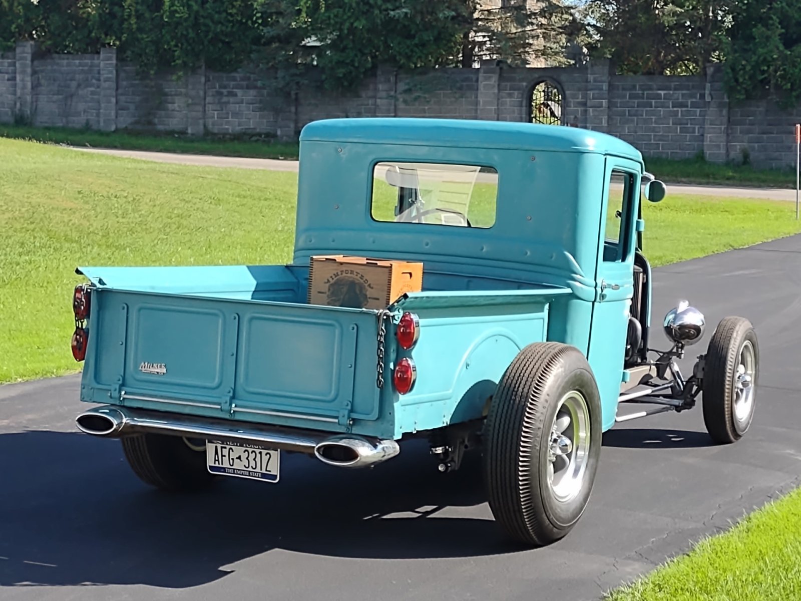

    Everything that has paint on my 34 is rattle can. (except wheel centers) I was gonna name it "Rattle Can Express" but haven't yet. Body color is Pontiac engine blue, it was too shiny, so I knocked the shine off with a Scothbrite pad. The steering wheel is the only thing I left with a shine.

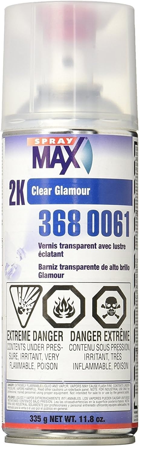

    I have a couple of OT pieces that I used this 2K clear in a rattle can on. Both projects are aces. One was a headlight ***embly that went from terrible to looking new. The other was a metallic 2 stage factory paint job that the clear had failed n one small area - it brought that right back.
    Paint Society guy on YouTube seems to have a lot of great tips.
    The Eagle abrasives no clog, dry abrasive system is surprisingly good.

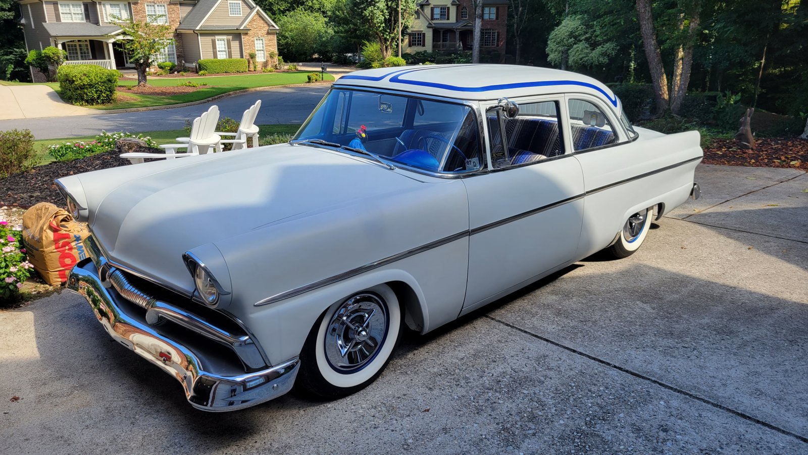

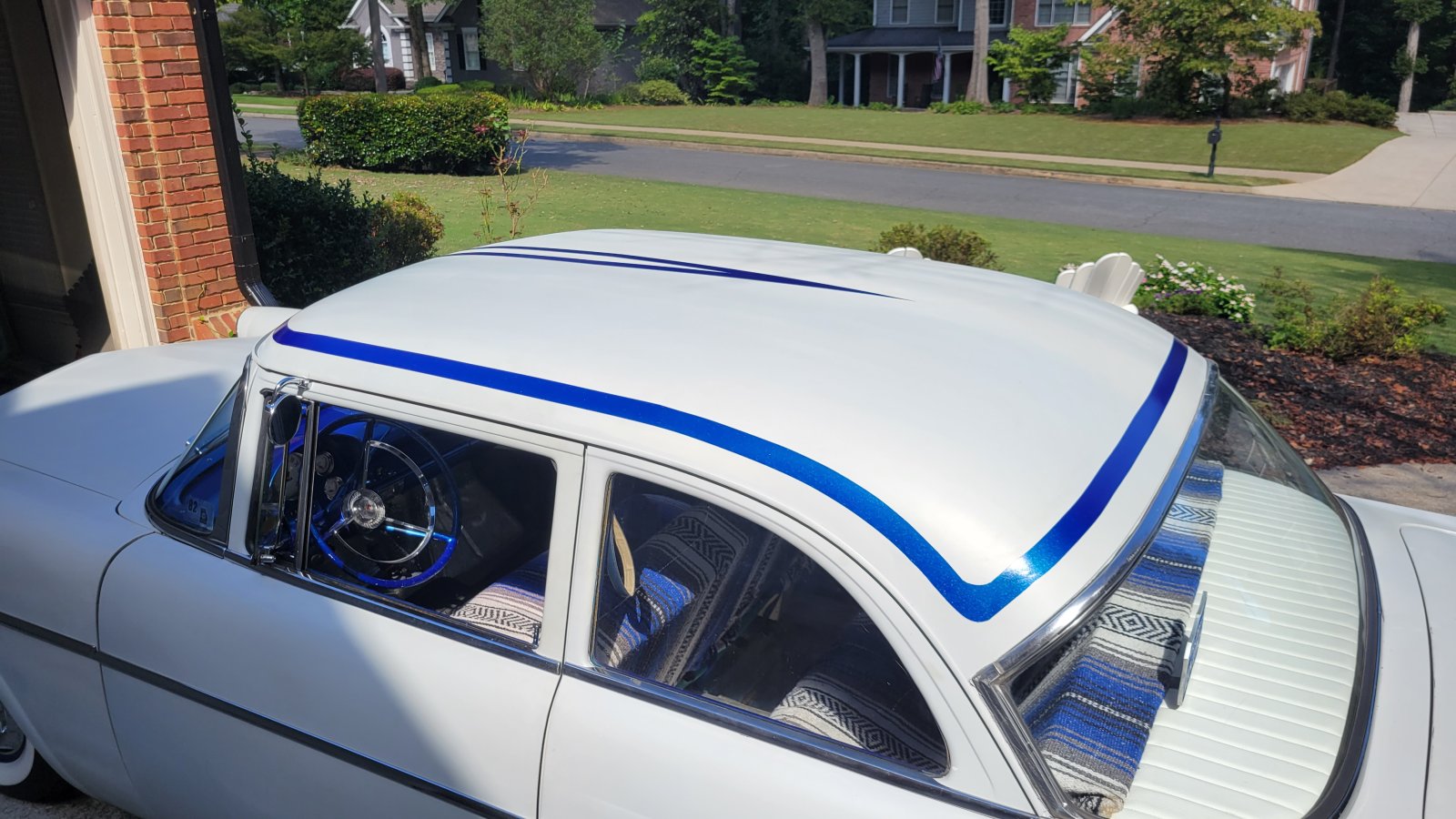

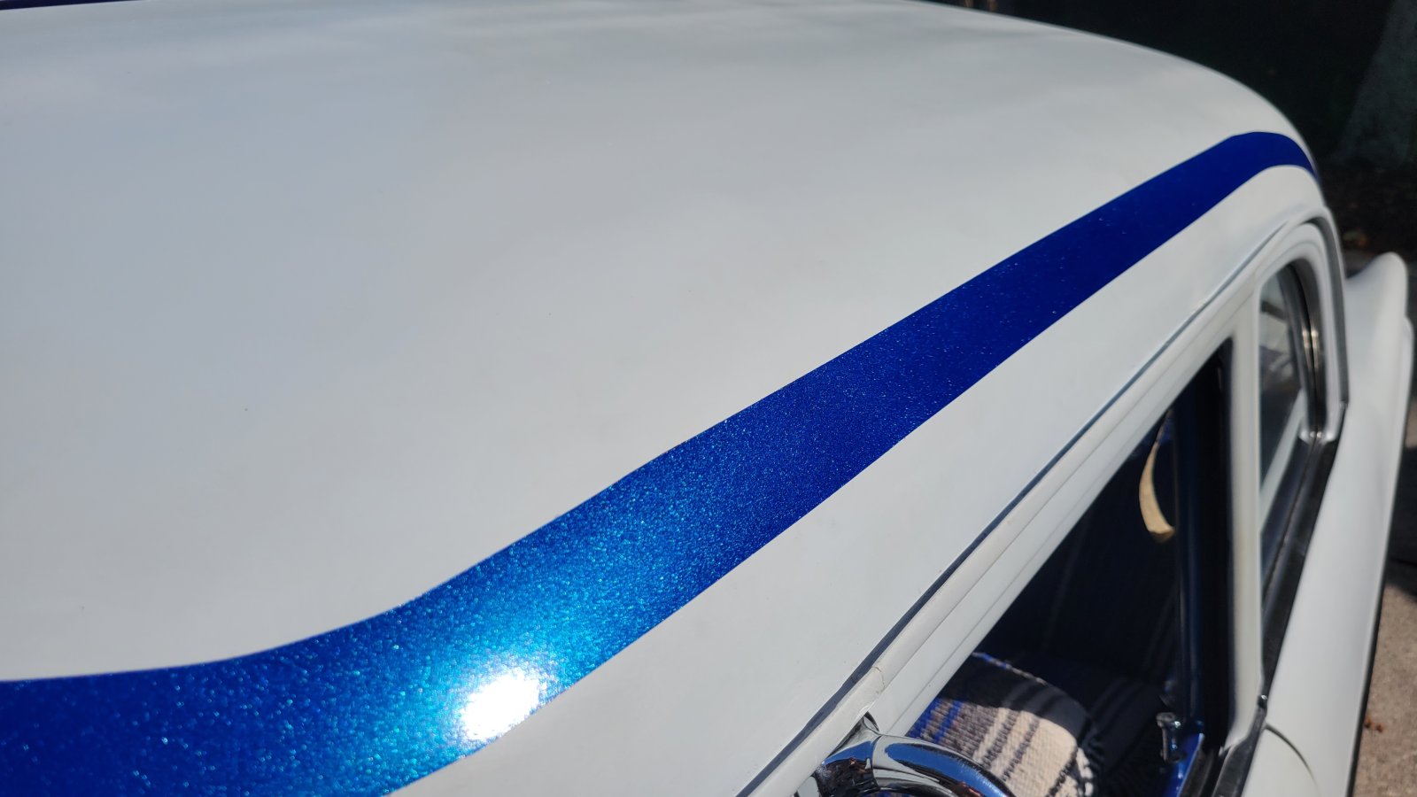

    IMG_20230718_182412645.jpg IMG_20230919_111449119.jpg IMG_20230919_111403660.jpg I did a black 3 in one paint then shot a glitter silver over the black to get a firewall that's different than anything I have seen.

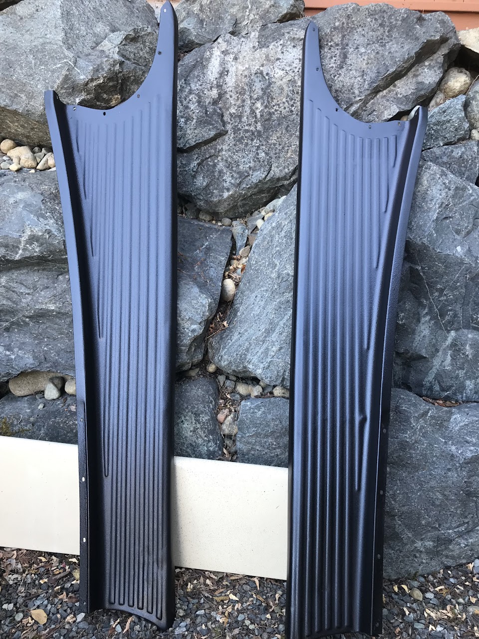

    I used rattle can bed liner on my running boards. It’s durable and and easy to touch up. Overall I’m happy with how it turned out.
