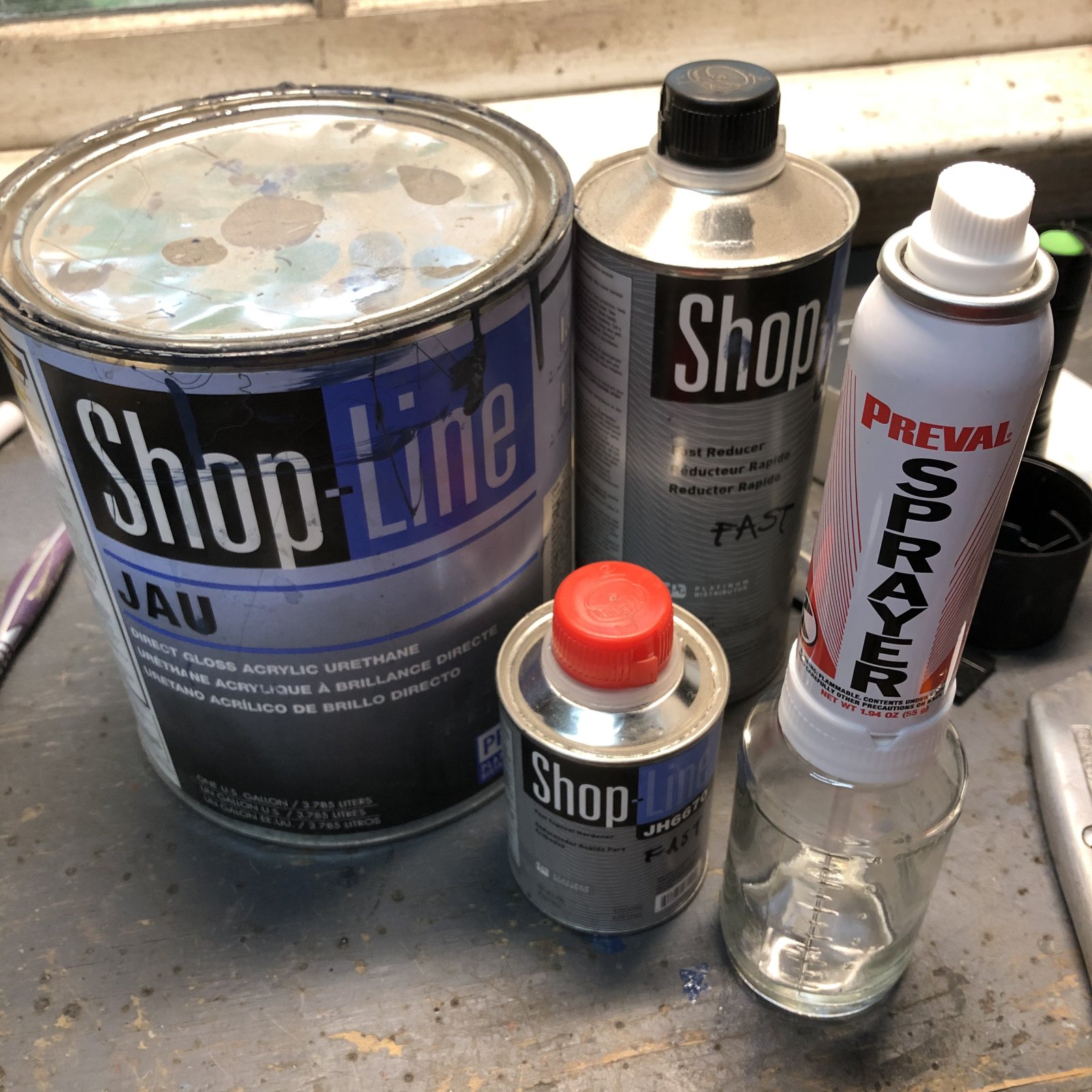

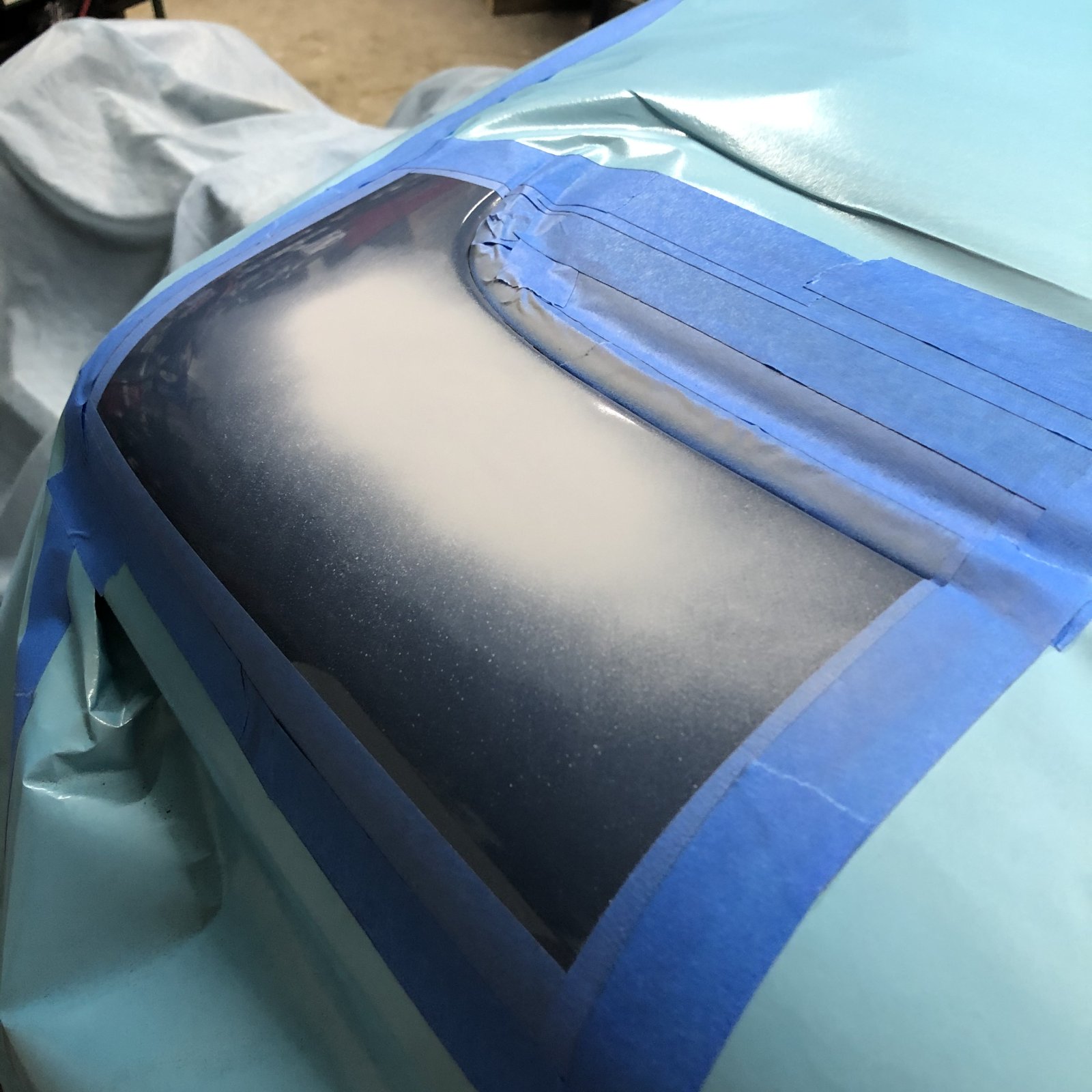

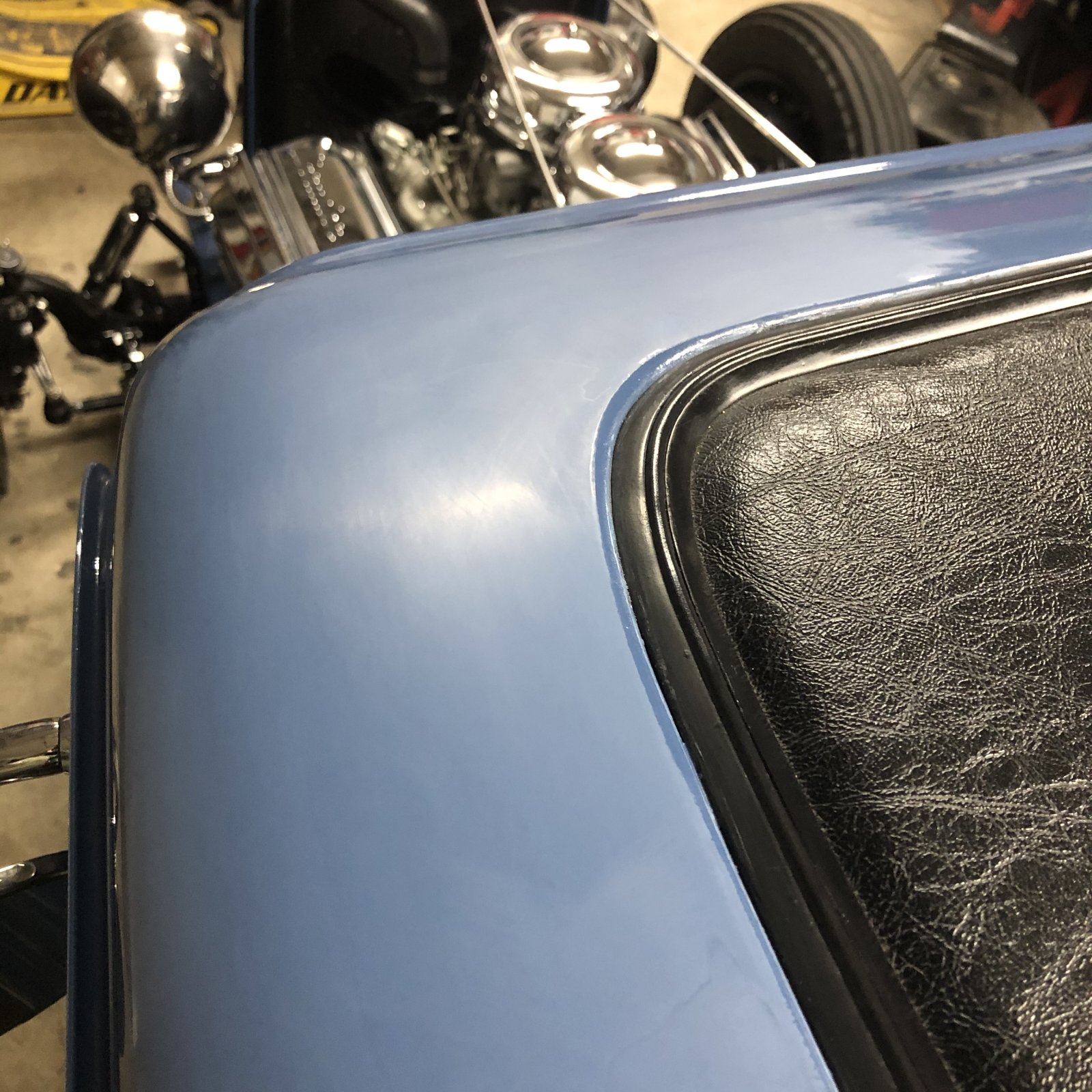

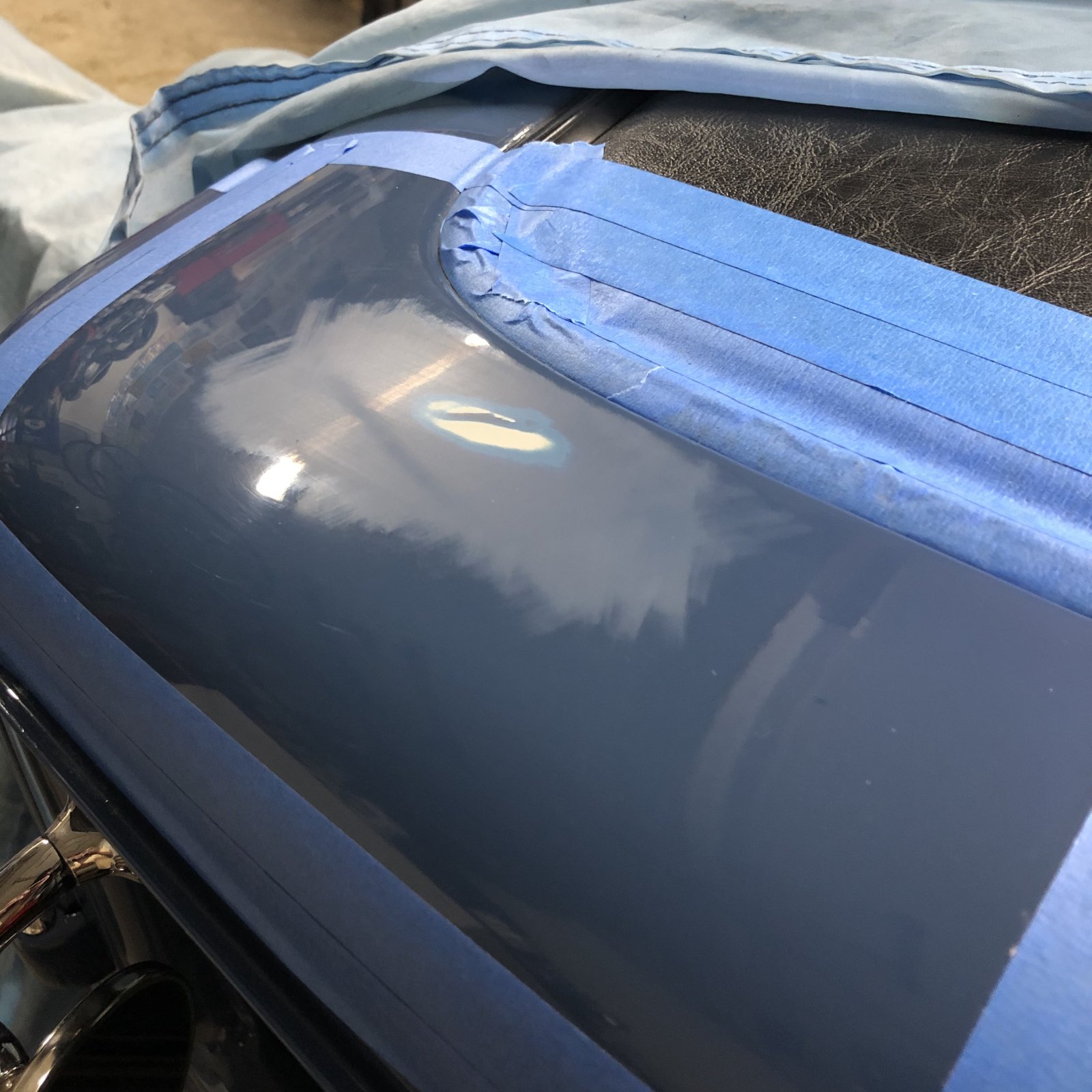

    Preface: This is not a rattlecan job, but equally low tech and low budget, so I thought it could be a good option for folks comfortable with mixing paint.
    I had a pretty bad scratch on my car that I tried to fix by filling it with paint applied with a fine brush and then color sanding and buffing to bring the surfaces to the same level. Welp, the color sanding stage got a little out of hand and I got down to sealer and filler, so I had to respray the area. I have a couple of spray guns and a touch up gun, but nothing that would spray a small controlled area. So in my airbrush research, I came across these little aerosol spray canisters from Preval. They come with a jar and allow you to spray any thinned paint without a gun or compressor. It was only about 8 bucks so I figured I'd give it a try. IMG_9517.jpeg
    Here's the area I needed to fix:
    A little rattle can sealer: IMG_9515.jpeg
    Feather the edges:
    Shot the single stage top coat with the Preval sprayer (could have been thinned a little more):
    Color sand the entire area up to 2000 grit:
    And buff the finish:

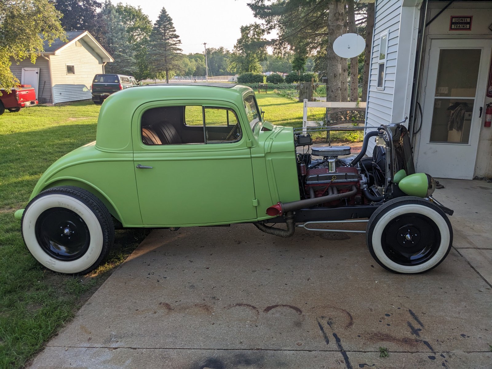

    Is this an automotive paint or just regular rusto off the shelf?

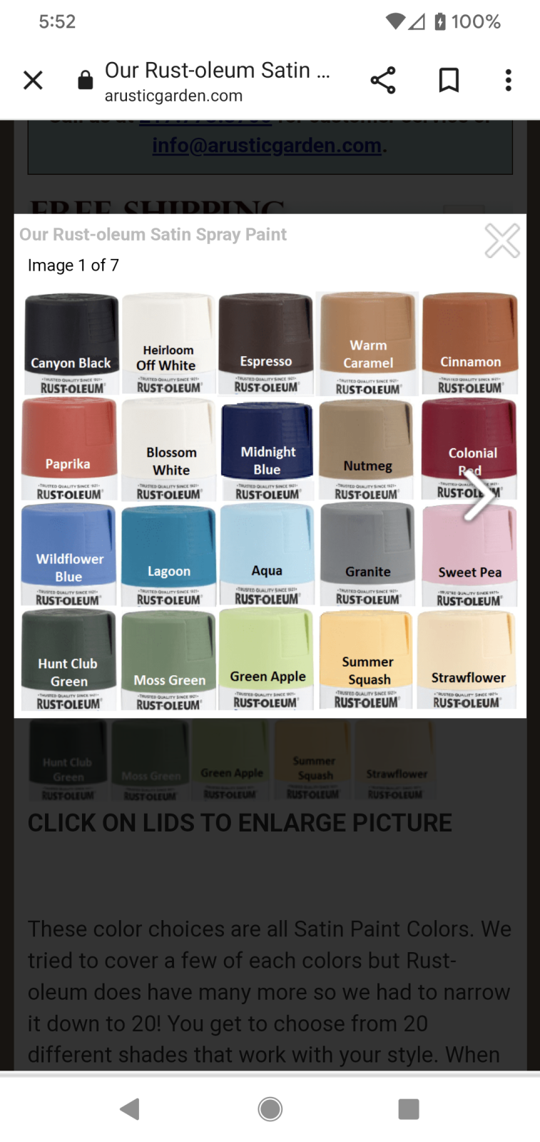

    Off the shelf, 2X Screenshot_20230924-175214.png satin primer paint

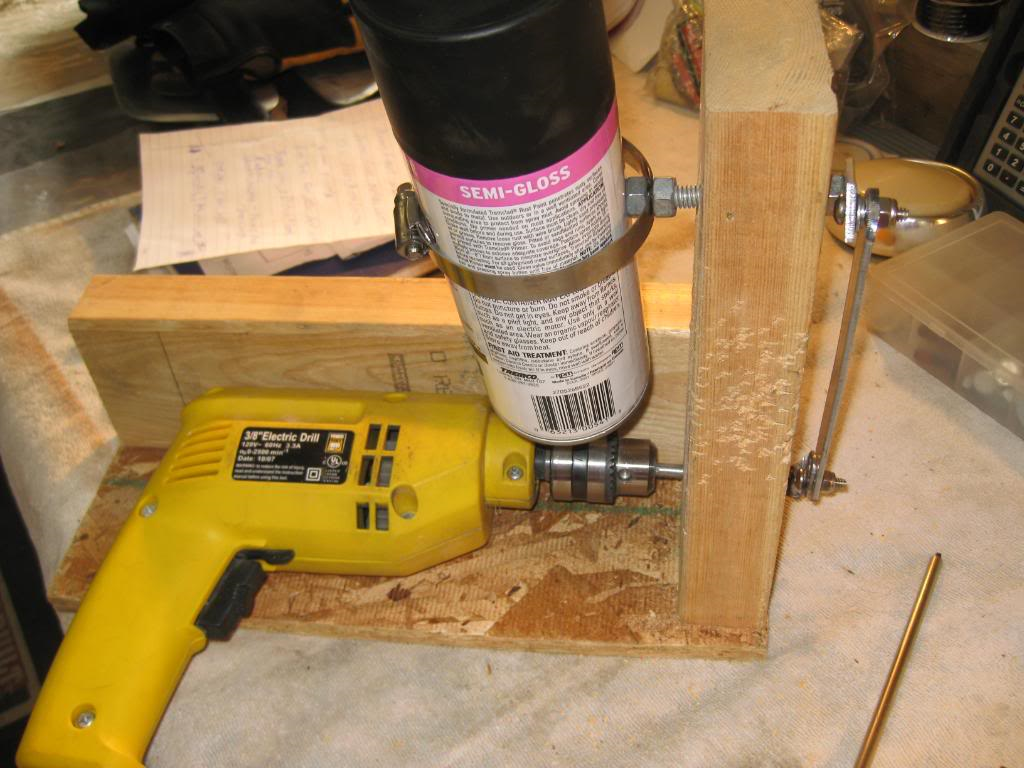

    Rattle cans are great but shaking them is a PITA. So share your ideas for shaking the cans. I have seen the hose clamp a can to a reciprocating saw trick but I’m looking for a better mouse trap.

    I used to have quite a few pix of home-made shakers but have lost all of them except this one and a couple of Sawzall types.

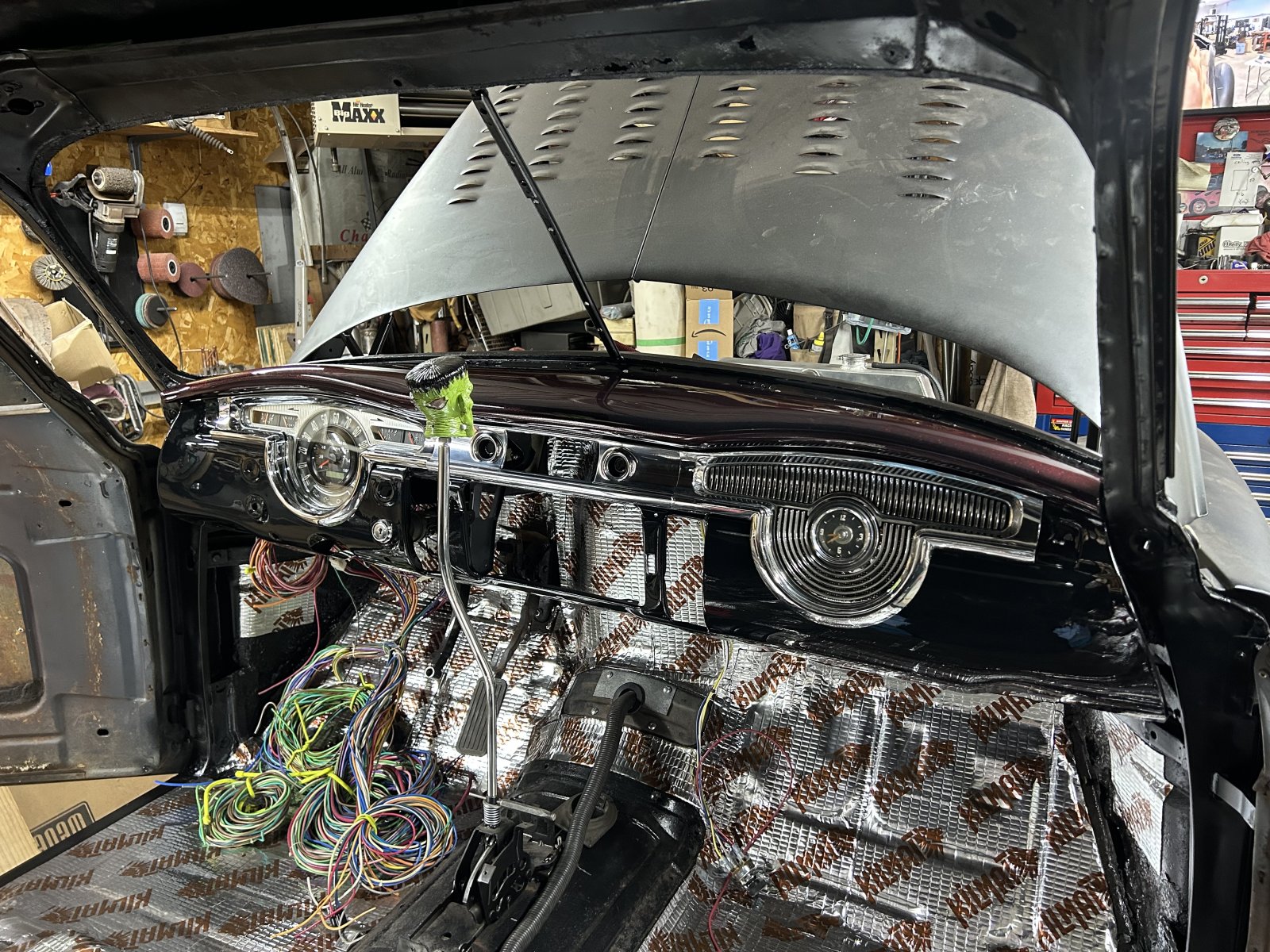

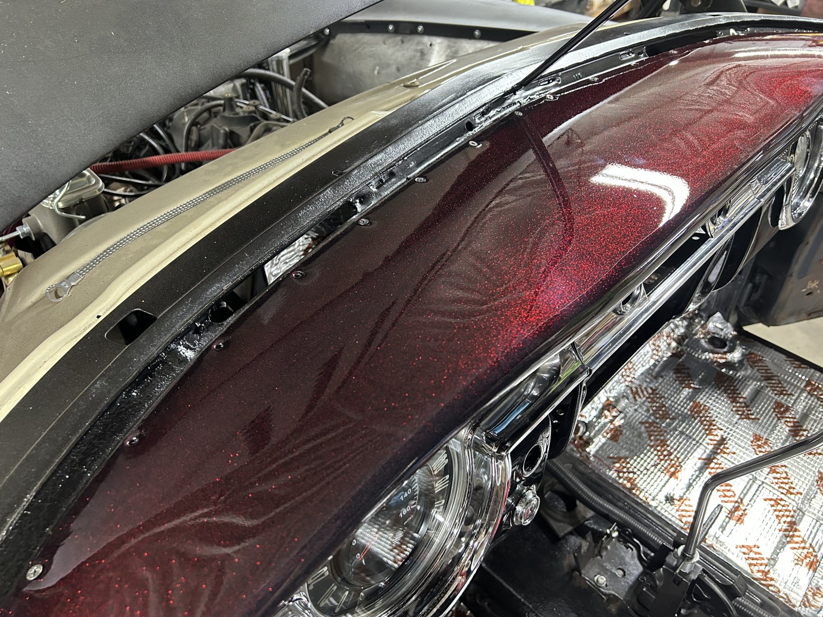

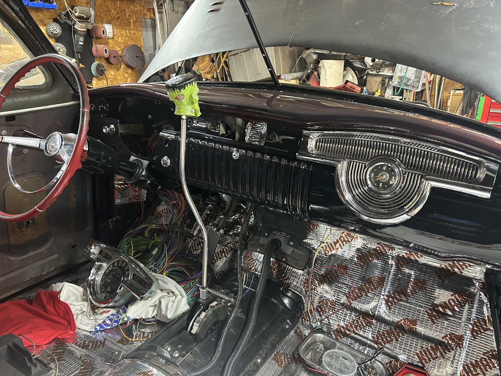

    The dash in my 50 Chevy. The black base then Lil Daddy Roth rattle bomb cherry pie flake and 2K rattle can clear over the top.

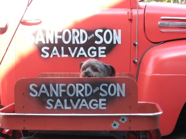

    It was a little scary, when I had to take the black rattle can to the doors on my Sanford & Son pickup 18 years ago!

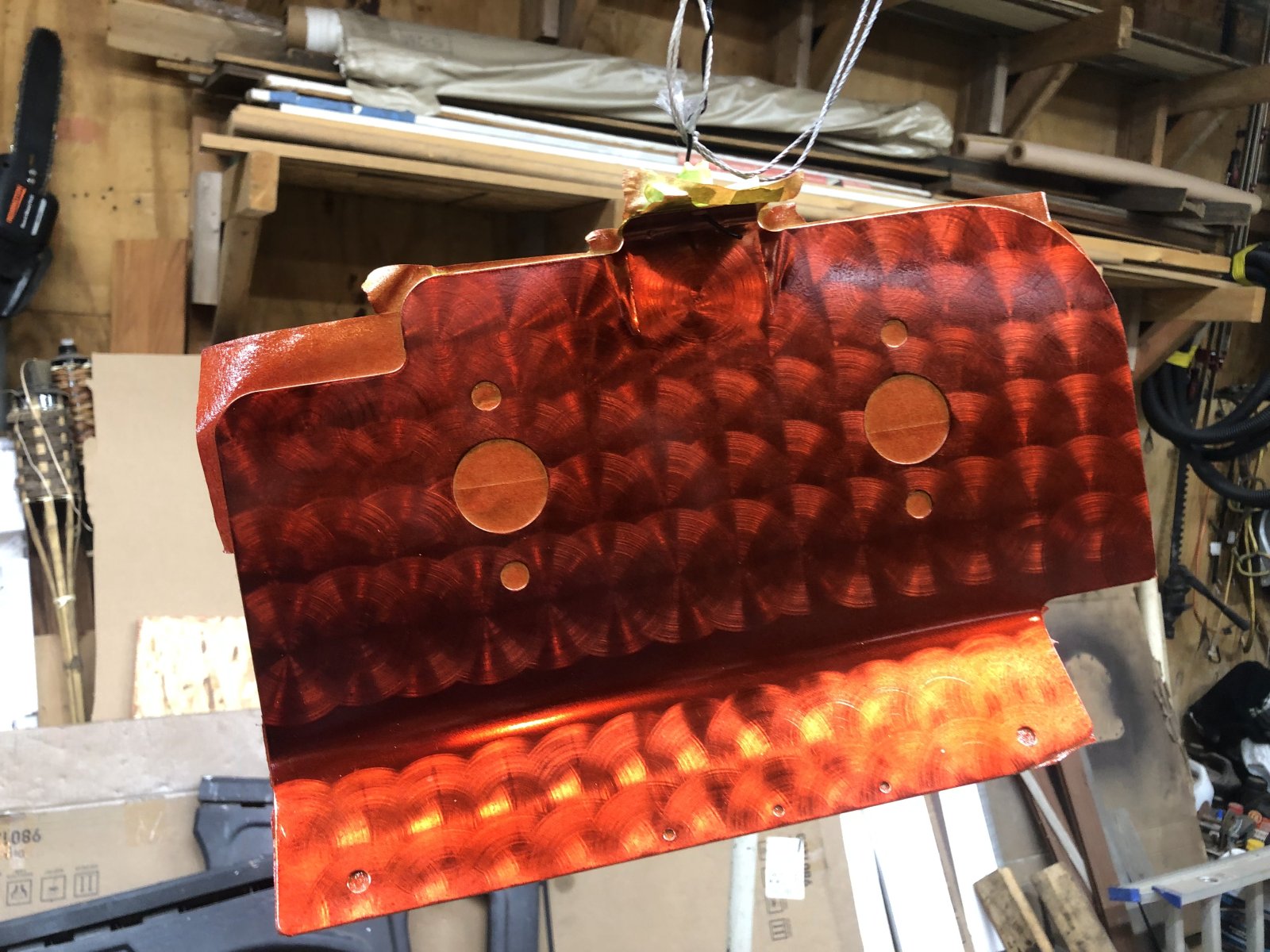

    Heat shield that I free hand engine turned and then sprayed a couple coats of Krylon metal cast and a coat of clear on the carb sided polished and cleared exhaust side. I am really impressed with the work you all do with rattle cans IMG_1830.jpeg

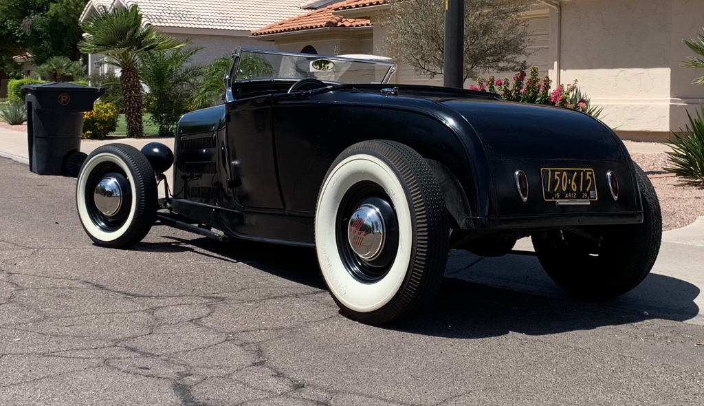

    My favorite roadster in Gilbert, Az.
    wonder if its still around ?

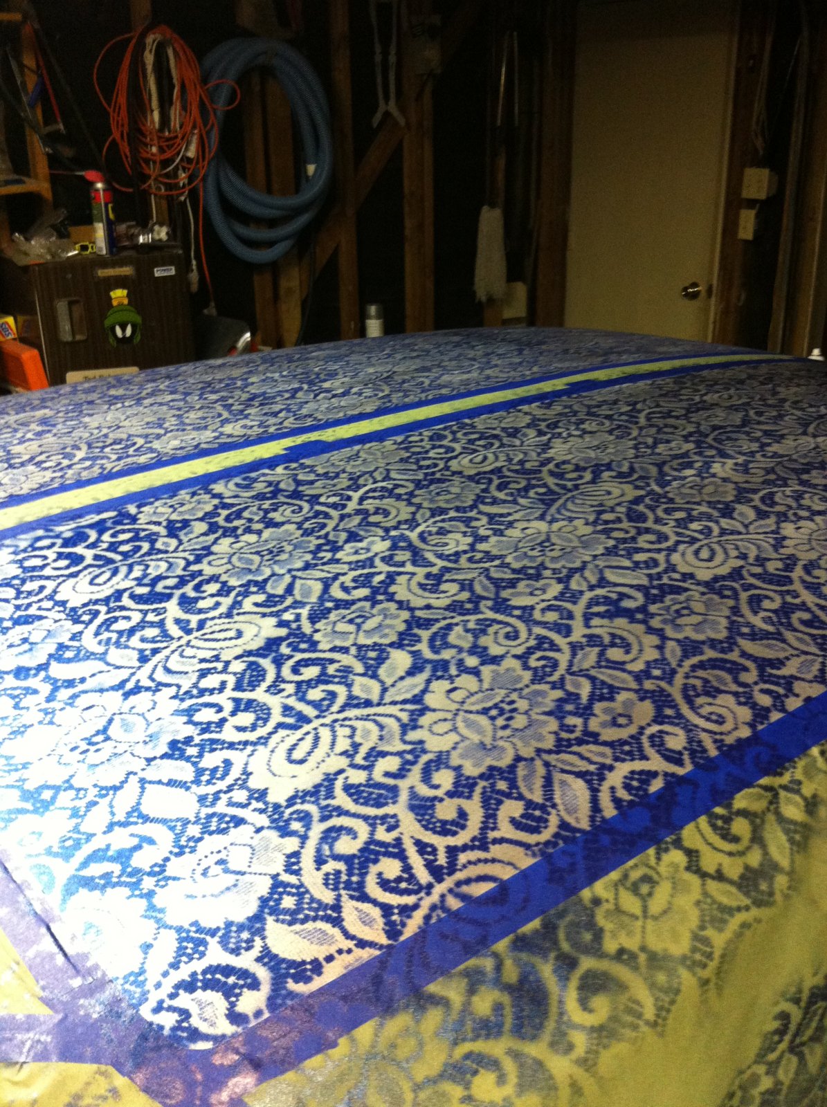

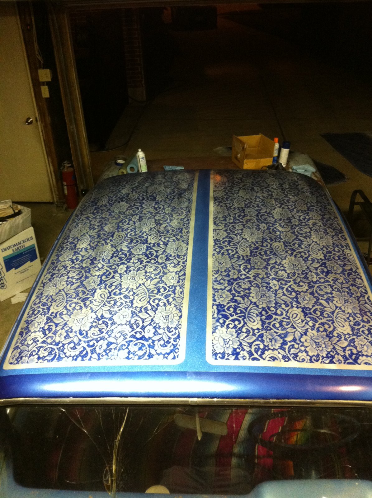

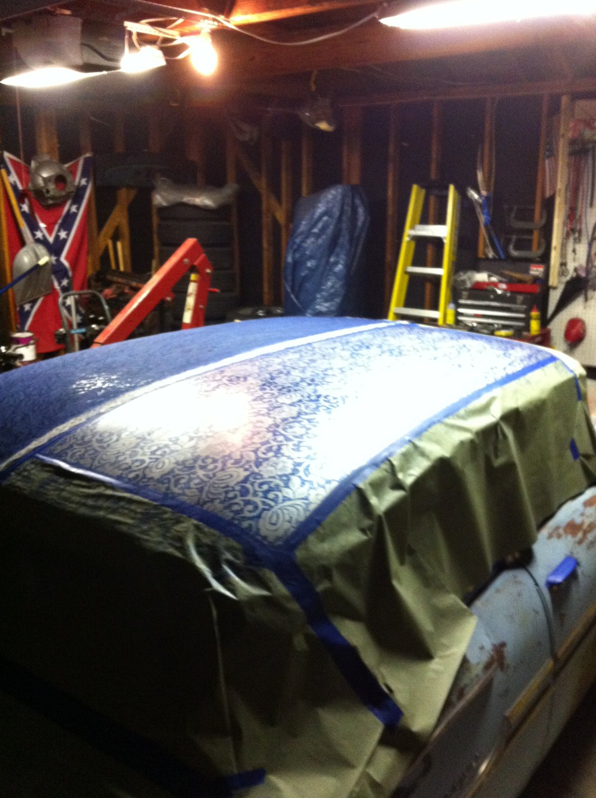

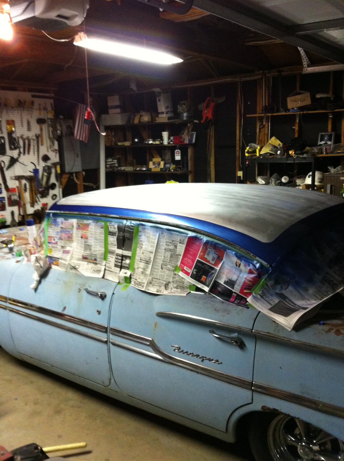

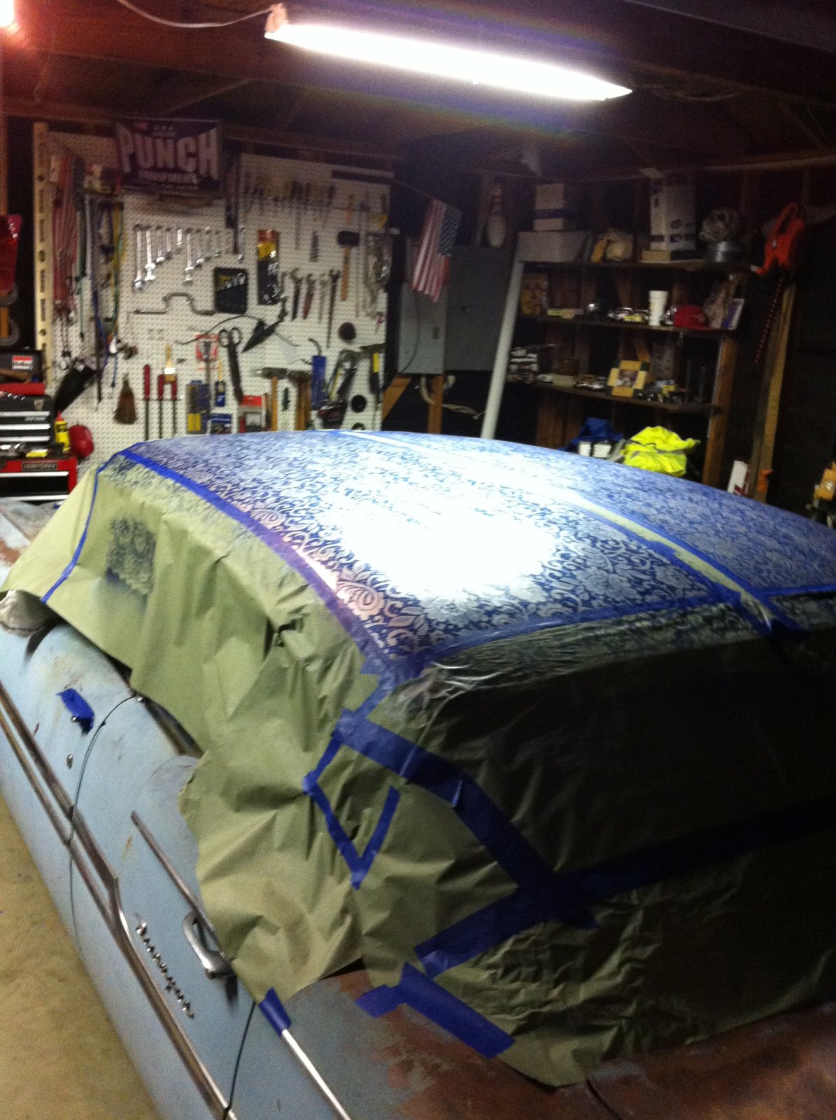

    Many moons ago I did a thread on the lace job that I did on the roof of my old ‘58 Biscayne. I miss that car. IMG_7574.jpeg IMG_0739.jpeg IMG_0746.jpeg IMG_0747.jpeg IMG_0749.jpeg IMG_0751.jpeg

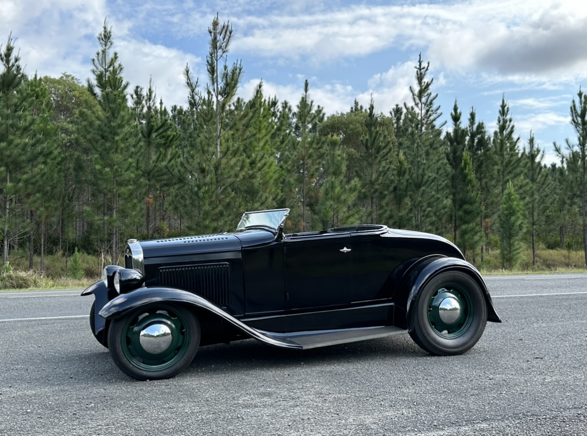

    Body and wheels are rattle can, ch***is and engine are paint brush.
    The trigger handle was a good investment.
