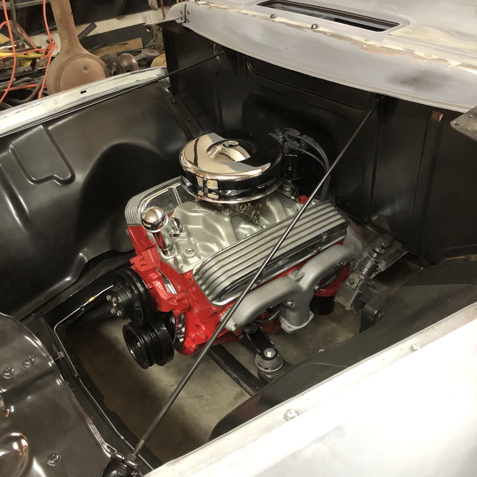

    Rustoleum semi gloss black rattle can on the firewall, inner fenders and core support. And of course the engine is rattle can high heat engine enamel.

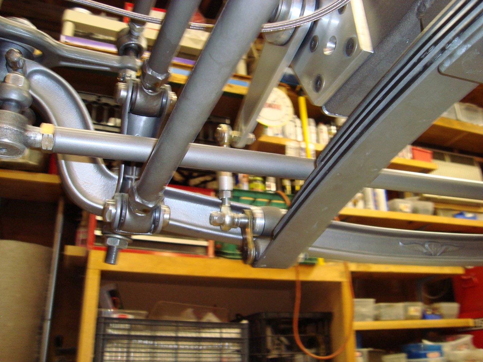

  14. 6C7FC7E4-AD22-4742-A5D8-0E76987E5E62.jpeg Everything on my truck is painted with rattle cans. Frame, axles, engine, body, dash, wheels, headers etc.

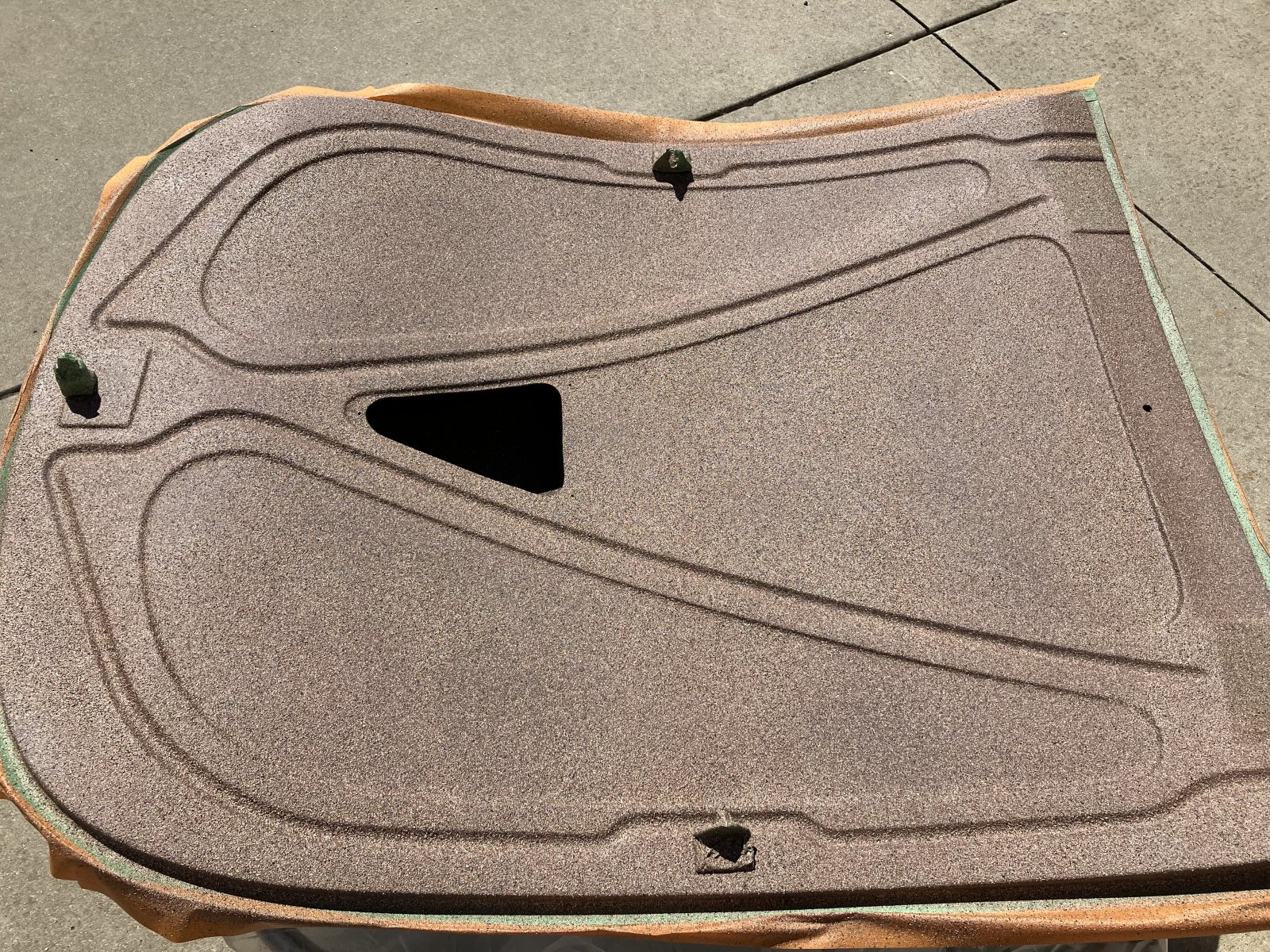

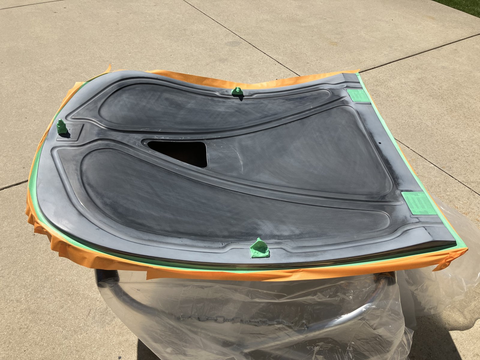

    Yes it is. Hopefully it holds up better than zolotone. Went on pretty easy, a few light coats with a ten minute setup time between.

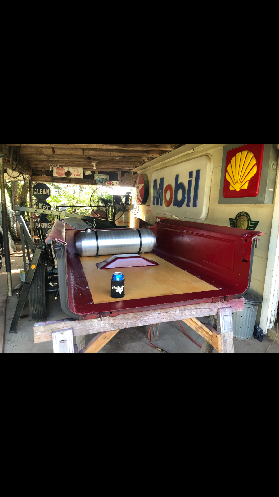

    IMG_20240103_165441.jpg IMG_20220717_132501.jpg IMG_20240401_110134.jpg Before and after, zero prep work, hardware store paint

    Nice to see the Crown Royal bottle....

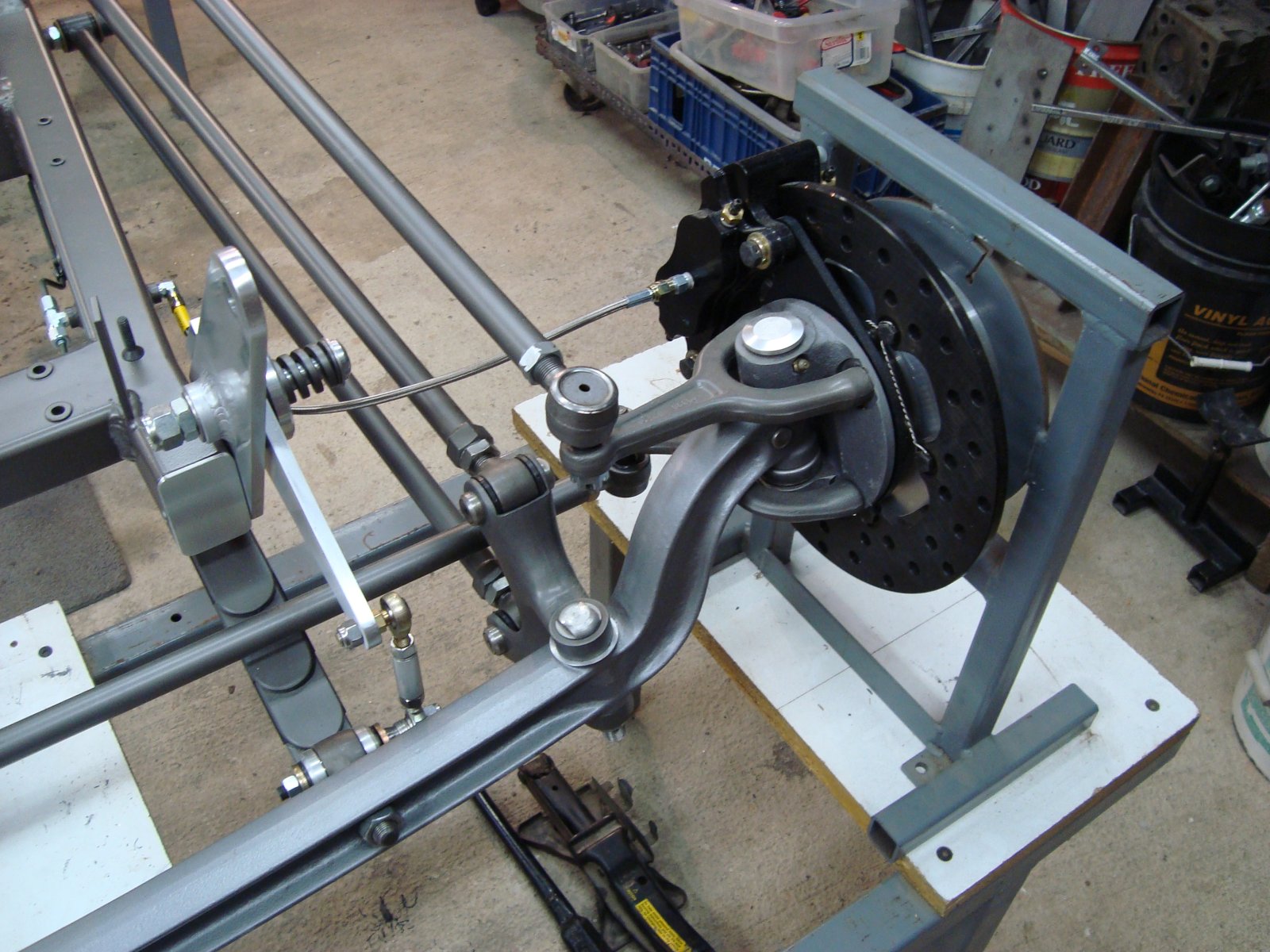

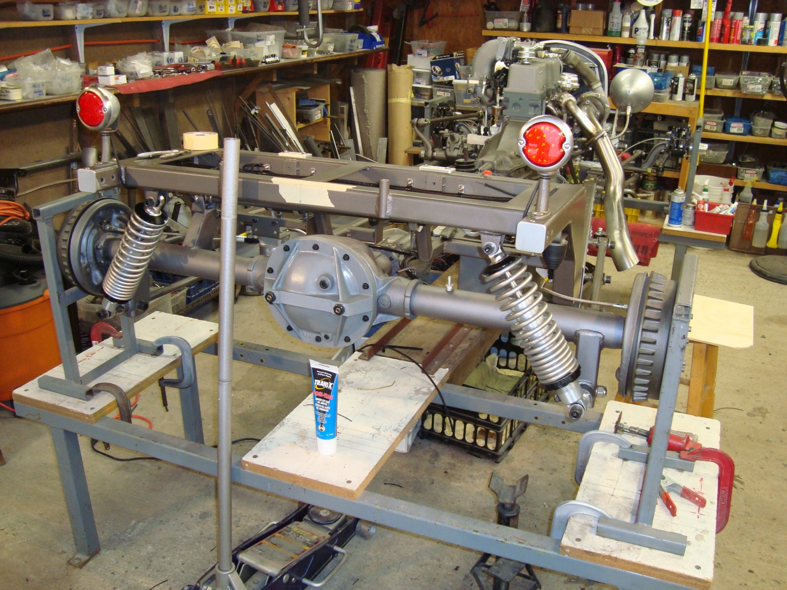

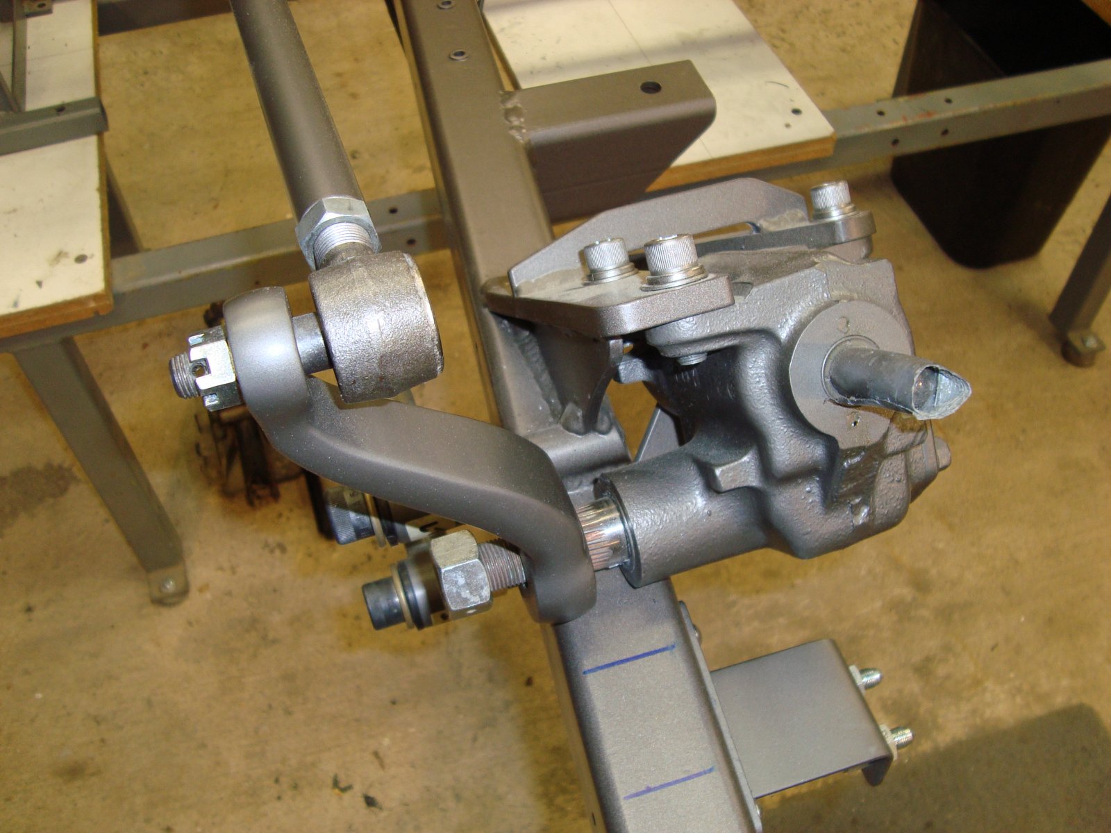

    Mostly everyting except body & frame ( had frame paint matched to rattlecan color ! )
    DSC00271.JPG DSC00293.JPG DSC00311.JPG DSC00657.JPG DSC00901.JPG DSC00907.JPG

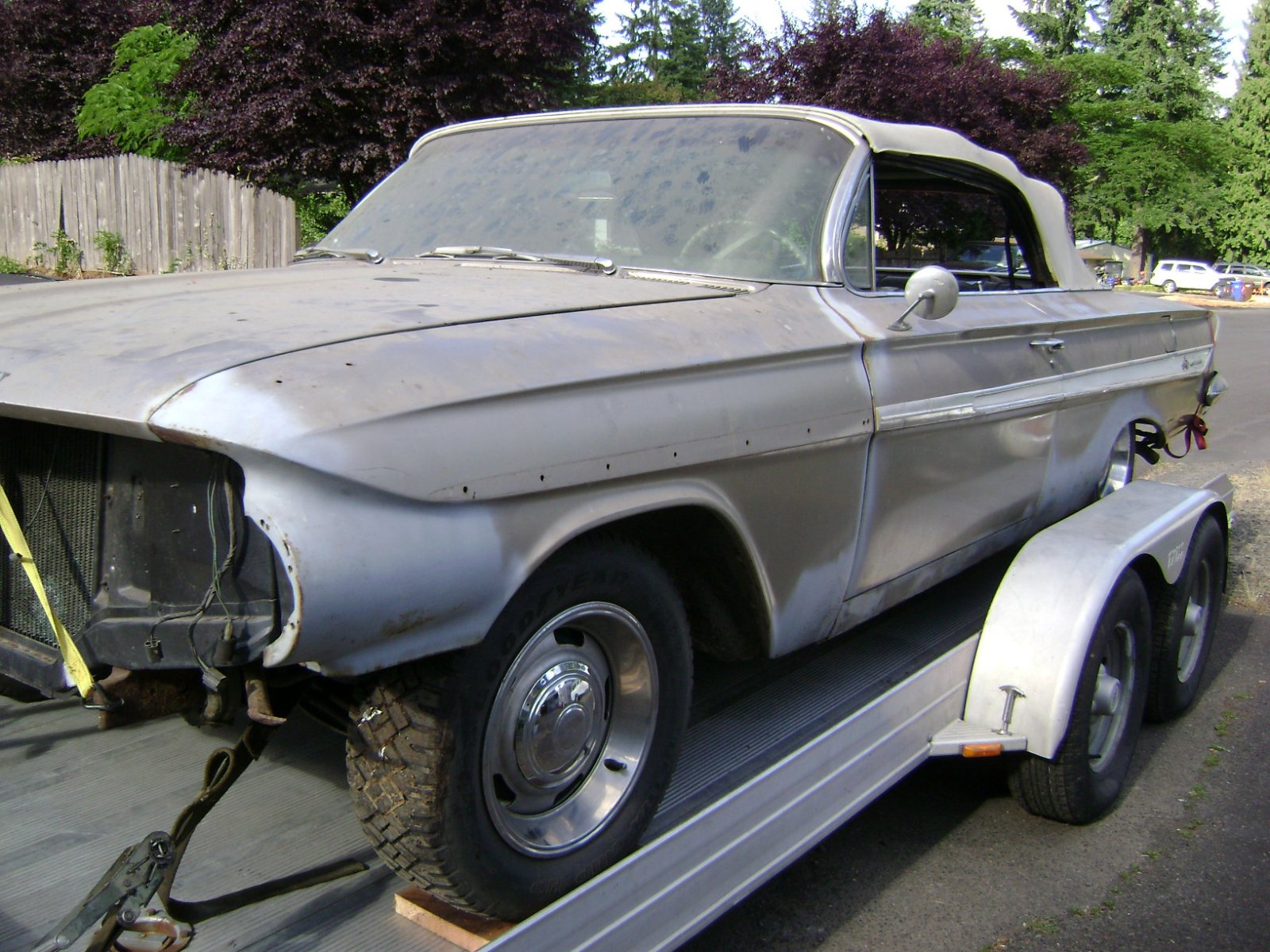

    1961 Impala, rattle-can from the beltline down and a few blend spots. Took 2 colors of Dupli-Color, light one on first then fog on darker color for match.
    VHT for the engine and Krylon semi-gloss fenderwells.
