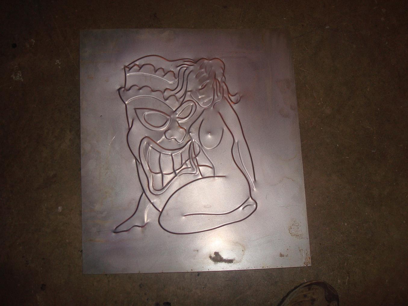

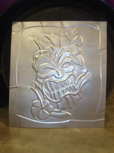

    well it not sheetmetal shaping, but a little beadroller work.
    johnny
