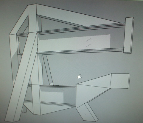

    I could show the build Mac but I don't think there will be much interest in my new wheel.I'm building A large wheel this time.Here's a rendering of what I got in my head.It could change depending if I find a good deal on the metal.
    I want a large upper wheel and 6'' lowers.
  23. BAILEIGH INC
    Joined: Aug 8, 2008
    Posts: 3,629
    BAILEIGH INC
    Alliance Vendor
    Wow! :eek:
    That is a beefy wheel!

    I think there would be some interest. I am interested, anyway. Haven't built one yet (hopefully this summer) - the more designs I have to look at, the better. I like the I-beam bit - that thing looks super tough. I'm sure i won't build anything that big the first time around, but anyone (including me) who builds a little one and really uses it, is likely to want to go back and build a bigger one down the road, so it would be nice to see more build-ups of of big ones to reference when the time comes. A small benchtop will do for the projects I have underway (patch panels, cowl work, etc), but when I move on to the next project I want to build (definitely not going to be this year), I will probably need a big one.

    I would recommend building at least a 24'' throat.Leave your bottom tool arm as clear as possible.That's why i prefer a upper adjuster.i built my first wheel with out having a clue on how to use one.Now I kind of have a little better understanding and there are defiantly things I want to improve.
    I believe the c frame is the way to go.If you look at Imperial English wheels,that is the best design out there.If I were to buy one that would be my first choice.
    If I were to build one I would first figure out what I was going to use for a adjuster.Next I would figure out what material I was going to use for the frame.The heavier the better.Then I would cut some plywood strips the same dimensions as the frame material.then cut my frame out of the plywood strips and get everything line up perfectly.
    The more precise it is the better it will work.If i wasn't so broke I would just order one.I can afford a harbor freight English wheel but I would rather just burn my money then buy that piece of junk.That's just my personal opinion.I'm not a big fan of harbor freight.

    I would like to get a larger set of lower anvils, and build a tank of an upper wheel.
    Lets start talking about this wheel more and make one, improve on second, and make them with the slide idea, for easy lower arm movements.
    Im not going to make this a tool thread, but lets get to thinking of it. I have a couple more ides, but nothing really new.
