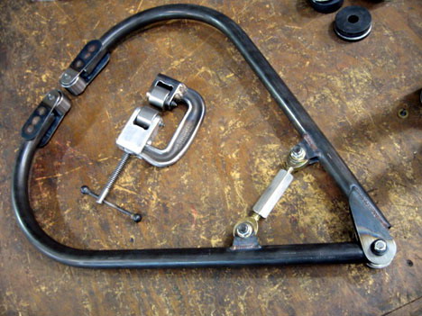

    Very interesting english wheel. Do you have any more pictures of it? Did you make it?

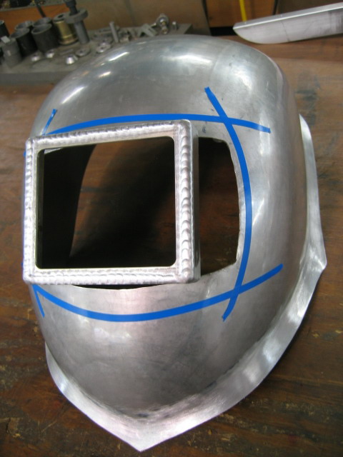

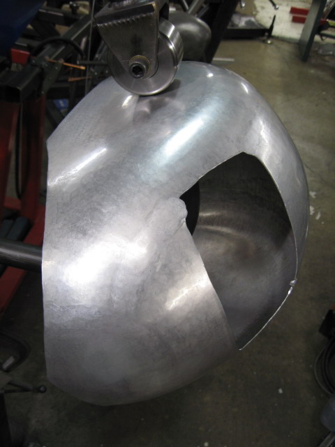

    Hey Shane,
    Thanks for the comps - I have made almost all of my metal crafting tools - but I use Hooser Patern Upper & lower wheels on most of my machines.
    Here's a few more pics.

    Rick, Ive had a look at some of your threads at Metalsapers ***ociation over the years, Just one question where the hell do you get the time to build all that stuff ???

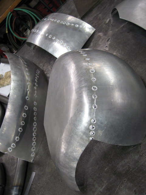

  9. very nice. tig welding will definitely take some of that grinding time away, but flawless fender.

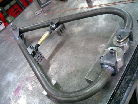

    Woody - Ive been doin this for close to 30 years - lots of 16 hour days - lots of 7 day weeks - & I love it.
    The deep reach E wheel frame's are GREAT for getting farther into a shape - I made it for getting into area's ( after ) they have been welded - but the more I use it, the more way's I find to use it.

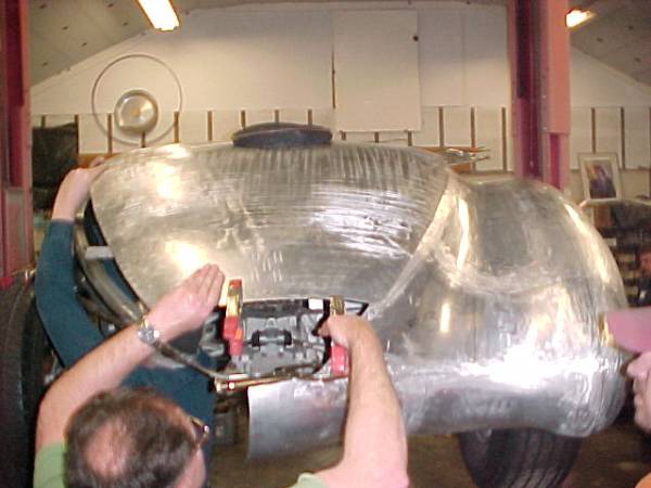

    Tell us more about this shot Shane.
    How many pieces is it, and do you know about the processes done in it? Was the cntr welded in after hydraulic forming the main body, or? Who did it?
    Interesting concept
    BH

    Nice Job JH!!!!! I love the fact that your not like alot of metal gods that I know. Their **** dont stink put they sure as hell say that everyone elses does. Keep it up. I have been doing this stuff for over 25 years and I would be hard pressed to do the same quality you did on the fender!!!! Nice stuff man. Keep practising with the tig. Onces I got the hang of mine, I only use the mig for quick tacks. You will spend about an 1/8 of the time grinding with the tig. A metal forming post is a must. We are all a bunch of closet formers. Knowledge is power. Power to the people.

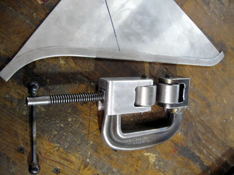

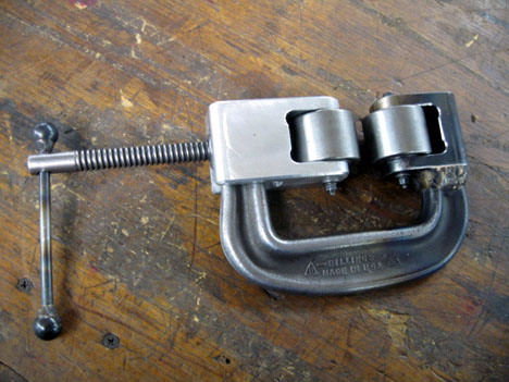

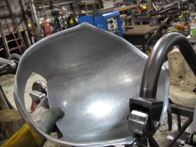

    Well I have 2 peices made. The first is the front section. The guy who owns the fenders bought the front peices, but they were sad. I made one instead. First here are the tools I made to do the bead.
    [​IMG] [​IMG][​IMG][​IMG][​IMG]
    I also made a few post dollys. The fender beads were the same or similar for quit a few years, so I am sure they will be used again.
    I started out bending and stretching the bead. There is alot of shrink that goes into the corner, plus the stretch is needed to get the shape.
    Then I started it around with the vice grip.
    Once I had it started I used the hammer to work the shape in. The corner I did some stretching to get it started. It would be very hard to do it without the stretch. Shrinking the edge just isn't enough without cutting and getting rid of extra metal.
    Then I wheeled some shape into it. It has the small reverse curve where it meets the running board. I stretched the outside edge over this cone I made with a truck spindle.
    And I did some stretching inside the panel above the inside curve. And to take it a little farther I did a little heat shrinking.
    I am making peices at this point because I don't have the car available. I want to bolt the fender to the body before I weld it all in place.

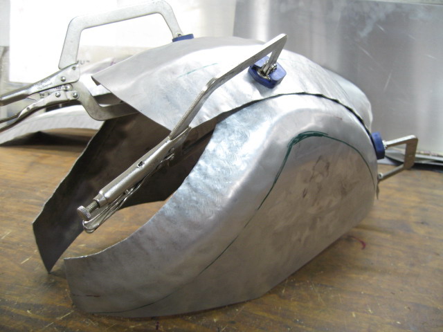

    The second peice is the rear section. I started off making a tape pattern. In the end I made two. I made one that wraps around the bead, and a second that covers the flat up to the bead. The first one is valuable because it tells you how much shrink and stretch you need in the area around the bead. The second I use to mark the panel to make the final cut before I run the bead.
    This is my arm saver. I use this to put stretch in the center. It really dosn't bother me to stretch more then shrink. I have it in my head that when ford stamped out the original fender it was mostly stretched into shape, right?
    Here it is roughed out.
    After wheeling and the edge started around.
    Stretching the edge a little more.
    Here is a shot of the edge done up to the corner. I use the torch to shrink the edge and close the corner.
    I also had to do a little heat shrinking in the center.
    I use a rubber top wheel to form the curve on the top. It dosn't stretch like the hard wheels. It just bends the metal around the lower anvil.
    This is what I ended up with. It fits the pattern great and the form is good enough to start welding in place.
    Still needs a little tweeking to be perfect, but it will anyway after I weld the whole thing together.

    Looks good dyce. I have a fender that needs the rolled edge repaired, and I was wondering how to go about forming the roll. The modified vice grips look like they will do the trick.
