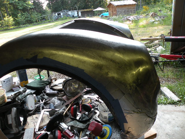

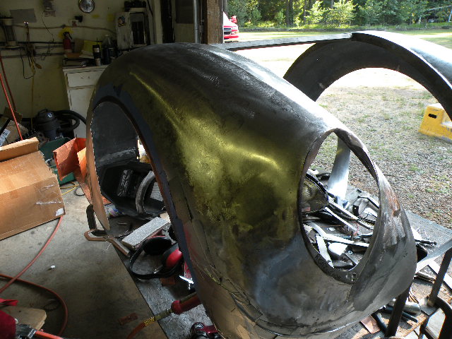

    Here is the lates update on the 41 COE front fenders I am reworking almost ready to start on the lower front chin into wheel arch area, what do you think Danny.

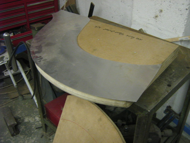

    Here is my effort, nothing fancy, the start of a front wing in ali for a 1930 Alvis .. pics should be easy to follow. actual forming took abut 30 mins..!! formers took longer.
    Im always interested in shaping with a pullmax / trumph.. I bought a Trumpf, cheep, s a future investment, Ive converted th motor and have it runing but never made a single dent with it yet .. :(
