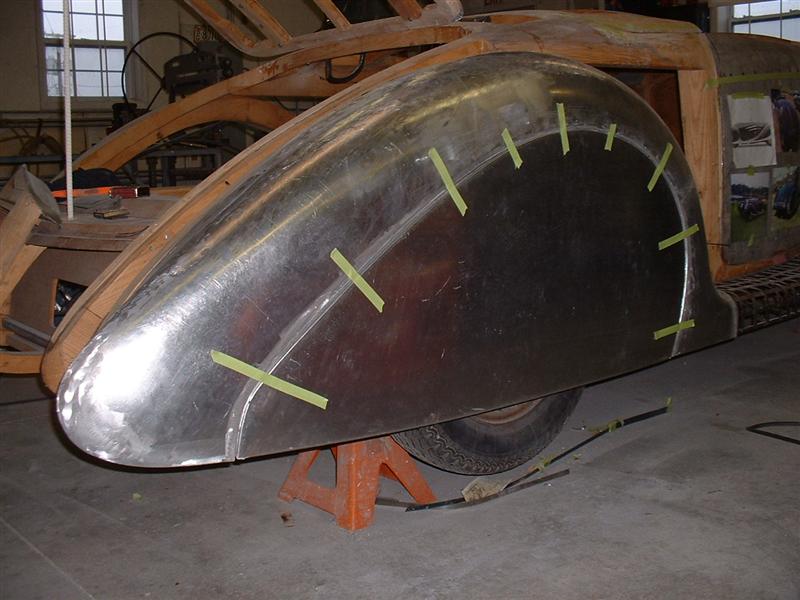

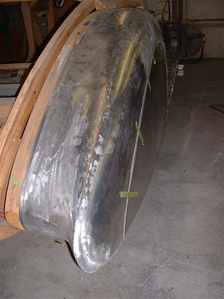

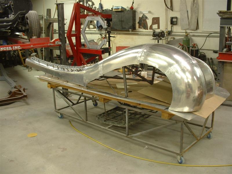

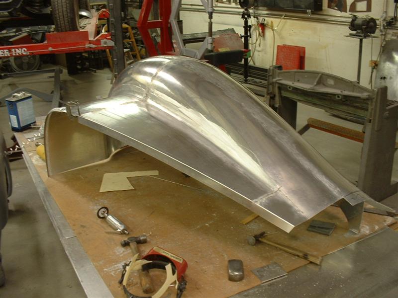

    Here's a few more.

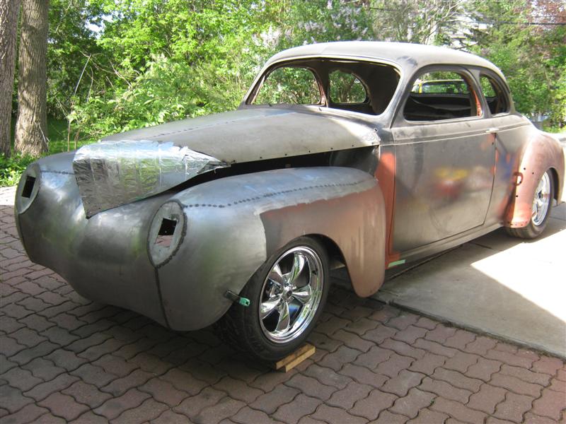

    Here's my project. De-uglifying a 41 New Yorker:
    Pugsy
  16. pimpin paint
    Joined: May 31, 2005
    Posts: 4,937
    pimpin paint
    from so cal
    Hey Pugsy,
    Good lookin tin on the Chrysler...........................

  18. 123pugsy
    Joined: Apr 8, 2010
    Posts: 77
    123pugsy
    It was made of 4 pieces until I had a little boo boo and cut out a patch and rewelded.
    So its 5 pieces.
    Fender tops are 2 pieces each and outboard of the headlights are a piece each.
