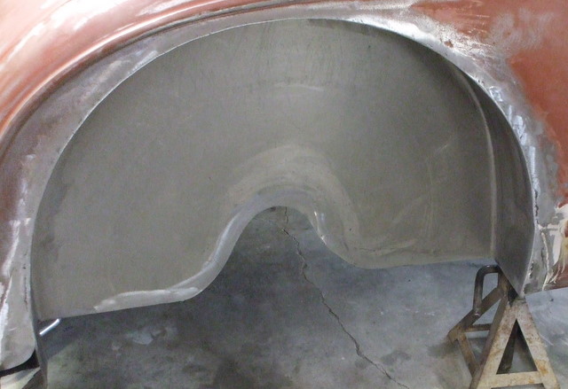

    Simple fender well
    Took a paper pattern and then transfered it to two pieces of plywood. Then routered one edge.
    Cut a blank one inch bigger, then sandwiched the blank between the two pieces of plywood. Then just hammered the metal over the edge.
    Before pulling the blank out of the hammer form I slid the side's in between the metal and the plywood so I could scribe my line.
    Then I separated the two pieces of plywood and screwed one of the pieces to the edge of the sides to hold it in its shape. Then tacked it with a mig and welded it with a tig.
    Then cleaned it up a little, I didn't go overboard most all of this won't be seen.
    Fitted it to the car and trimmed and welded to car.
    I still need to make a body line for it .

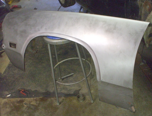

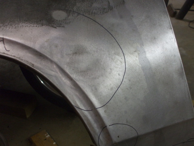

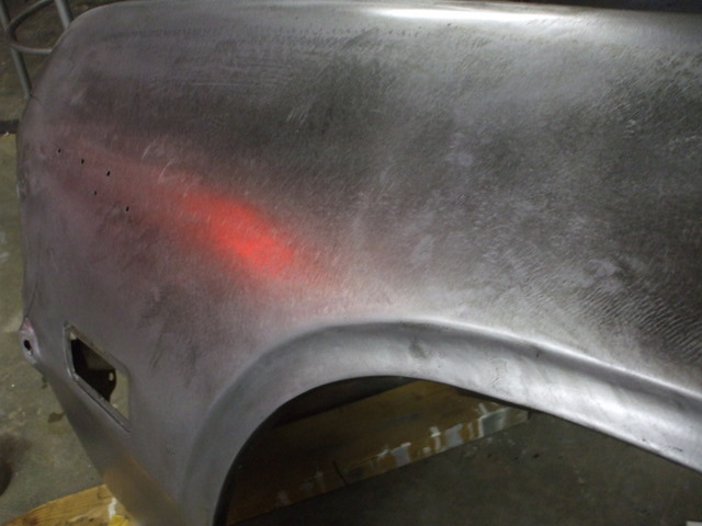

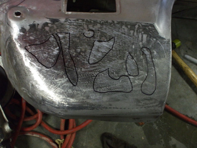

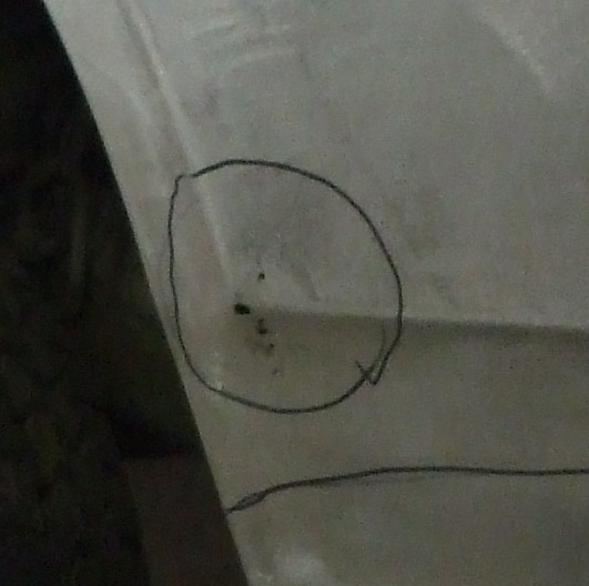

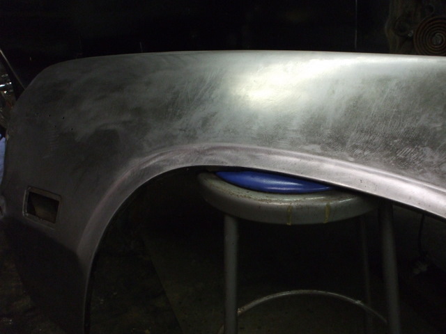

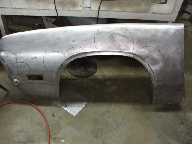

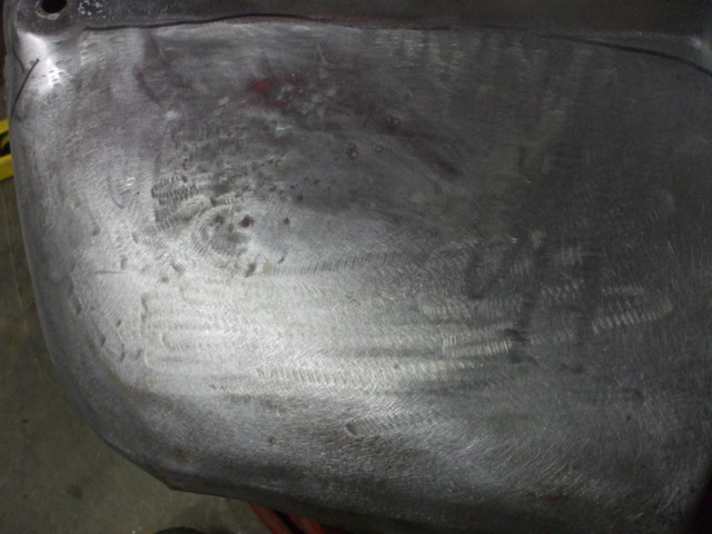

    Well here is some hammer dolly work for you and my special friend the shrinking disk. If I can just get it close, the shrinking disk really tunes it in.
    Here is a ratty fender that was filled with a **** load of bondo.
    Here is a area on the fender that was way over worked and was done terribly wrong. So then they gave up and floated a 1/2'' of bondo over it.
    I worked it a little with a ******* and dolly and then went over it with the shrinking disk.Then went over it lightly with a dull file and marked the high and low spots. then worked them accordingly.
    It's not perfect but it is far from needing a 1/2'' of bondo.
    Here are some other pictures.
    Still need to do some rust repair to the fender and weld up some cracks.

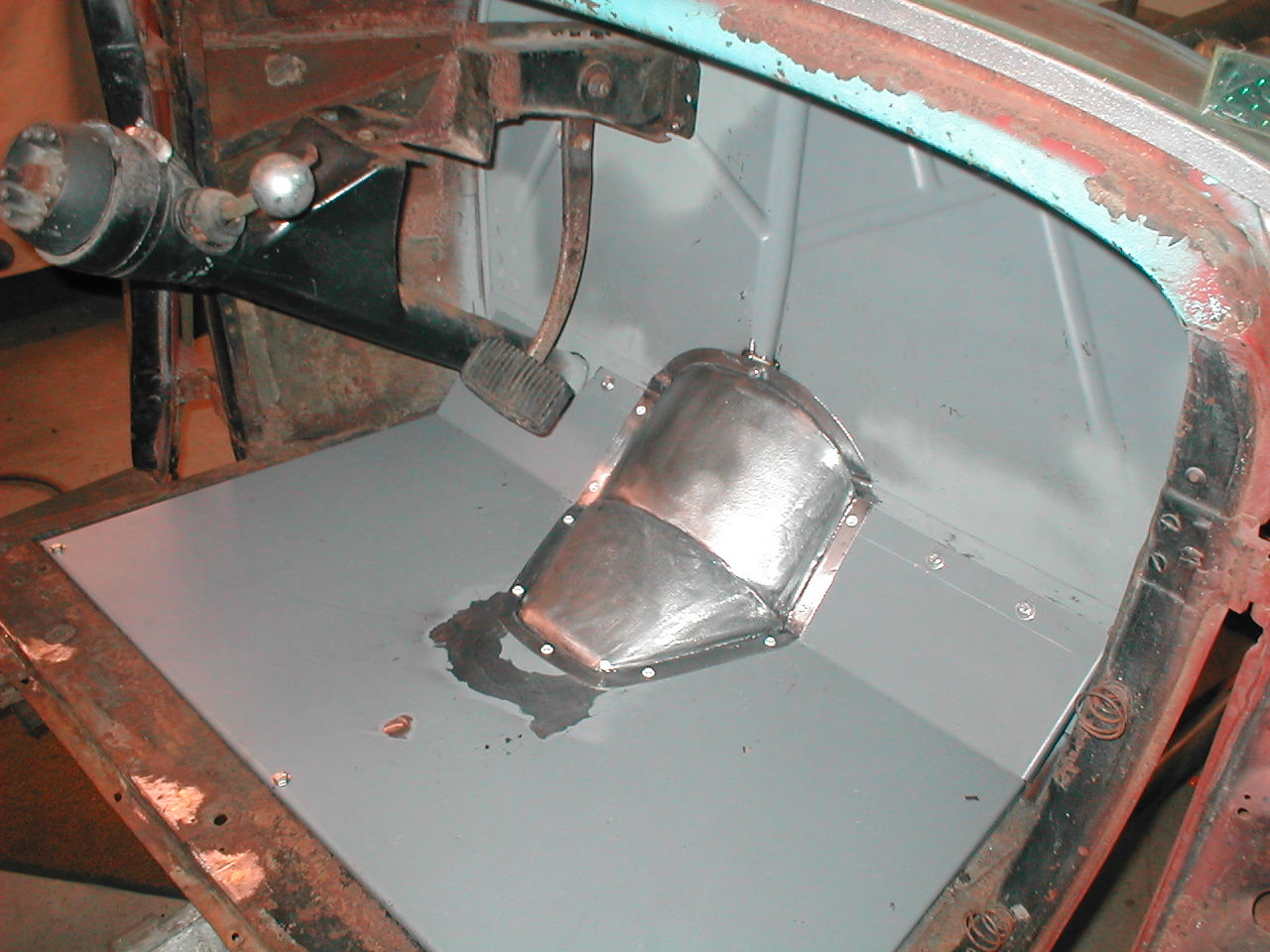

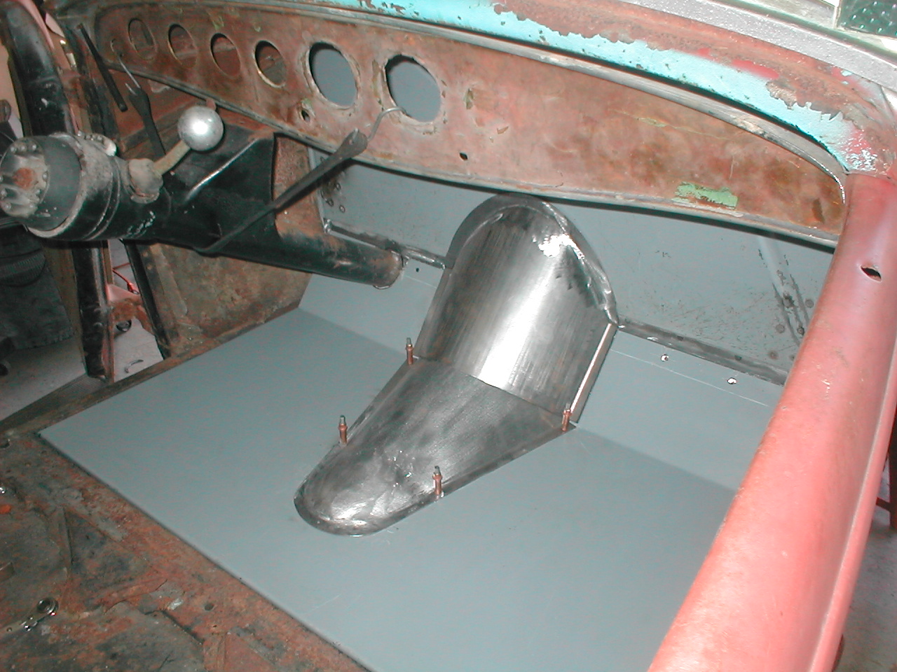

    here's a few trans tunnels I've made for a 32' roadster..

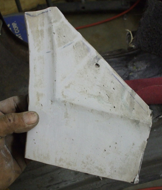

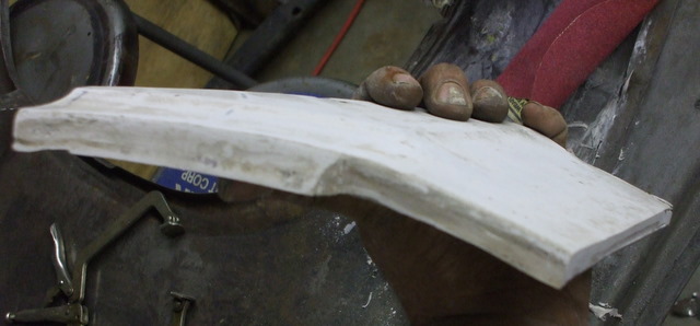

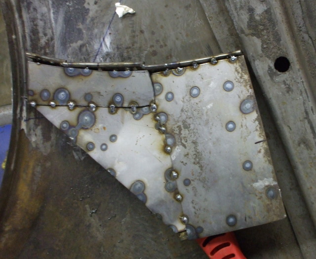

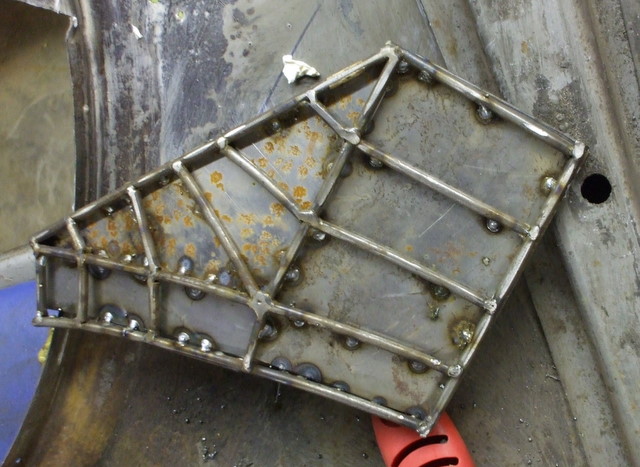

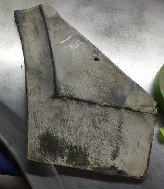

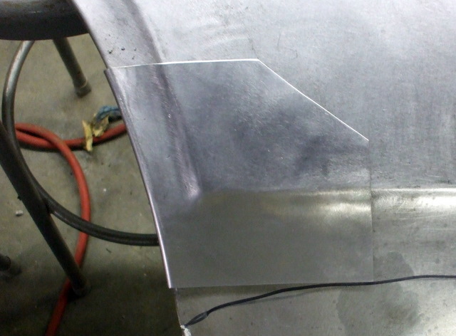

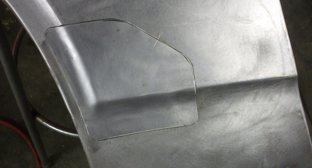

    I had a panel that was a little above my metal shaping skills.
    I thought about it for awhile and was drawing blanks. Then I remembered reading about wire form bondo bucks. On some of the bondo bucks they reinforce it so it can also be used as a hammer form.
    It was the only idea I had so I went for it. Sometimes you have to be creative to get around a lack of knowledge and also a lack of tools.
    This is my first attempt using this method and it seemed to work so I thought I would share it with you guys.
    The tools I used were, Mig welder, small hard rubber mallet, body hammer and some welding clamps. Pretty basic tools.
    On the inside of the fender I made a wire form that was shaped close to the area I wanted to reproduce. This does not have to be perfect the bondo will captcher the shape. Then I topped the wire form with sheet metal. No need for it to be nice it is just there to stop the bondo from coming through and to add additional strength.
    Then I waxed the area where the wire form will be heavily. This is used for a release agent. I mixed up a batch of bondo not using as much hardener as I would normally use. I needed some extra working time. Then I filled the cavity with about a 1/2'' of bondo. Pressed the wire form into the bondo, not all the way I left it up about a 1/8'' from the metal.
    When it dried I tapped it a few times with a rubber mallet and it released.
    Then I clamped a blank to the hammer form and with a body hammer and a rubber mallet, I beat the metal over the hammer form. Pulling it off every once and awhile, When I pulled it off I could see the areas that were hitting and where it still needed more hammering.
    To my surprise the hammer form held up great, not even a crack. I was also surprised on how perfect the piece fit.
    Here it is fitted ready to be welded in.
    I will be using this method again for sure.

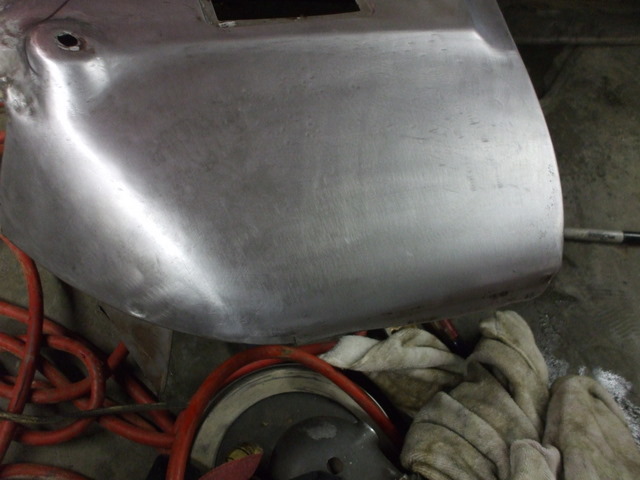

    These count?
    Switch holder,,
    Column drop,,,
    Drop, tach/turn mount and fake shifter rod/wire hider,,
    Horn ****on,,
    Plate light/3rd brakelight,,

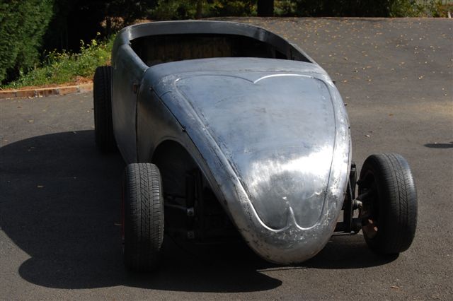

    Here's something O/T I've been working on for a while:
    Everything you see here is scratch built. There's a couple things I'm not happy with, but I started this 2 years ago - my skills are steadily improving.
    I promise to do better next time:D
    I also promise that "next time" will be a project more appropriate for this board. The eagle eyed a**** you will have noticed that this is one of those dreaded vw things
    Since it's all new metal, does that get me off the hook a little?:cool:;)
    Anyway, I like how it turned out, the kids too.
    now if only there wasn't a puddle of oil under it since getting it back yesterday from a complete engine rebuild.......:mad:

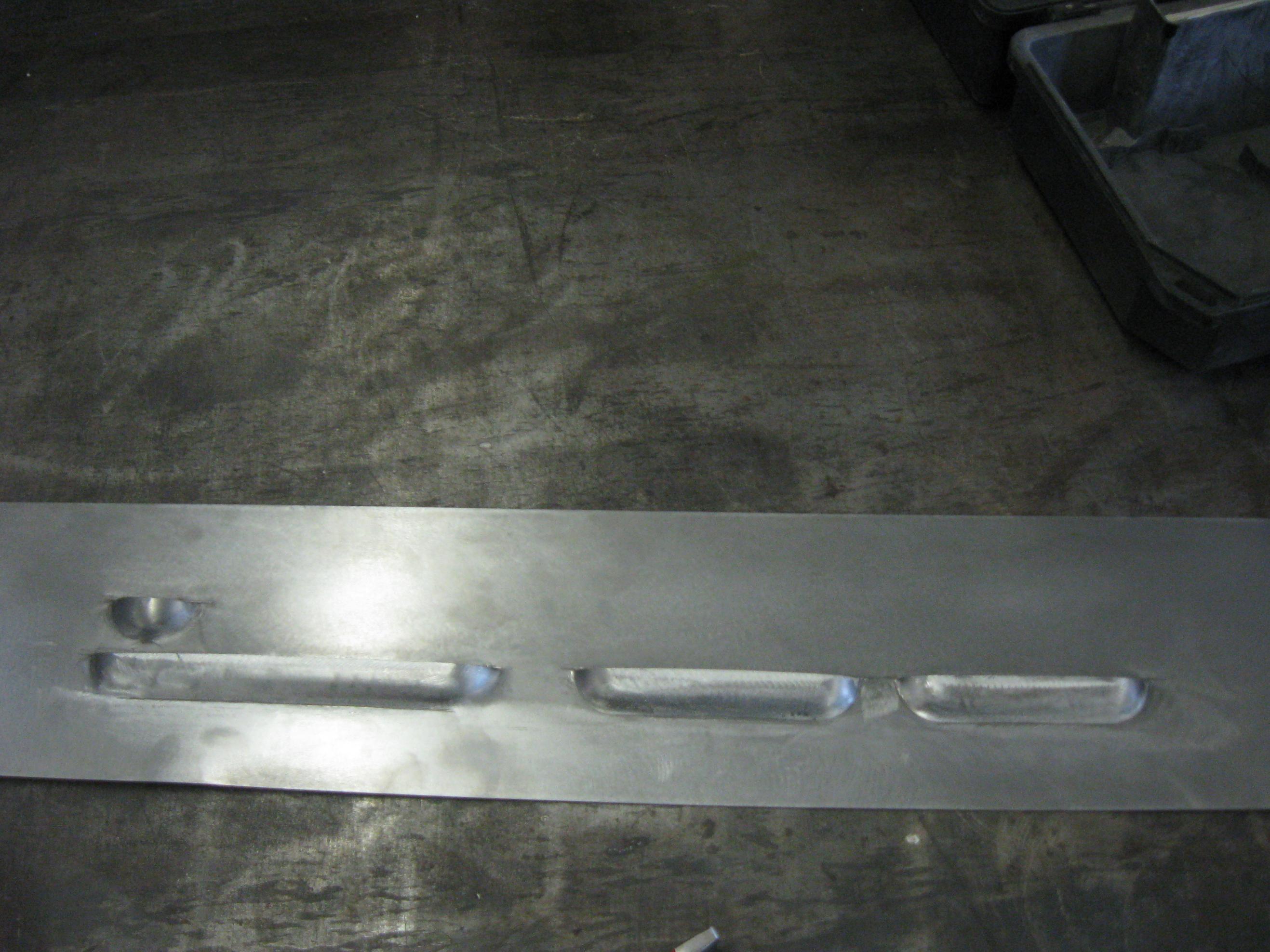

    Setting up pullmax for louvers.
      484.5 KB
      505
      484.7 KB
      486
      484.7 KB
      477
