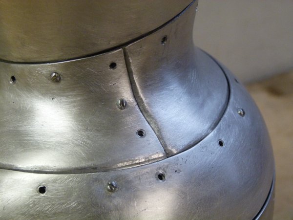

    This project isn't exactly car related, but here's a few pictures I took of a project I took on after I decided to push the envelope a little bit. :)
    This aluminum spiral vase was patterned as an identical duplicate of the red plastic one, and is hand shaped from four aluminum parts, which will be joined together with aircraft rivets securing overlapping seams. I patterned the spiral shape of the ribbons using the black pinstriping seen on the original red plastic vase.
    Shaping the base and the three ribbon sections was a tricky process, because the profile shape of the vase constantly changes as the ribbon spirals its way upwards, so every inch worth of ribbon is a little bit different from anywhere else.
    In the second picture, I used the little metal feelers attached to the vertical threaded rod to measure the the runout of the outer surface as I rotated the vase on the turntable, allowing me to get the shape of the vase true to +/- 1/16" anywhere you spin it.
    I'm almost done the shaping and finishing, and I expect to shoot the countersunk rivets shortly. After that step is done, I can bring out the true beauty of the aluminum with a m***ive polishing job.

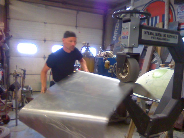

    Had some hands on experience over xmas. Visited a good friend/hotrod builder, to get the last of my bits formed. The gl*** deck lid that came with the 34 coupe shell, was all out of whack, so we decided to form and louver our own steel one.
    My 1st attempt at using an english wheel, we started with a flat sheet. As you know, the 34 lids are curved both ways. Thinking this'll be interesting, away we went. Chris and I on opposite sides of the wheel. Chris did all the guiding, I just got told when to drop my hands. (and when to get the wheel turning). After roughly 1hr, we had formed a nice bulge, which in turn, got pushed out to the edges. All the while checking the form in the deck opening. Once we were happy with the shape, trimmed edges, wheeled them over and recheck fit. Few times in the shrinker and corners welded up. Back in the hole and all fitting nice. Yee Haa, louver time. Punched 205 55mm slots in that thing. You could louver tomatoes with that precision press. (Yep, Chris built the press too)
    Here's a pic of the finished item, and huge ups to Websrodshop, Motueka. NZ
