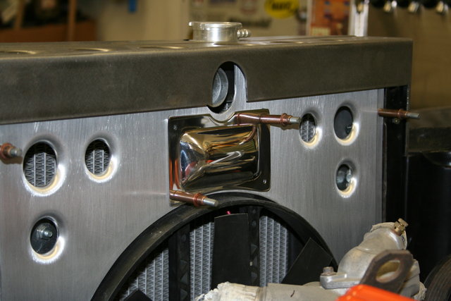

    A blister I hammered out to cover up a plug on my electric fan.

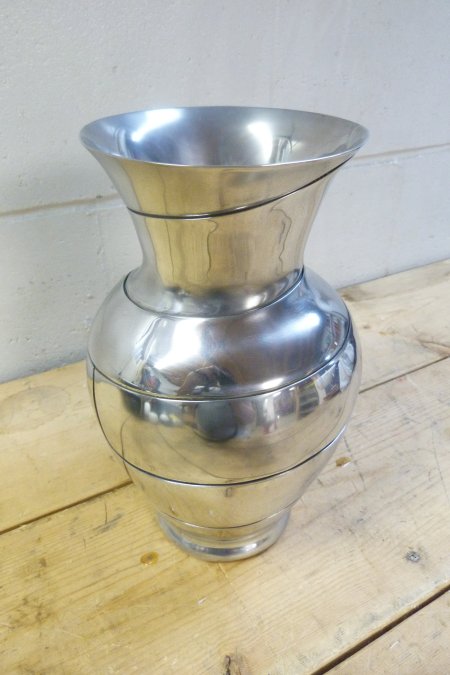

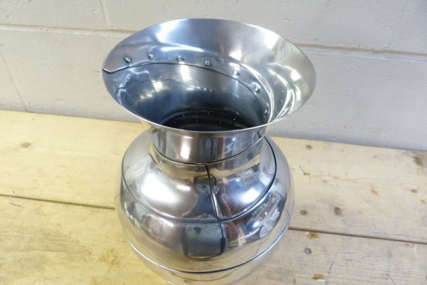

    Finally finished off this one. This vase is constructed out of three ribbon pieces that wrap around the vessel from bottom to top in a long spiral, and are connected together with aircraft rivets.
    I'm usually not easily lured into dainty projects like vases, but the challenge of the shape and construction techniques made this one a worthwhile learning exercise.
